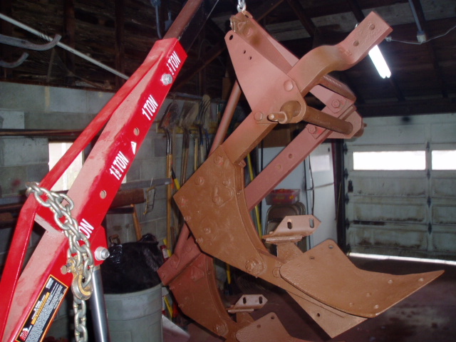

Another day.... and another chance for someone to screw up. I ordered the landslides a day before the shares. Shares show up today. I call (generic mail order house) for a tracking #. (I had them check stock on Jan 2nd when I ordered. They had several. I ordered 2) No tracking #. No shipment. No parts in inventory. Back ordered until Feb 24th. I'm not happy. We'll get back to this later.
Called Massey dealer with part #. He'll have 'em in hand thursday afternoon. With shipping, oem parts were $14 more than "generic" aftermarket. And that aftermarket part still needs some work (with a die grinder) to allow the tail wheel to bolt up correctly.
Call (Generic mail order house) and cancel previous order.
See how much trouble overhauling a simple plow can be?

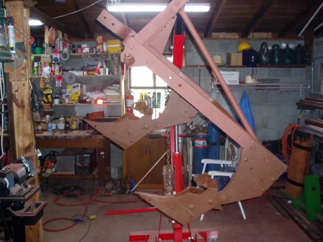

But we did bolt on a few parts. And now the plow is hooked to a tractor.
Pic #1. Looking back from operators seat.
Pic #2. is the bottom without a share.
Pic #3. same bottom WITH a share.
Pic #4. head on look at rear bottom.
Pic #5. Hitched to the 150.
Bolt enough plow parts to anything and soon enough, it starts to look like a plow.

Dear diary.....
You ever have "one of those days"? This was the 3rd one so far this week. And it ain't over yet!
My "generic mail order house" (I'm not mentioning their names while I'm mad) told me yesterday that they put my parts on back order until late Feb. I ordered oem from AGCO. When I get home TODAY, UPS had left 2 landslides FROM THE SAME PEOPLE WHO TOLD ME YESTERDAY THEY DIDN'T HAVE ANY MORE. The AGCO order was UPS red and can't be cancelled. Oh well, spare parts.

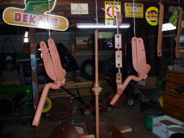

So, off to the shop. I unpackage the landslides, and something IMMEDIATELY stuck out as odd. EVerything was completely BACKWARDS. Now leave it to luck that I just recieved something today that I bought on ebay. A 1972 Massey FErguson dealers "parts interchange" catalog for all their plows from 1957 to 1972. The part # on the landslides I recieved today, in addition to NOT being the part #'s I ordered, are for a LEFT HAND plow. (Maybe left hand portion of a 2-way plow)
I ORDER a certain part. They repeat the correct part #. They BILL me for the correct part #. They SEND me whatever. Here is what I've been sent so far. (Pic#1) The primer brown one at the bottom is a worn landslide like I need. The rest of these things don't even closely resemble "correct". The boys in Iowa have to pay return shipping and a full refund. They don't seem to mind a bit. Maybe that's why plow parts are so expensive these days.
Oh well, shop's cold. The Mrs. wants to go out to eat. No progress today.

Pic#1. This is a coulter,
Pic#2. This is a tailwheel
Pic#3. This is the illusive LANDSLIDE!
The plow is completely assembled. I was beginning to doubt that was going to happen. I managed to pull the tractor outside long enough to take the leaf blower to the shop. Then it started raining. Back inside for now. (We're predicted to be getting 2-1/2 to 3-1/2" of rain between now and Sunday morning. Then it turns cold)
I'll start taking the necessary pictures to support instructions on basic set-up over the weekend. Doubtful we'll be turning sod any time soon.
