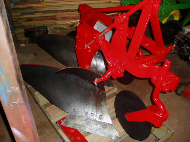

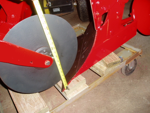

It's about time to hook the plow up to the tractor again. We'll go over some basics on leveling (front/rear and left/right) But a few more things about coulters.
In SOME conditions, and if you have big diameter coulters, you can set them almost to the bottom of the furrow. In most conditions I've ever plowed in, the coulter would serve as a guage wheel of sorts, keeping the plow from full depth. In most conditions, 3" of cut by the coulter is plenty. Also watch for the coulter arms getting close to the ground. They'll tend to catch stalks/weeds/ect

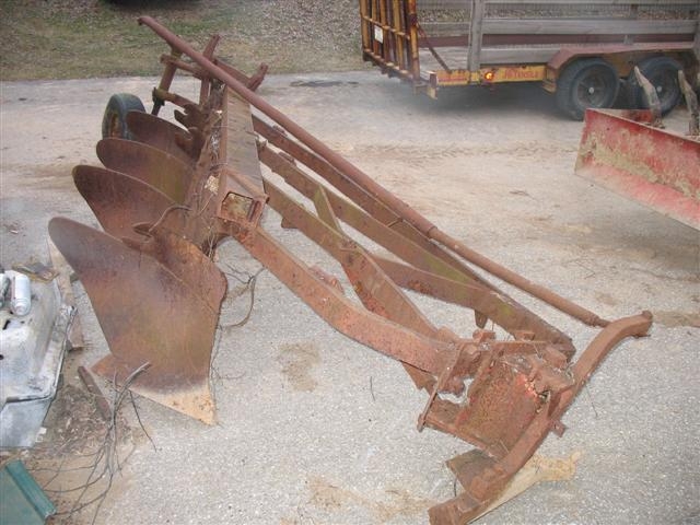

have an old 4 gang plow on the farm that i want to try to use. It is missing the cylinder to raise it but looks otherwise complete. Will I be able to pull it with a 70 hp tractor

see attached pic, will this plow work??

Junk-that plow is beautiful!
7040-i think that plow should work just fine.
   / Plowing new ground. #78
anyone know the purpose of the long treaded rod on the plow. Is this to make alignment adjustments for the rear of the plow?
