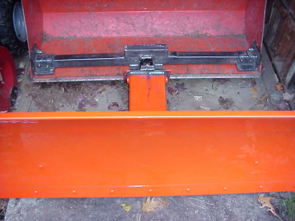

Thomas
Here the set up in the bucket. I Made the frame using a step hitch and 2" square steel. the hitch I cut the bolt hole off and mouted it so it hangs down below the bucket. so when I plow the piece hang below the bucket edge is up against the front edge of the bucket doing all the work.

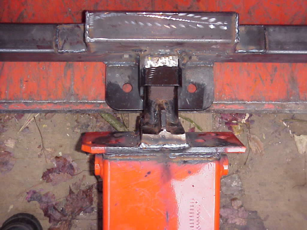

Thomas
Here's a closer view of mounting less the pin.
