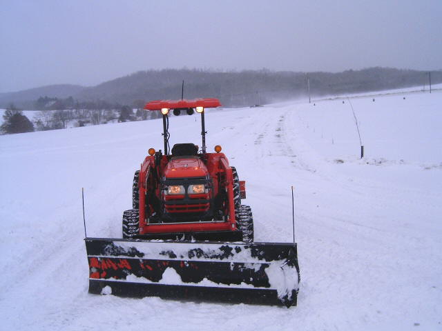

Finally getting snow this past week in my area of Western, Pa.
Bring it on... If its going to be cold anyway we may as well have lots of snow..

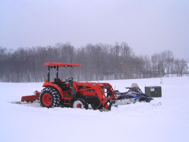

   / Plowing snow in the dark #13
I really enjoy the snow pics. Vince, I am trying to figure out your plowing setup. Do you have a blade on the front of your bucket? The second picture makes it look that way.
   / Plowing snow in the dark #14
I have the skid steer style quick attach. I take the bucket off and hook my front blade on the quick attach..

   / Plowing snow in the dark #15
I'm running a 7' blade on the front and a 7' blade on the rear.
I use the rear blade to pull the snow in away from the road so I don't have to drive out on it (fairly busy road). Then I use the front blade for the plowing.

   / Plowing snow in the dark #16
Vince,
Does this setup when angled push the front end sideways very much or does the tractor weigh enough to stop that?

   / Plowing snow in the dark #17
That's a nice setup Vince. Is your FEL blade homemade or a commercial unit? If comm. who makes? Been exploring the front blade option myself.

   / Plowing snow in the dark #20
Steve_Miller said:
Vince,
Light fluffy snow is no problem at all.
Wet heavy snow will try to shove the front end around on occasion.
I still much prefer plowing with a front blade vs a rear blade. I can move more snow faster and easier with a front blade.
