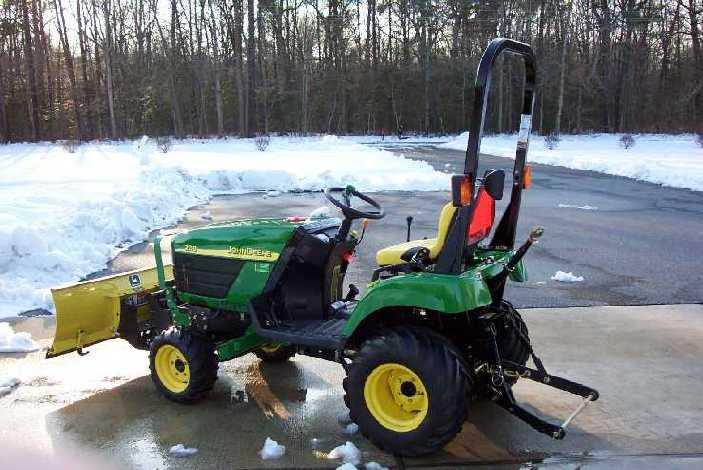

A dozer is a dozer, and a CUT with a front blade is a snow-eatin' machine.
Don't expect much else/more out of a front blade beyond snow, but if you want to move snow, get a 4-way hydraulic front blade a few inches wider than your rear tire track. Sure, you will need your loader when you get more than 2-1/2 to 3 feet, but my 2210 thrived in the 18-20" we had 10 days ago. A common mistake is to add too much weight off the back of a MFWD CUT. Loaded tires or wheel weights are great, but try to avoid the "lever" effect by hanging weight off the 3-PH, effectivey reducing the weight on the front axle which equals poor front wheel traction and "ruddering" steering.
You can economize with a rear blade and get by, and you can do it all (in 5x time) with an FEL. But MFWD with a hydraulic front blade is a time saver for us economic mortals and a money maker for the pros.
It's all about $$$. By the time you set up a CUT to plow with a front blade, you are looking at $700-$1,000, approximately. Once you plow snow with it, you won't look back...especially if next winter is anything like this winter.
This is just conjecture, and a conversation starter, but I think the smaller CUTS and sub-compacts are better suited for a front blade. Tight turning and quick response really make snow plowing fun with the small and middle sized tractors.
The rubber edge "squeegee" is a must on asphalt or concrete. Buy the cow mat, or a manufacturer's part and sandwich it between the cutting edge and the moldboard (of course you'll have to buy longer cutting edge bolts for winter). On pavement in float, your skids should be set at 1/2" to 3/4" above the paved surface. The rubber edge accommodates all of the cracks, lips, and surface inconsistencies.

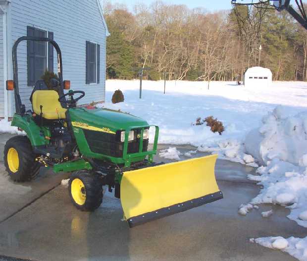

Blade right front
