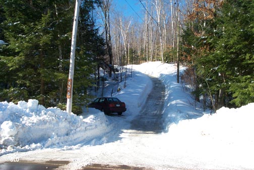

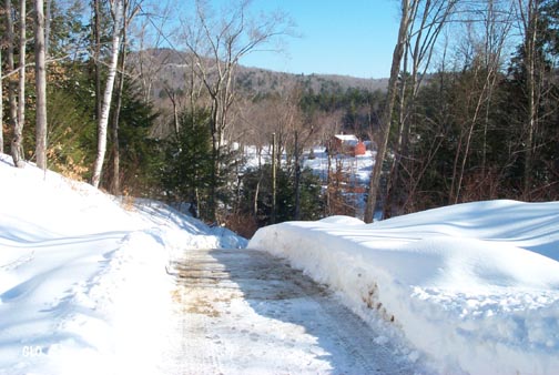

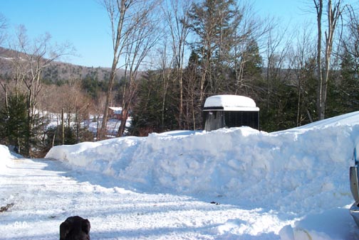

Thanks to everybody for their advice and suggestions. My present work situation usually makes it a bad situation when I arrive home. My job keeps me away for 3 days at a clip. I'm often faced with a mountain in front of the driveway 4'tall (**** wing plows!) and a 16" accumulation up the mountain side. So I have to trudge up the hillside and work it from the top down (nothing I've seen has been able to go bottom up!). The second factor is that no matter how far I push the snow to the side, by Feb. there is no place for it to go! I'm not alone as sooner or later everybody up here needs a FEL to drop by and move the stuff.
Like I said the tractor pretty much tapped me out. That being the case if my tractor starts and functions I'll be that much ahaead of the game. The olde plowgirl needed a 1/2 can of ether followed by a gasoline chaser to get her running. Took me longer to fire it up than do the plowing. It did have heat and an AM radio however, I'll miss the carbon monoxide poisoning (no exhaust).
Also I forgot to add by FEL is wider than the tractor 7FT.
Once again thanks for the advice...attached are some photos so you can tell me how good I have it!

Wow! You're really going to need a blower if that is what it looks like in August /forums/images/graemlins/laugh.gif Can't imagine what it must be like in February.
Nice looking property.
