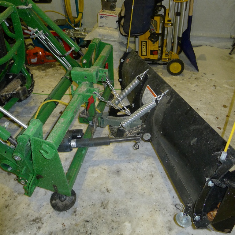

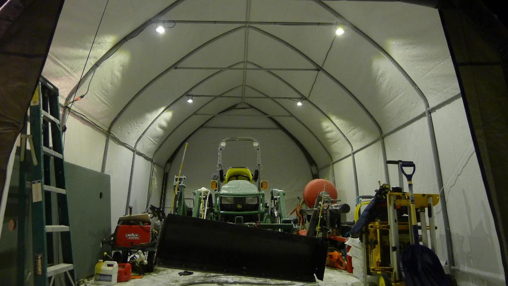

Nice video ,nice place , nice tractor . I really like your tractor shed , what is it ? You have some nice mods to your tractor . Counterweight with sleeve hitch , flasher protection , you do nice work . What is hanging off the right floorboard ?

Should be the plugs for the hydraulic lines. They are color coded.
   / Plowing some powder with the 1026R #14
rockshaft it looks like a yellow extension cord running up to the angling actuator
where did you mount the base of the actuator? can't really see from the pictures,
but it looks like maybe on that brass colored steel rod going between the bucket mount paddles?
nice video!
nice video!
Yes, JD Yellow HD extension cord for FEL accessory control.
The base of the actuator is on a bracket attached to the FEL multi-mount and plow base plate.
Maybe this pic shows a little better. Its not pretty, as I can't paint all the bare metal parts until the summer when it warms enough.
The shed is a Shelter Logic garage-in-a-box, its the SUV model that has a tall door.
