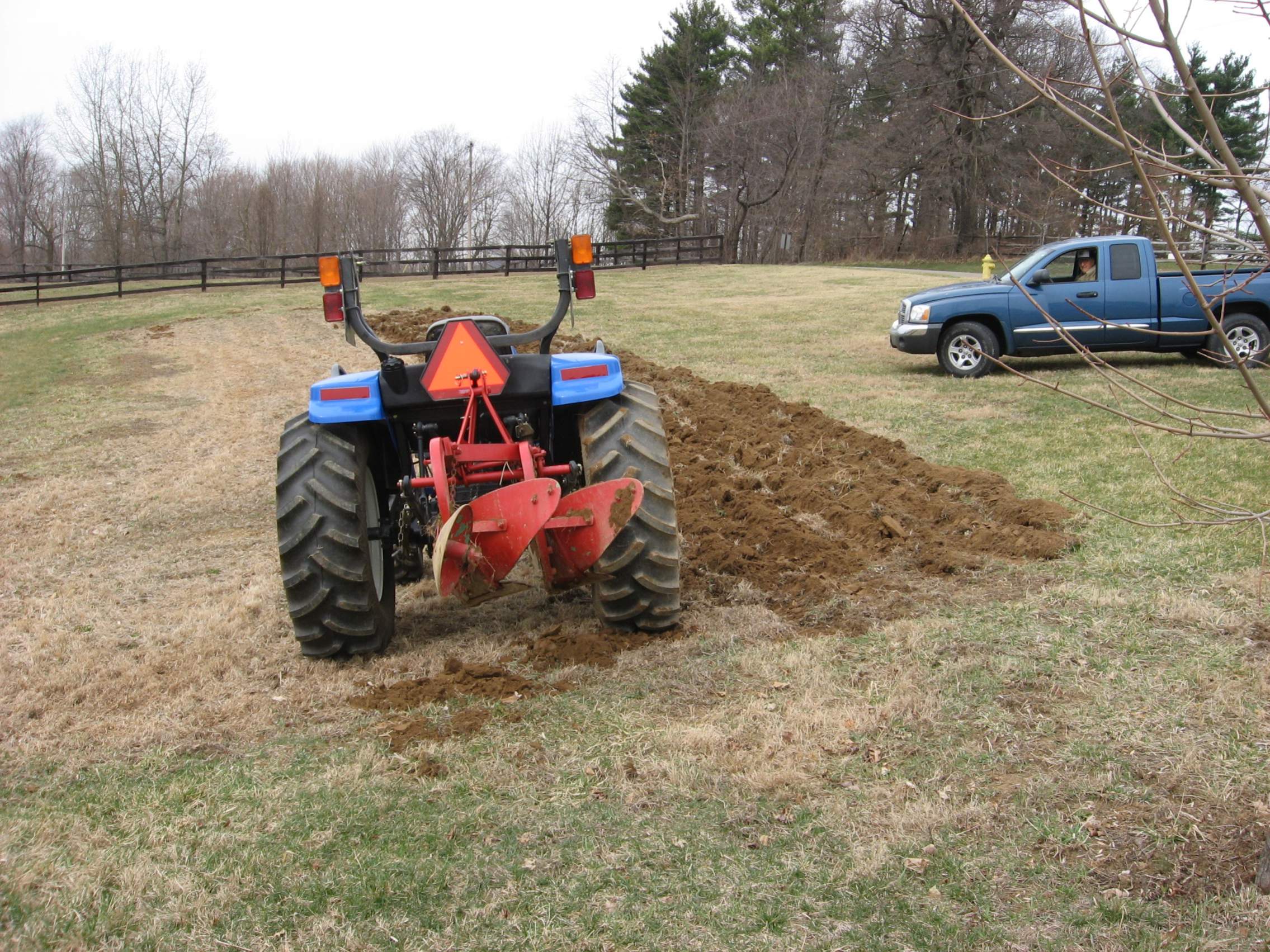

My Tc45a pulled this 12" 2 bottom plow with zero resistance in 2wd mode. I know it could pull a 3 bottom 14-16" without any problem whatsoever in harder ground. Granted, the garden in the picture had been plowed 2 years earlier so it's a a little softer but the tractor literally felt like it was cutting snow. I wish I looked at the rpm's but it was low. No tire slippage with the ag tires.
I think I ran medium range 2nd gear.
As Jinman mentioned gear tractors with ag tires do a much better job of pulling a plow. I think you lose lot's of torque with the "slush box" tractors.
That is a beautiful sight :) I can almost smell that freshly turned soil. Ken Sweet
