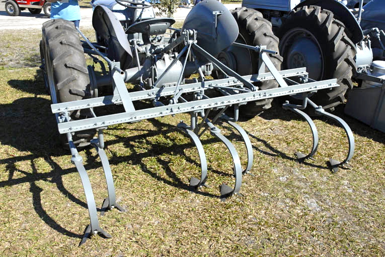

Are the very old (antique) Ferguson cultivators useful any more? Or just lawn ornaments?
   / plows vs cultivators #12
Ferguson used top quality materials and field tested his implements exhaustively. If you can find a Ferguson implement in good condition after all these years, grab it.
The Field Cultivator referenced by Ken Sweet in Post #9 is a copy of the original Ferguson implement, which Ferguson called a "tiller" and Ford/Dearborn called a "Field Cultivator". Designed and first built by Ferguson about 1934.
Ferguson CULTIVATORS are a bit different; see photo.
Ken Sweet occasionally offers original, old, Ferguson Cultivators.

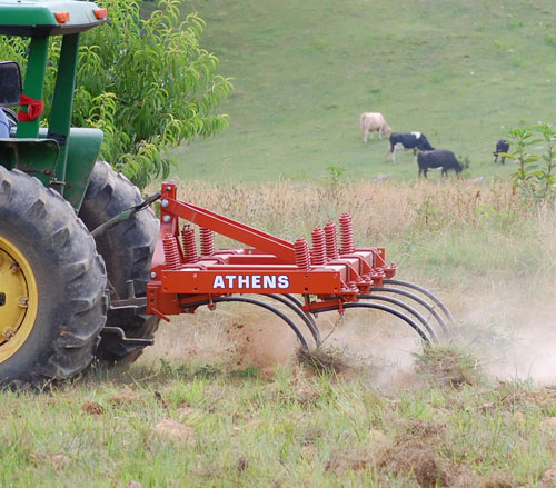

Most everyone I know uses chisel plows and they haven't even been mentioned in this thread. They do a much better job of fracturing the soil to stimulate root growth with less chance of erosion.
   / plows vs cultivators #18
You are correct, However, they do require a little more hp. We guesstimate around 15 hp per shank, depending on the soil type and how deep you need to go. Ken Sweet
http://i.ebayimg.com/images/g/U1oAAOxyLN9SkONu/s-l1600.jpg
