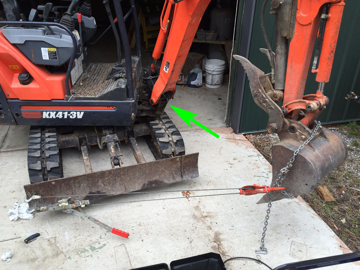

Clean out the bore. Pack the far end with paraffin wax using a pin punch. Pump grease through the near end. Heat to remove the wax.
   / Plugged grease passageway
#22
I was trying to think of a way to do exactly THAT, like a plug on a string, etc. Never got the idea of a melt-able plug. Brad, that's BRILLIANT! I would have done that! Except I had success today using pre-internet methods.
I took the zerk out and it's a 3/8" grease passageway, bigger than I expected. Plenty of room for wire, so I poked around until I found the hole. Couldn't poke out to the bush with just a 3/8 hook, but did all I could. But it told me where the hole is, so I started this plan to load up the boom to plug the other side.
Loading up the open side by positioning the boom will certainly help. Ran heavy equipment for a long time but a good trick evades me right now.
I used a come-a-long to load up the joint to cover the other hole (hopefully plugging it) while lifting the bush off the plugged hole. Here's the pic.

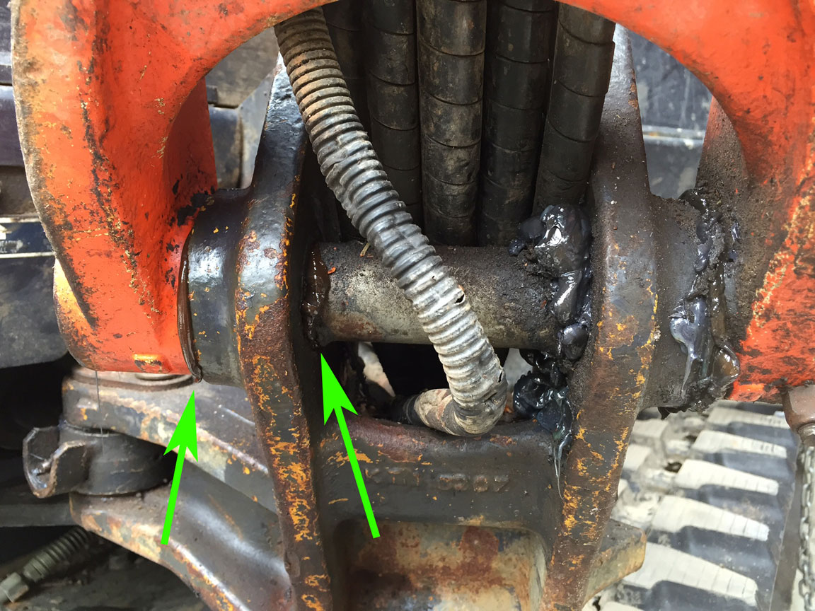

Pumped again and it was really hard pumping, only a little coming out the other side. Whereas before it gushed out the other side. So I knew this was going to work ,,,,,, :cool2: and POW! VICTORY! :cool2:
Rusty grease pumping out of the dry pivot!
417096d1426654030-plugged-grease-passageway-kx41boompivot4-jpg
Thanks for all the ideas. Glad I didn't have to take that pin out.

Brandi I knew what tool you were referring to but that tool wouldn't work because the passageway has two outlets. It would have been useful in the 2nd phase (after plugging the far side outlet) but luckily the grease gun was able to produce the pressure to clear the blockage.
Now that I know the 'direction' of the grease passageways, if I dont notice grease out of both sides I can put the bucket on the ground and load up the boom as you mentioned.
