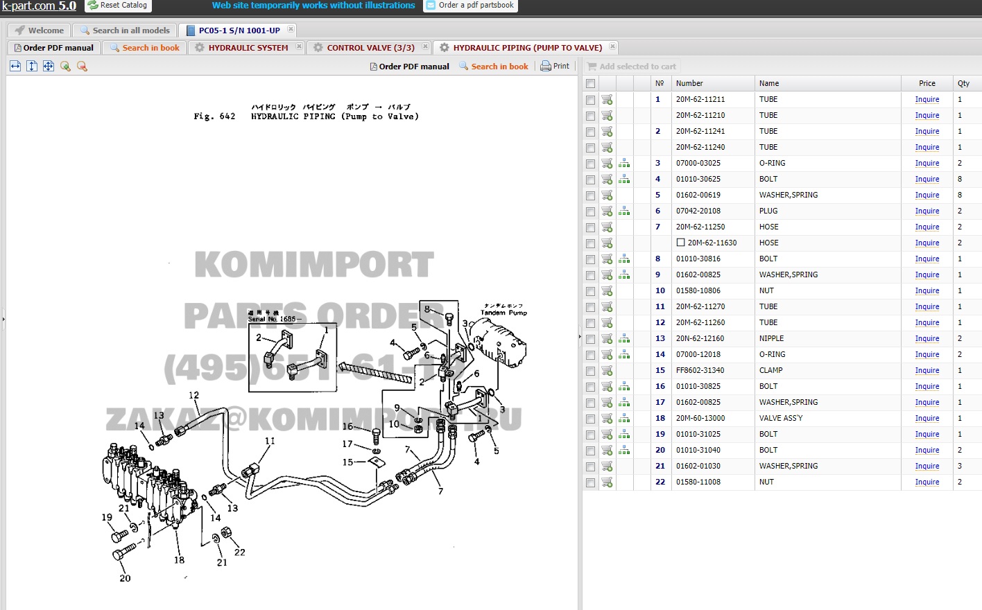

Does this make any sense to you? If you could find a serial number, so I could make sure I'm looking at the right stuff on that Russian website.
Diagram pump to valve:
Diagram Valve to Tank:
We need to confirm if the thumb valve have the Power Beyond port and the power beyond adapter for it. If it does have that, the easiest way then, is to use the pressure line of one of the pumps to feed the thumb valve. Then the thumb valve will feed the main valve through the Power beyond port with the power beyond adapter/sleeve installed. The tank line of the thumb valve, will then Tee into the original tank line.
Another solution, is to ditch completely the thumb valve. Instead, you would use a diverter valve hooked to the swing cylinder circuit (since it's not used that frequently) and use that instead.
Either way, you'll need a secondary relief valve for the thumb cylinder, on the extend port of the cylinder.

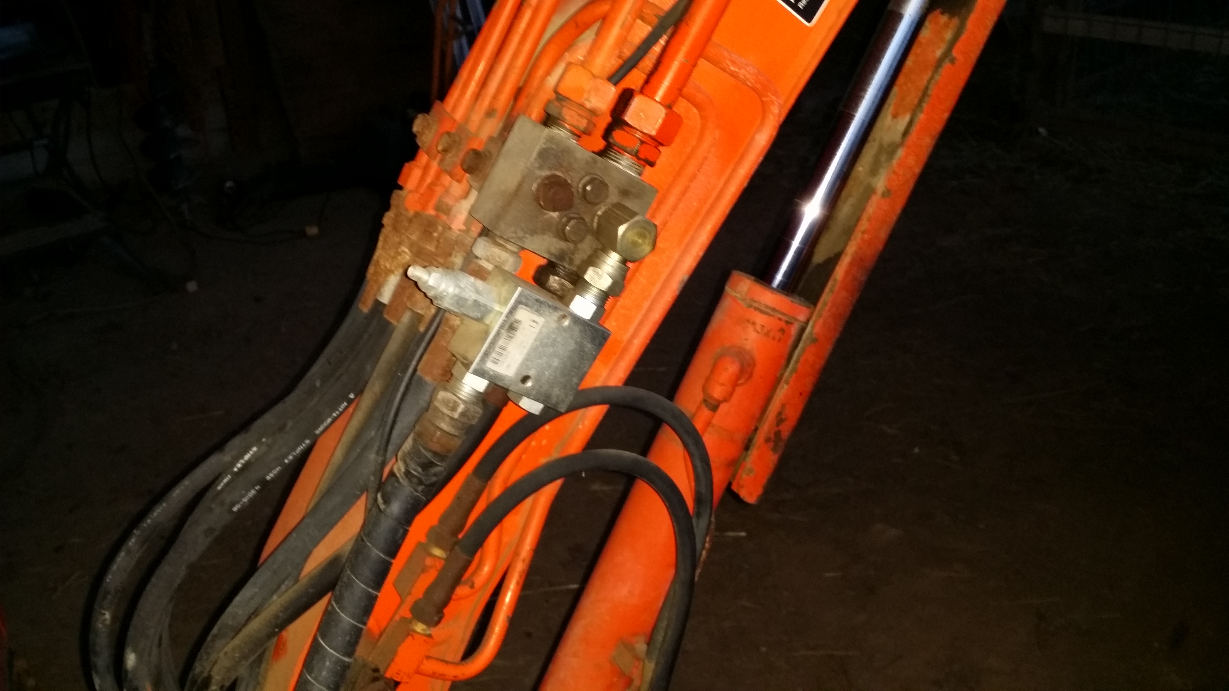

A relief valve P-T-P (pressure- tank-pressure, no check valve, only relief) could be plumbed in series into either cylinder port.
On the second picture you see a connector block with plugs where the hoses connect to the pipes. I took out one of the plugs and plumbed in the relief valve. The hose on the relief valve goes to tank.
Had the block not been there, then I would have plumbed the relief valve in series where the hose connects to the pipe. It doesn't make a difference if the relief valve is in the extend or retract line, because the pressure is equal on both ports. Only the flow is opposite for extend or retract.

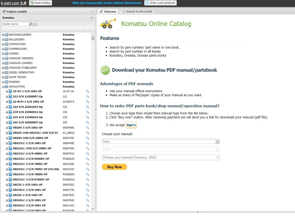

I've had luck finding both parts and figuring out problems using the parts lookup from this site-> Запчасти Komatsu, бесплатный каталог, Цены online
Edit: I just checked and it does have pc05 diagrams. I couldn't find the anything about the thumb but all the control valve and line stuff is there to look at and it may help?
The web page I get only allows me to order shop manual or parts manual, at $99 each, for just about any Komatsu made. How did you get to look up parts without buying the parts book?
   / Plumbing excavator thumb #17
Choose from the list on the left:
Scroll down till the PC5 shows up. I happen to choose the first one as it was the earlier ones and I didn't know the serial number.

Thank you Takman - I found the site and was able to look at some information, and decided to purchase the repair manual they showed for $99.00 U.S. I ordered, paid via PayPal, and a day later got the money credited back. Apparently they didn't have the manual. I had to sign up with an email, name, and password to order. Now, I can't even look at the site without logging in, and can no longer look at the list on the left side. The directions say I must now subscribe for $99 PER MONTH! It was good while it lasted, and I do appreciate your taking the time to help me. The PC05? With what I was able to glean before the site went pay-to-look, help from you and others on this board, and many hours on line, I have the thumb problem figured out and parts coming to get it working correctly. Some day I'll go to the library or somewhere with a different web address and see if I can peek at some of those pages again.
