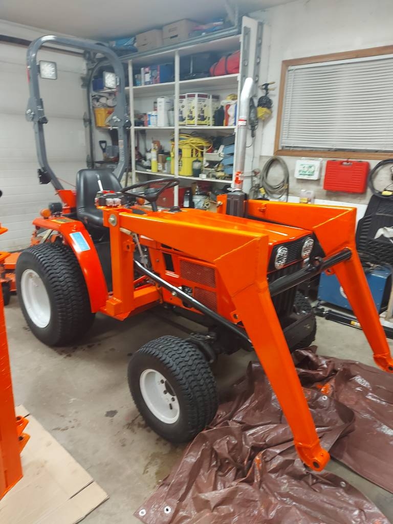

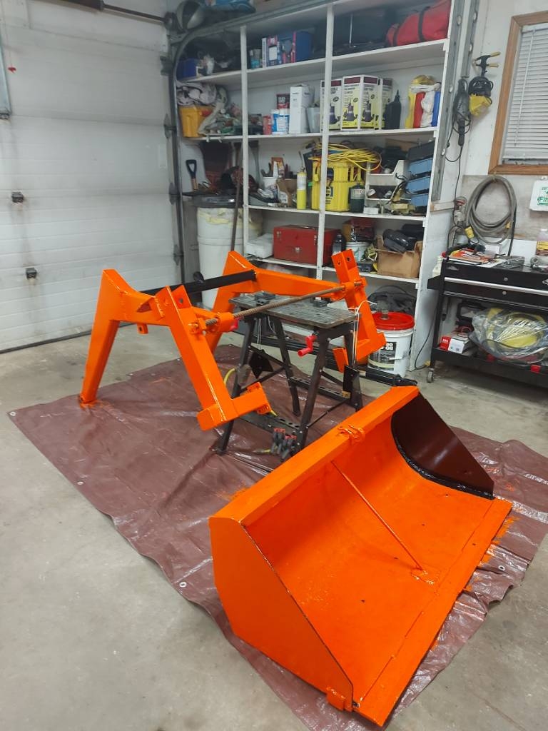

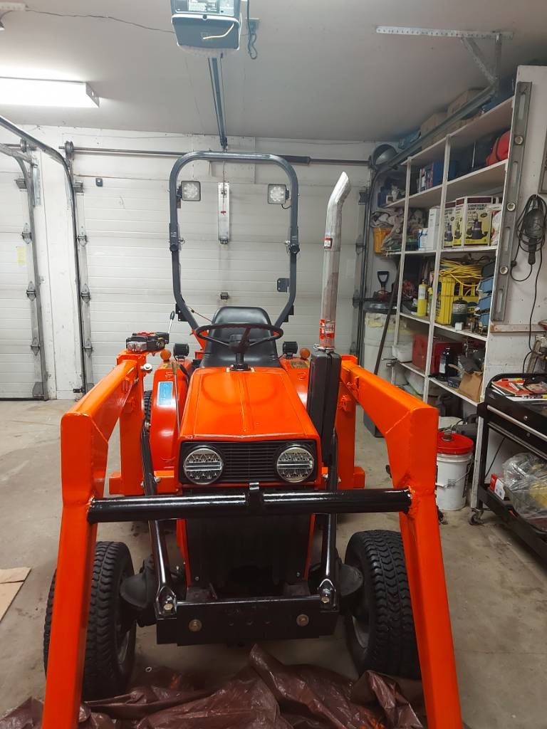

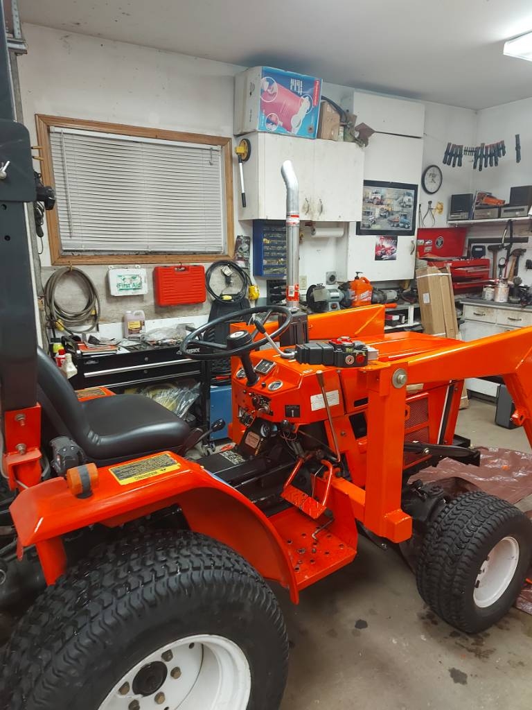

Hi all,see attached picks of my project loader,just waiting for my hydraulic fittings to arrive,I think it turned out well,Greg
   / Plumbing hydrolics for an Allis Chalmers 5015 #14
Do you have any more pictures of your finished product? Love to see it! I recently went and bought a loader from a salvage unit for mine. Lines are being made now, cylinders and valve is being rebuilt. Looking to see where you plumbed the lines in on yours.
