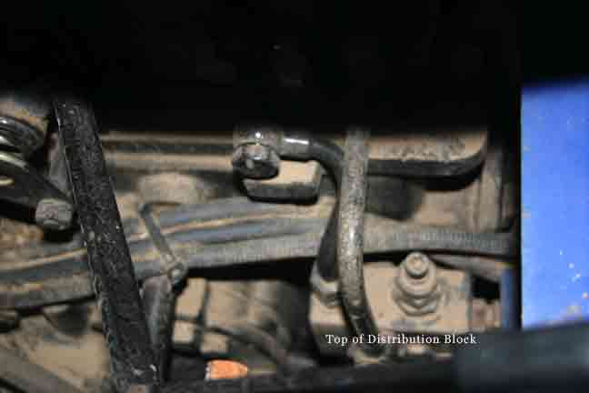

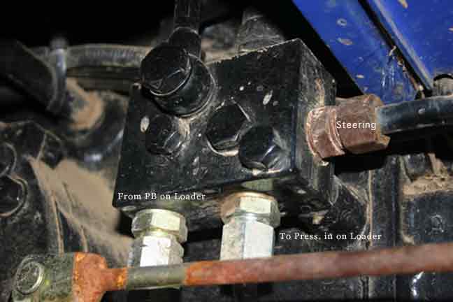

/ Plumbing question
Kenny,
Thanks for the info. That starts to make some more sense. That is why there are two lines going into the top of the distribution block. One is feeding the oil and the other is taking the oil from the PB to the 3ph. That also means I need to look at the valve controlling the post driver. I wanted to use this as an excuse to 2 spool valve in back to hook up a TnT. I was going to use the PB from that valve to connect the post driver. If that valve does not have a PB then I can't get the 3ph to work with the post driver connected. I will try posting some pictures tomorrow evening or Friday.

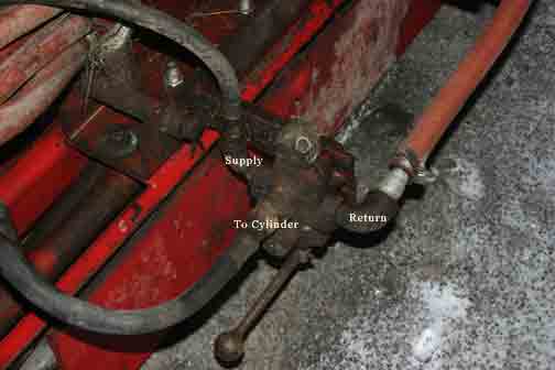

Here are some picture. The first picture is the distribution block showing the line to the PS, Loader in, from PB on Loader. The second picture is the top of the distribution block. You can see the line that connects to the top of the block and the one that connects on the side. One of these must feed the oil and the other is going to the 3PH from the PB from the loader. The third picture is of the valve on the post driver. That looks like it only has an in, work port and the return. My thoughts were to disconnect the line going into the distribution block from the loader's PB port. I would connect that to a two spool valve on the back to prepare for a TnT. I was then going to have the PB from that valve go to the post driver. The problem with that is that the return has to go directly to the sump so then I have no supply to the 3PH. I am thinking I need a diverter valve before the post driver to either feed the post driver or the 3PH. Does anyone have a way to do this with out the diverter valve? Do the more expensive tractors have more than just the one hydraulic supply?

/ Plumbing question #9
Erick,
Your plan to add the new 2 spool valve is a good one, and I will not go into detial now on that... But I have a different idea for you post driver:
Once you get the new installed and working, I would just connect the driver's valve IN port to one of the spools with a QD (quick disconnect), just like you are plugging in a cylinder. Then you can either bungee the handle for that spool open-or better yet get a spool with a detent (not float) so the handle will stay open by itself.
With me so far?
Now for the RTT (return to tank), as you stated-you need a unrestricted flow so the hammer can fall quickly. You could a a Tee into the return line from the FEL valve and use a large QD...Or some have even made a new cap for their sump (where you add the fluid) with a large hose barb fitting so the return just dumps into the tank through the fill tube/hole.
This way you do not loose 3PH control, and the return is as unrestricted as possible. Also no dverter is needed so the plumbing is simpler.
