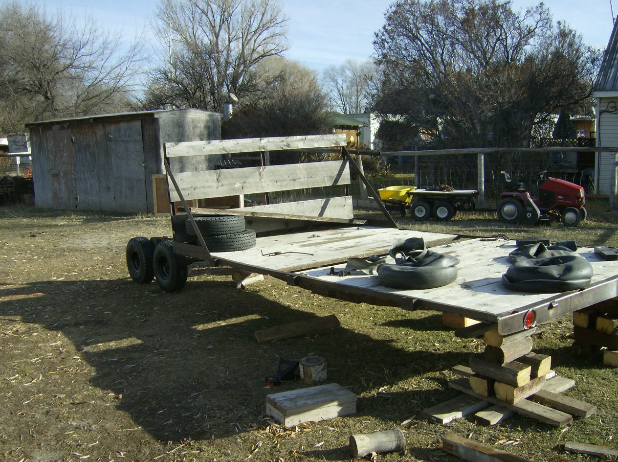

I finally took some pictures. She's ugly, but she's done what I've needed so far.
The first picture is of the trailer as it sits today up on blocks waiting for the wheels. You can see that I have one of the deck planks removed from when I was cutting the bolts out.

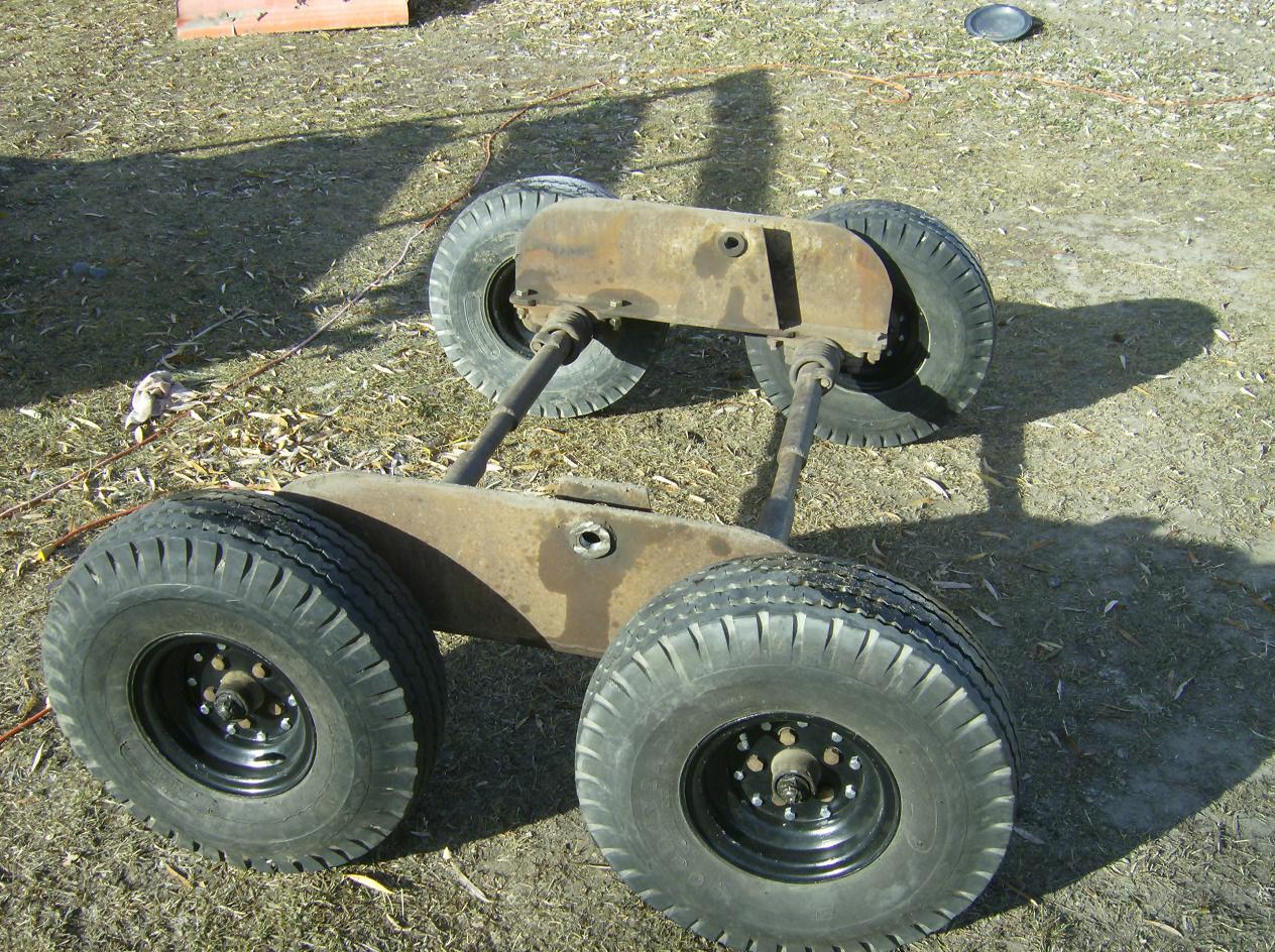

The second picture is of what I have been calling the axle carriage. What is the right name for this assembly anyway?

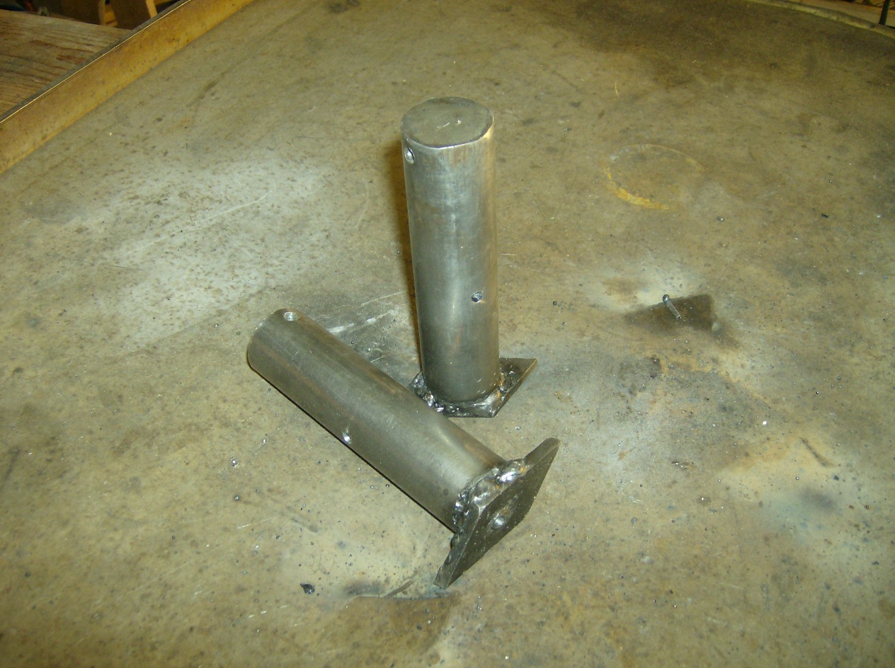

The third picture is of the pins that I fabricated to replace the bolts I had to cut out. I've drilled a hole halfway down through the center and another hole out the side so that I can tap and thread a grease zerk in. I've got a couple of zerks with 1/8" NPT threads, but the tap drill size charts say I need a "R" size bit. What's an R bit?

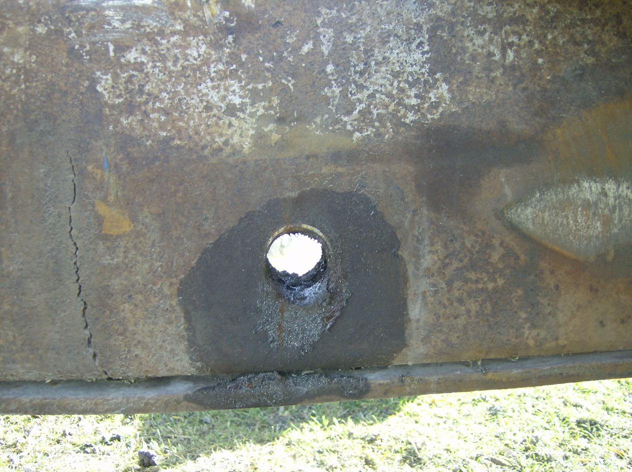

The fourth picture is of the hole in the trailer frame that the bolt has to go through. You can see that the hole has elongated a bit over the years. That crack in the left side of the picture has been welded from the back and there's a plate welded on the bottom.
Your 2nd photo is sometimes called a "truck", but "axle carriage" works.
An R drill bit is a "letter drill" and is 0.339". A 21/64 fractional bit will prob be
close enough. An NPT tap has quite a taper to it.
Good luck w/ your project.

interesting project. This oughta keep you busy for awhile and out of trouble.;)
in the last picture you posted, I am concerned seeing a crack that large in the frame. Can you elaborate on that crack, any plans to fix it ?
