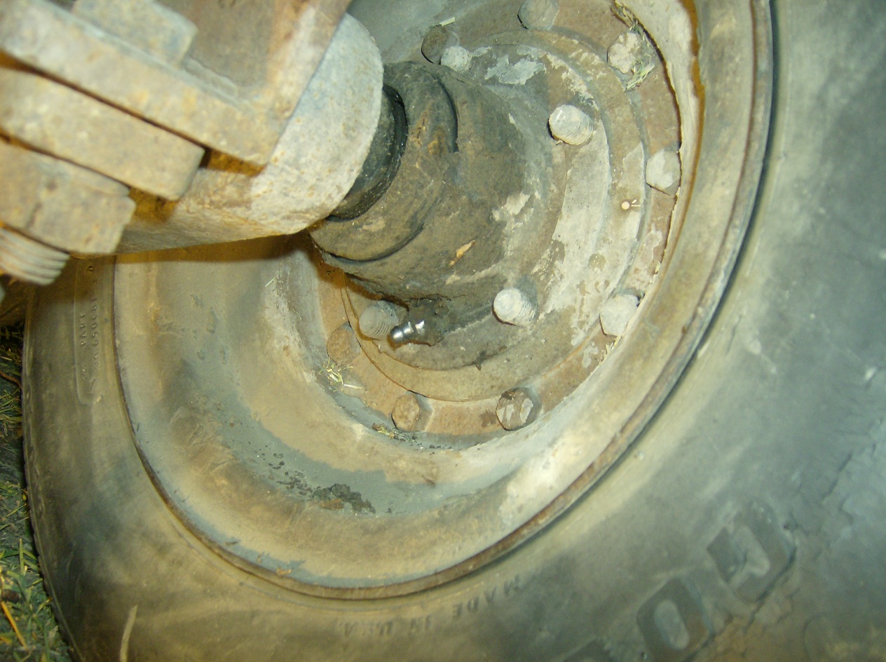

Do you know how to knock off the bearing cap? That cup like deal in the center of the hub. If you take it off and then give the grease fitting a couple full squirts and see grease moving in the hub, you are probably ok without a packing.

:confused::confused:Now I'm really confused. I can't recall every seeing or hearing of a grease zerk on the back side of a hub.:confused: On vehicles with hydraulic brakes, I've had people ask if the little bleeder screw was a grease zerk, but I'd really like to see what we're talking about here.
Ask and you shall receive...
Also, I followed John Bud's advice and pumped grease into the zerk. The seal started moving out. That can't be good.
It should be ok. Actually, fairly good. The seal moved out because the grease is cold and thick. Just bring the grease gun with a full tube of grease and if any hubs get warm, give a squirt.
I was more concerned about the visible weather checks on the tire in the picture. They look a lot like my little trailer's tires.
If you are only pulling 3500 and the state doesn't have a regulation about mandatory brakes, you should be good to go. But as you know, give yourself 2x the space to stop.
With all this mental prep, you will probably be let down by the boring drive with no burning hubs, blown tires, exploding retreds, etc.
You'd be even more concerned about the total lack of tread. I am definately getting new tires.
I know there's a lot of things in this old world I haven't seen yet, but that sure a new one to me. And I thought I'd seen about every kind of trailer hub and axle there is.:D
