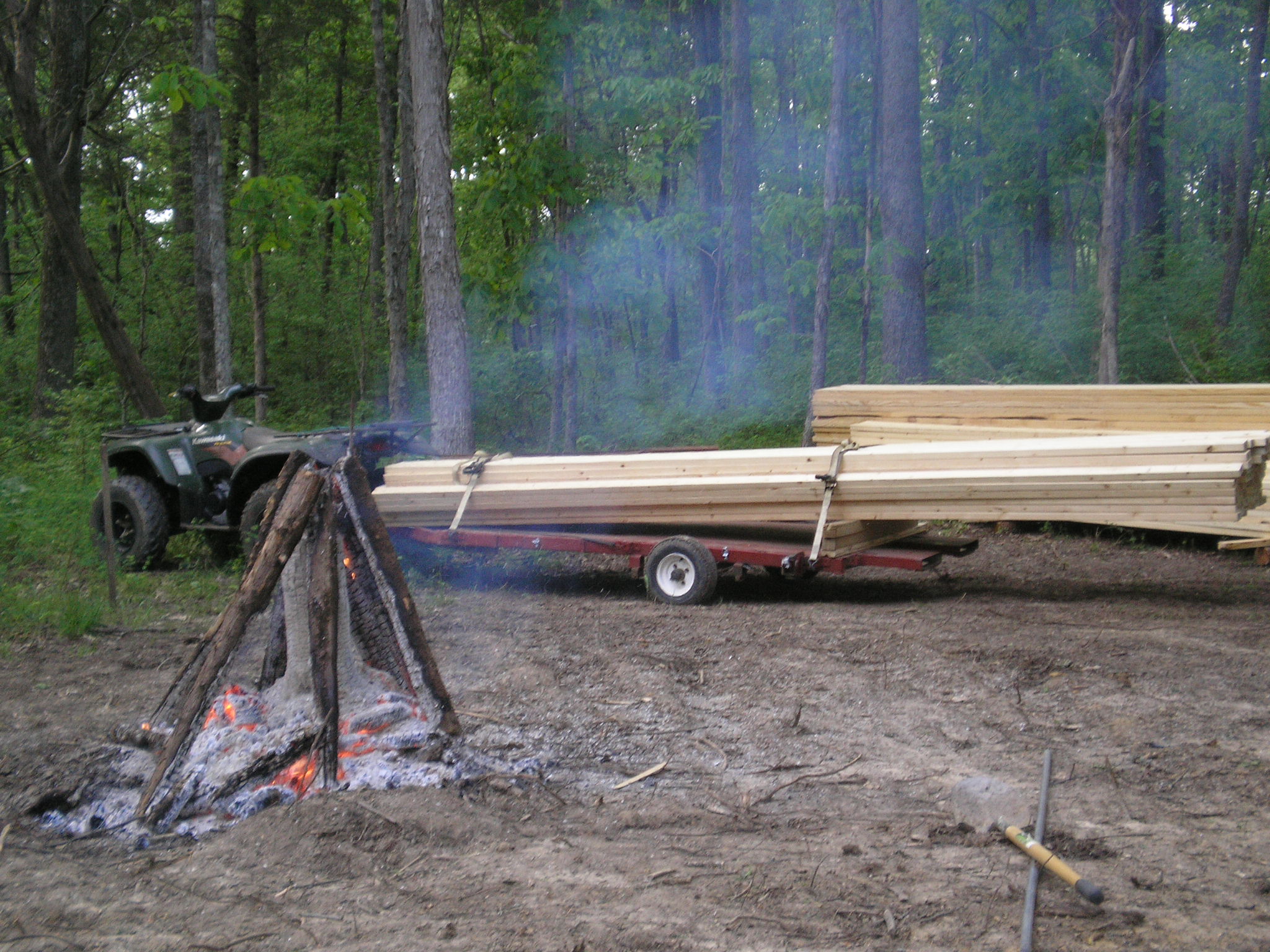

I have been planning this building for a little while and now the time has come. My wife and I have taken a week off of work and although we don't expect to get it done in that time, we should be able to get a good start with some help.
We received the trusses yesterday, 40' wide with 2' OH on each end so a total of 44' wide. Today, we received the rest of the lumber. We spent most of the day just moving the lumber up to the building site with our 4 wheeler and a small trailer. I plan to post as much as I can with pictures and updates as long as the community shows interest.
Thanks for reading!
