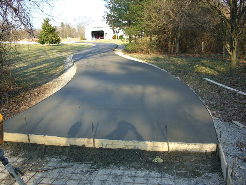

Geez Dargo. that's a nice driveway. I'm thinking yours is the place to go when the bomb hits.
