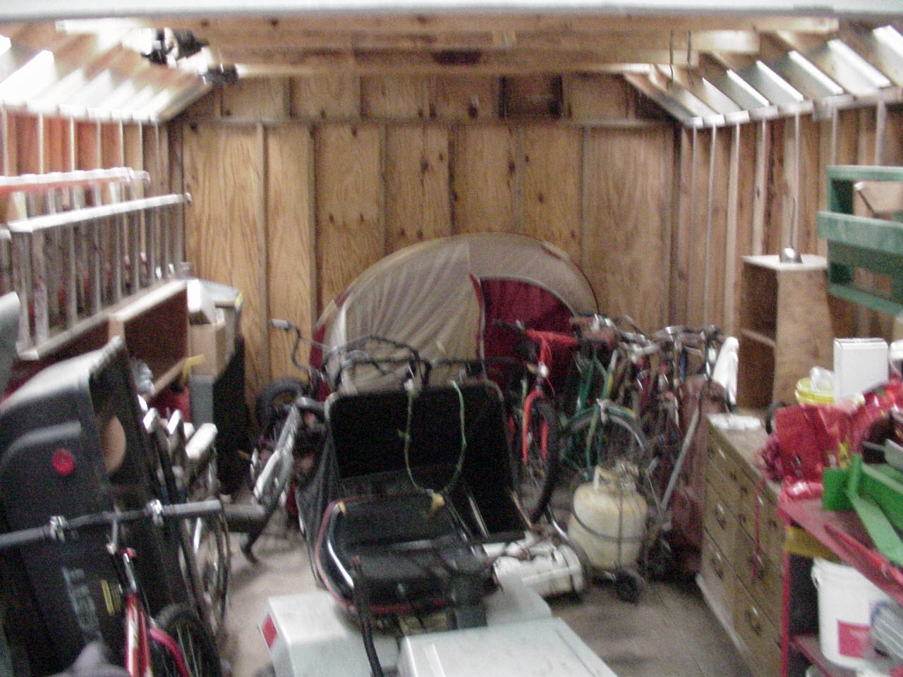

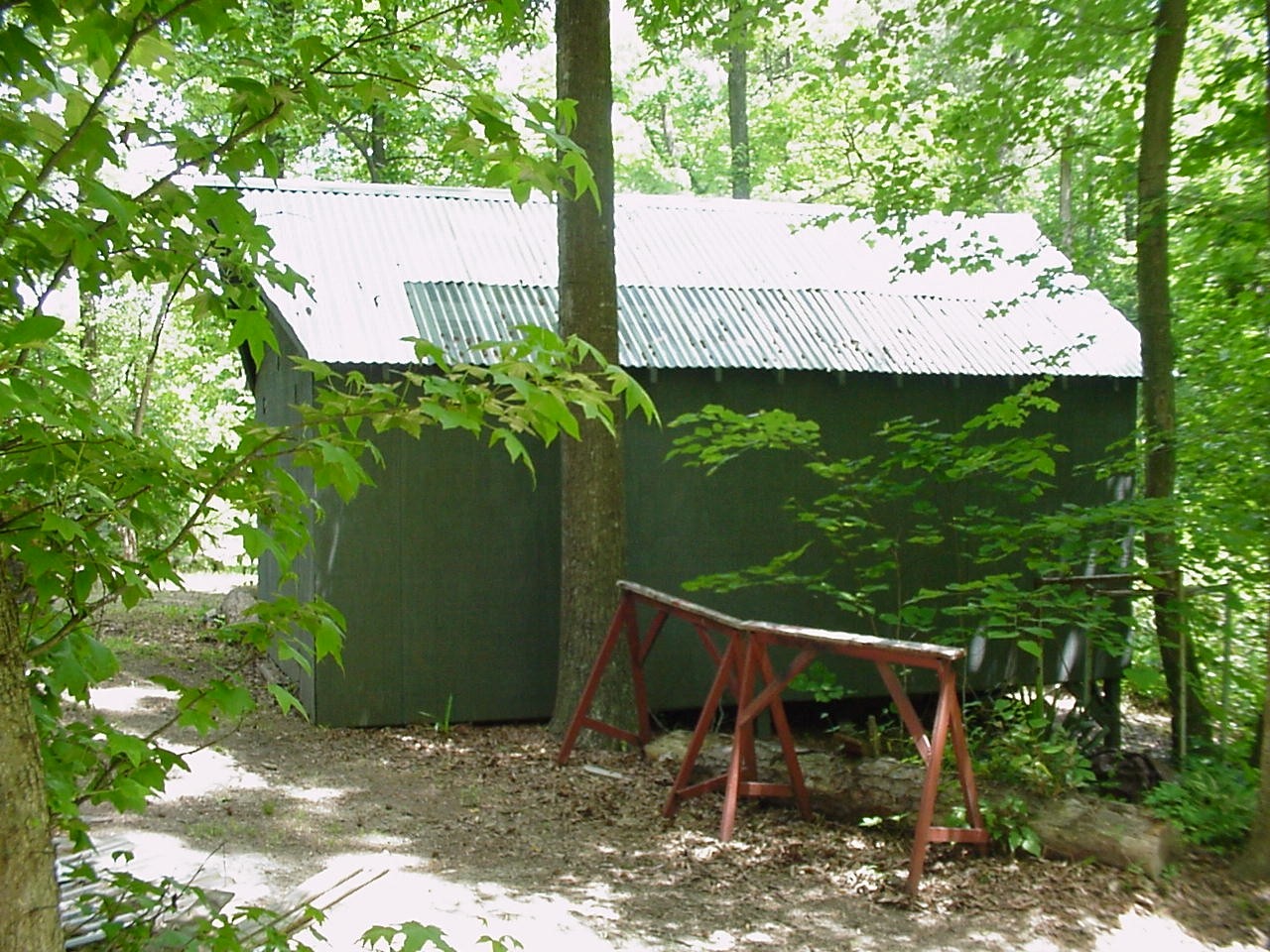

/ Pole Barn Eave Lighting - Clear or Translucent White #5
When I built our little storage shed about 10 years ago, I also left a 2' section along each side of the roof where I used the clear roofing panels from Lowes. They matched the corrugations from the metal roofing I used and were an easy addition. I was apprehensive about using them, thinking they would not hold up well and end up cracking with age.
However, so far they have no problems, and while a little stained from tree sap and dust provide much needed daytime lighting in a building without any electricity or other lighting.
