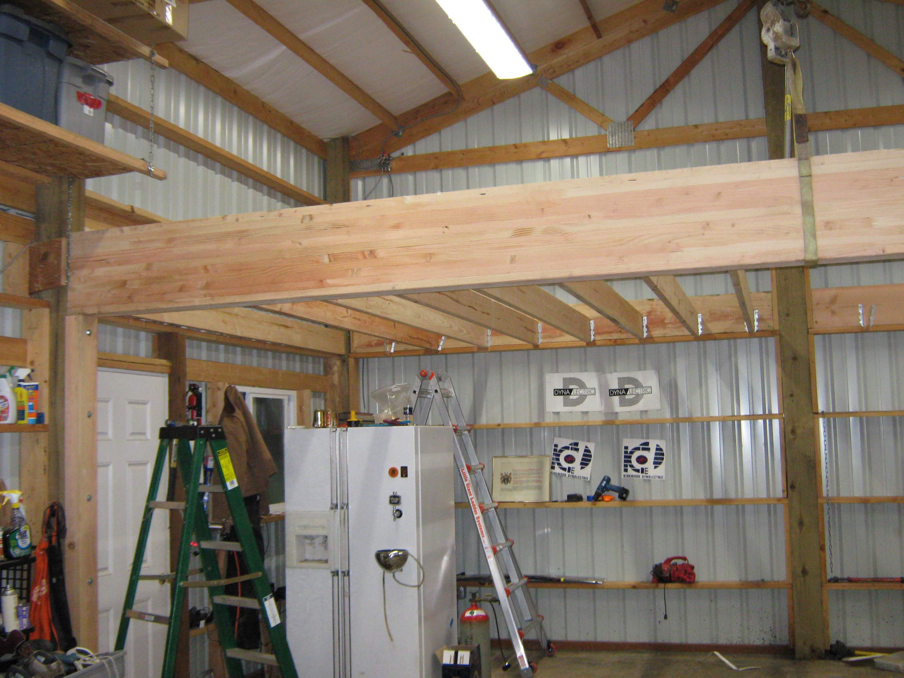

No problem. Crappy phone pics but they show what I did.
Information:
1. My intent is office space so things are a bit different than you would do.
2. The stud wall you see is NOT loaded.
3. Barn is 24FT wide.
4. The LVL boards are 20FT long. The rest is steps.
5. The floor is 2"x8" (16" centers) 3/4" OSB flooring.
6. I designed the wall bracket and got it fabricated for 250. If you want I still have my print.
7. The LVL is 14 tall.
8. All my posts are 6X6.
9. I have 83 clear height on the floor level. If I were doing it again, I would use that same #. Very happy with that height.
10. My lowest head height (stairwell area 2nd floor) is 6ft.
11. The place that sold me the LVL calculated what I needed based on what I wanted to do. This was not Lowes...
12. The roof (above the automotive lift) is 13.6 tall.
13. The back header is lagged to all 4 posts on the supporting wall. (2"x8" double)
14. The post supporting the LVL is notched that the LVL sits in the notch. Lags are installed thru the post into the LVL. The post is also attached to the steps.
15. My pole spacing is 9FT (barn build). My "loft" is 20x9ft. Not using the 9FT barn spacing would have made this much more difficult.
16. Steel cost was retarded when I did this. The beam I calculated I would need to = the strength of the LVL you see would have cost over 600 (with a killer discount mind you). Steel cost may be better now, but the LVL cost me 208 (for both pieces)...
If you have any questions PM me I can provide more pics via email if you wish.

That is my plan except I was planing on spanning the whole 24' Did you pour your Post in or is it sitting on the slab? My stairs would be easier your way.
/ Pole Barn Loft Help Needed #11
The post sits on the floor. My carpenter wanted to lag it down / attach it somehow. He was denied due to (radiant heat). Given it's mounted (lags) to the LVL and the steps (steps are fastened to the outside wall post) I accepted not having it in the crete.
Crete was poured around all the outside wall poles when the floor was poured.
I made the call on the stairs because I wanted to keep all the floor space possible for the office. Having the stair entry in the "main" area would have made a mess of the office layout. Remember in a low headroom deal like this, the stair opening will need to be above the very first step. You don't get away with 2 or 3 steps that are covered above by floor. My stairs are a bit steep. If you went with something "comfortable" you might end up needing an opening of 12+ft long + width of steps. That was a deal-buster for me.

My slab is 4'' Did you have more than that? I did not think I could just place a post on a 4'' slab. Thank You for the pictures. I think I am going to do about the same as yours. the stairs have been killing me about the wasted space. I am now worried about the Post on the slab.
BOB
/ Pole Barn Loft Help Needed #13
Bob,
I would check with someone "qualified". However, I see the math like this:
3000+PSI concrete
6x6 post = 36 SQin
36 x 3000 = A very big number...
My concrete is 5.0 thick, however it has 2 layers of mesh and a bunch of tubes in it. I took far greater issue with the possiblity of knocking the post down and the office falling. I feel pretty good about the floor being able to hold.

One more question. What is your Rise / Run of your stairs? Are they too steep? I am going to span the 24' with a 5-16 glulam (only $10 per foot) but will need to make short steep stairs. I will post Picks after x-mas when I finish

I want to keep them inside. I ordered my beam. 5-1/8 x 16-1/2 glulam ($10 per foot Home Depot!!!) designed the loft for 10 dead load and 60 live load.

well the rough framing is done. Great project so far. Here are some pictures. Need to get the walls going now.
