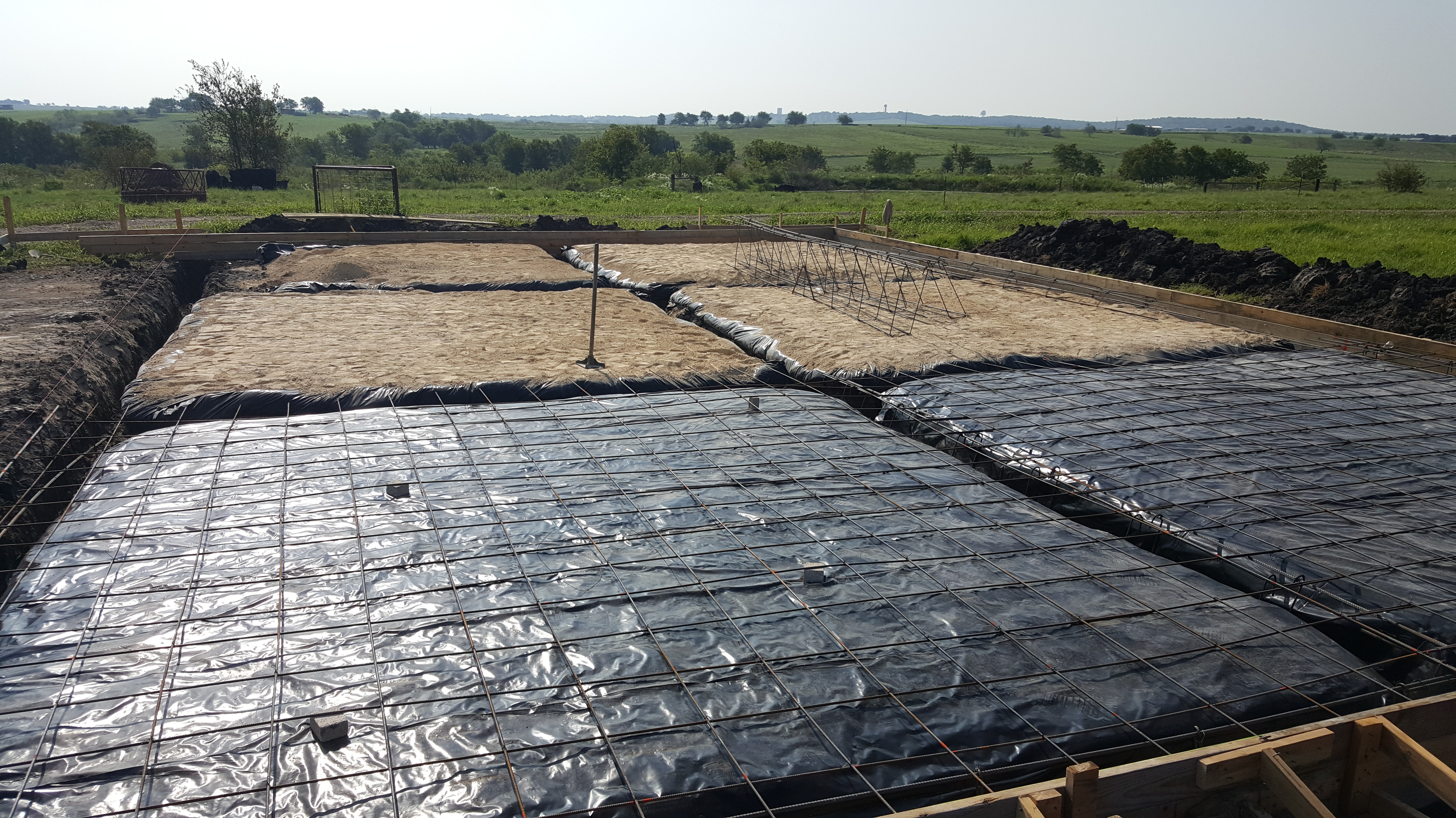

OUCH!! My concrete was $12,000. and assembly crew was $7500. on my 40' X 60' in 2015.
Your lucky you have good soil. 100 yards of concrete for my slab.

I am working on the first building on land I own, a metal garage outsourced. Because there is nothing on the land I permitted as required which was cheap (around $90). 22'x26' slab with footers $5k, building $8k. The building itself has all of the core upgrades I could buy because those are things I can't improve on later. I could have done a pole barn myself, and I would prefer the look, feel, etc, but I just don't have the time for it. It's easier to pay someone to come erect something in a day that will do what it needs to do. I needed somewhere to store my tractor and other stuff while preparing to build a house.
