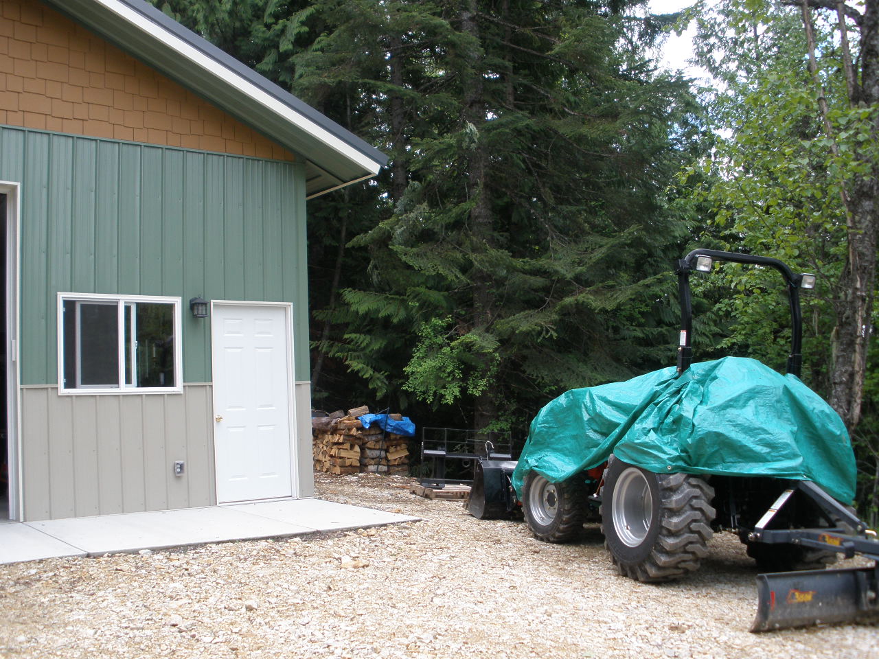

Mine is 54x44 and I have 18" overhangs with gutters. Would not do it any other way.

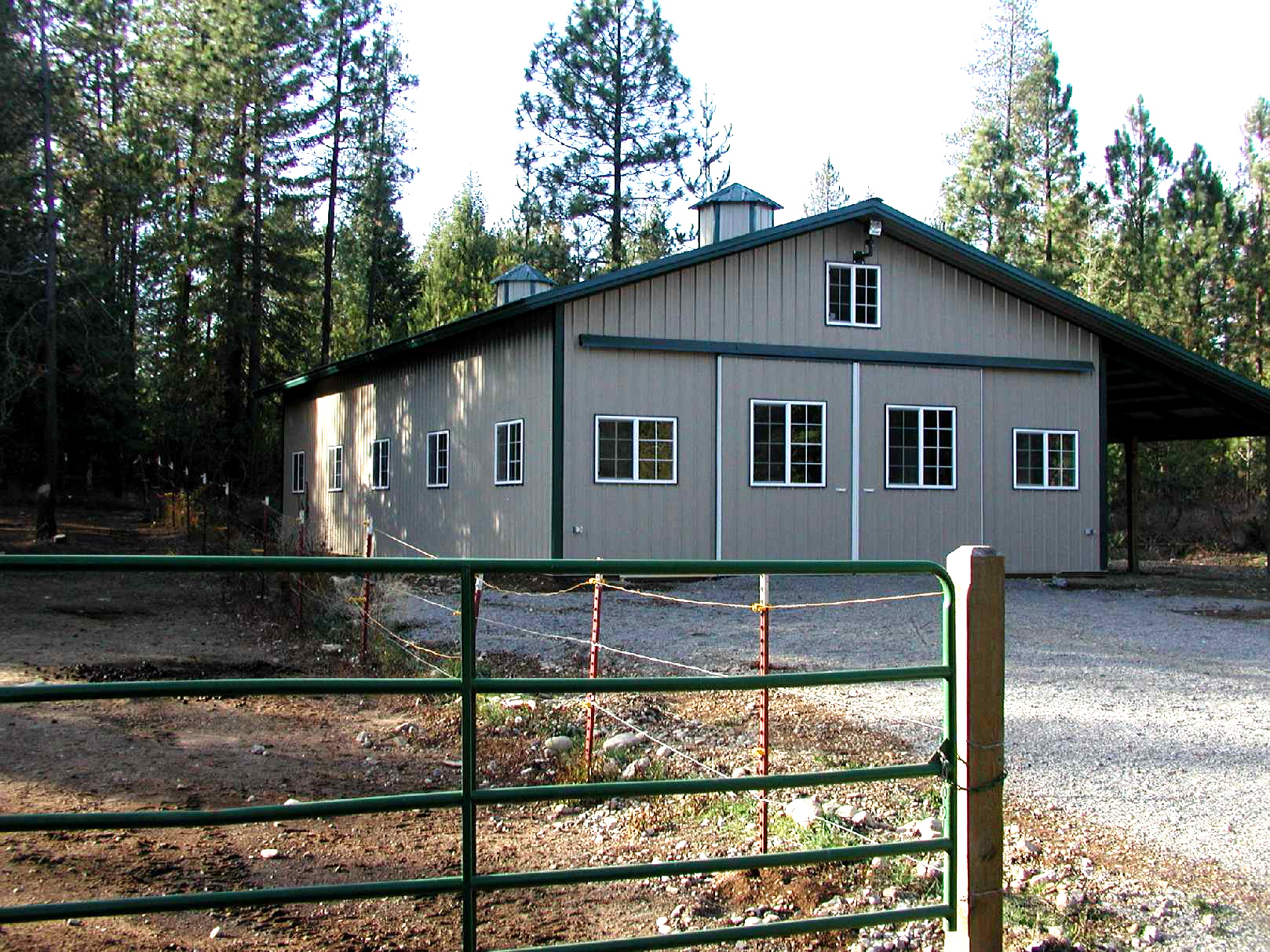

Over hang shown here and all sealed, no problem for the builder.

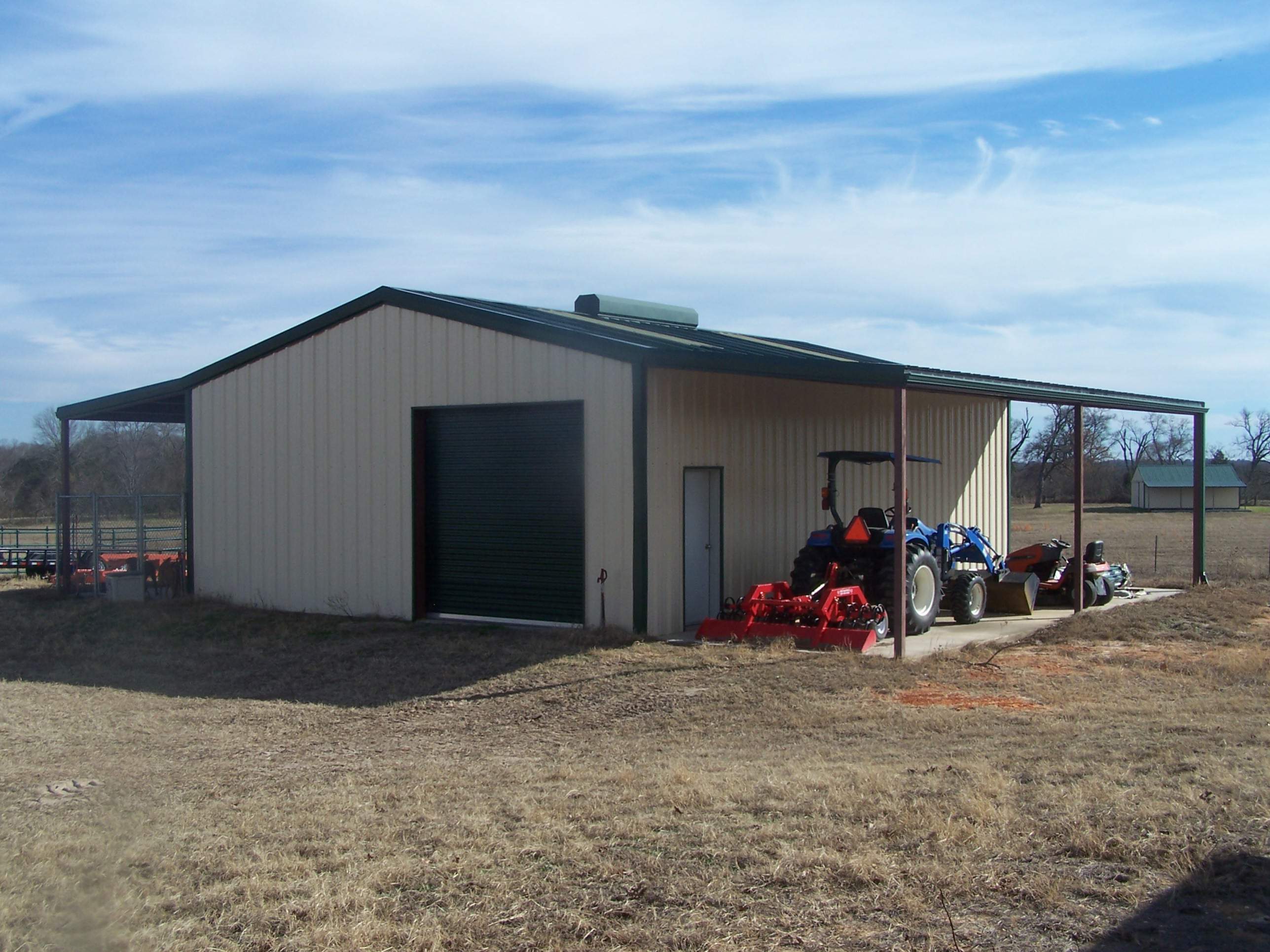

All 3 of my pole barns have overhangs on the sides and on front and back. It adds so much to the overall look of the building. I have wired 100's of these structures over the past 28 years, and all the buildings without overhangs just look cheap. period.
Like they just dont give a ^^%^ how the building looks. No one would build a house without overhangs.
Id also rather have rain water wash over the roof and miss the walls then run down the walls year after year. That really wrecks the finish on the buildings.
I dont see how an overhang would affect waterproofing or sealing the structure. does not make any sense.
Also, have them finish the underside of the overhangs in metal just like the roof. looks nice and clean.
