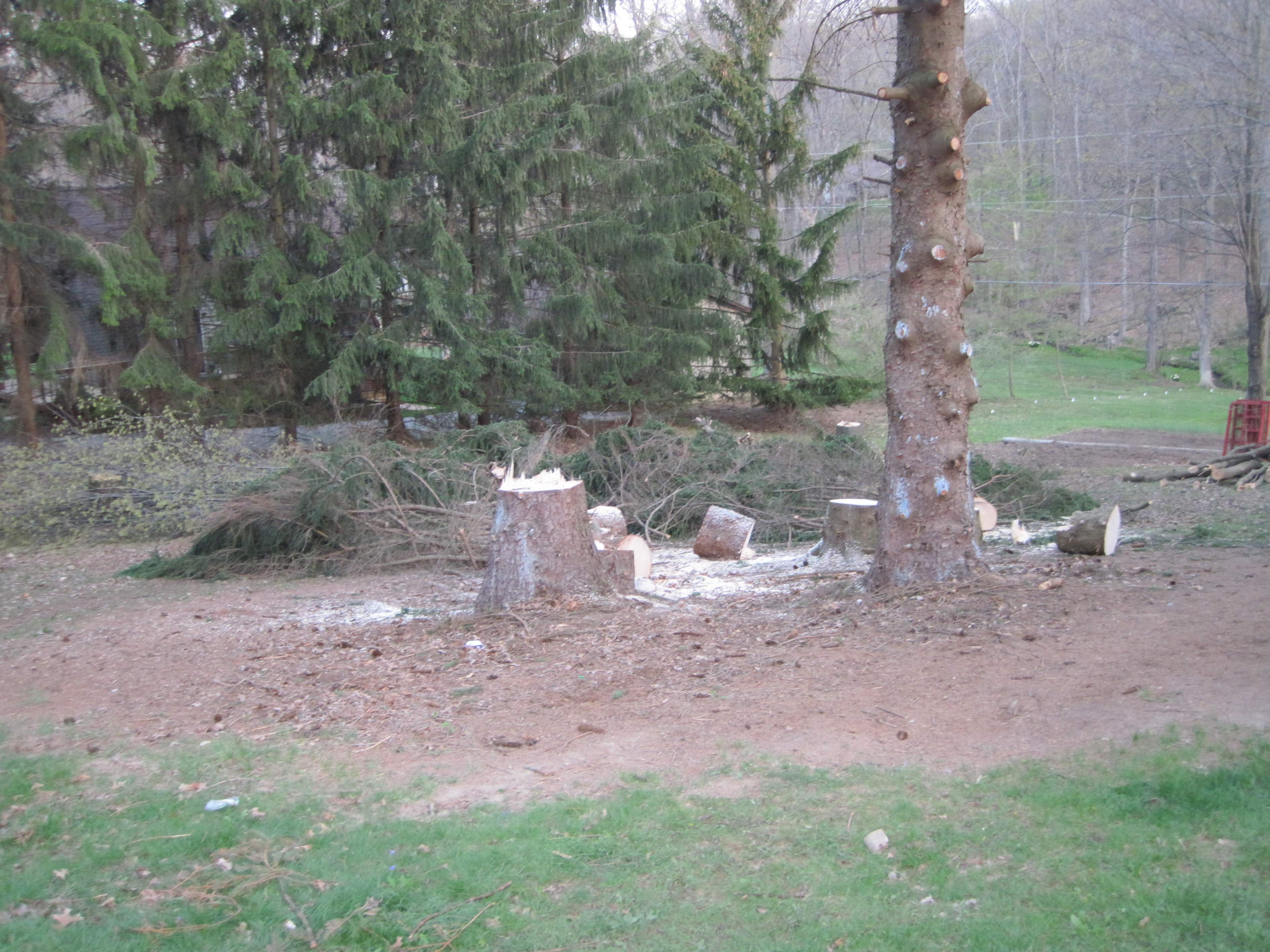

Hi all,
I have been browsing this site for quite awhile ... never posted though. You all seem resourceful on a lot of things so I thought I would ask you all a question about a pole barn site.
I am looking to build a pole barn, a 24' x 32' with a 16ft over head door and a 3 ft man door. Just a basic little barn. Problem is ... the site I am building it on has three big pine trees, and 1 maybe 3 oak trees that need cleared. It is also sloping from what will be the front of the barn to the rear of the barn. I have not put a line level out, but if i had to guess, I would estimate the slope to be about 8-10 inches,
Obviously this needs to be leveled. I would really like to avoid the cost of having an excavating company come in. I am doing the trees by myself with some help from someone who is good at getting the trees on the ground. I then plan to grind the stumps up (rental), and then prepare to start leveling the ground.
Equipment wise, I have a little cub tractor (think small garden tractor) with a grader blade on it. I have no idea how to even attack this project. Is it going to be too much with the lack of resources? I can haul in the fill dirt to build the pad, not a problem, I have a truck and trailer. Will a plate compactor do what I need to do to level that site? Thought about buying a used one and reselling it ... Eventually I would like to put a concrete floor down in the barn, but won't be able to afford it this summer. Should I be topping the pad with gravel to build the barn on?
This project seems so basic ... until you begin to think about what you have to do! Any help is appreciated! Thank You!

Welcome to the forum.
You have a pretty good understanding of the project details you need to consider. A lot will depend on the soil that you are building on, and how it might support your eventual concrete slab. For fill, I'd go with gravel/stone/ and not consider the compactor. I'd set the poles first, then put in the fill.
The stumps and roots left after the tree stumps are ground down will eventually rot out and leave voids under the slab. Not sure how to avoid that problem, but just realize that the more of the woody material removed, the better. Same with organic material that is on the "forest" floor now. Push out as much as possible.
Consider hiring a dozer (or excavator) to push over/remove the trees (or cut high stumps that can be pushed over) and stumps and prep the ground for the gravel fill would be money well spent (IMO).

I agree, If the trees you want to cut down is right where the barn floor going to be, you need to get the roots up pand out. Grinding the stumps is a bad move. It's easier with the tree attached. A dozer can make this a quick work and move the tree to a area where you can work and cut up the tree and clear out the dirt in preparation for the gravel. Sometimes a contractor will give you better price to do all the work of bringing in the gravel and level it then just dumping the gravel and let you try to move with a little blade on tractor. More gas and time will be spent then a contractor to do it for you.

I agree. Dont grind the stumps. And if you can afford it and want to have fun rent a small excavator for a weekend to dig the stumps out yourself.
You will still have roots and such to take care of, so maybe having your neighbors stop by would be best.

You will be surprised how cheap and quick it is to get a dozer in there to do the work. He can knock the trees down and level the site in 4 hours our so.

I would get the site leveled and excavated as the others have said and put at least a foot or more of crushed stone for the future concrete floor. In the meantime the crush will act as a better floor than the leveled dirt.

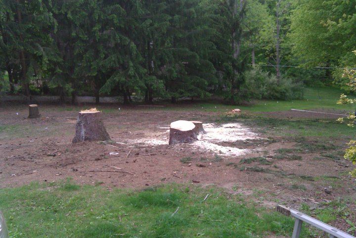

So, I took your guy's advice and had the neighbor come up to give an estimate on the pad for the pole barn. To remove 5 stumps, and level the pad, he said it would be $1500. Given that I would think it would cost me nearly that much to just have stumps taken, i am going to give him the job. He said it doesn't matter how high the stumps are, he is going to bring in his track hoe to dig them.
He was going to leave the pad dirt for me, should I put stone in before or after the building is built? He said he just poured concrete on dirt in his building where he parks a lot of heavy equipment with no issues. I just want some gravel for the time between when I build the barn and when I pour the concrete.

No matter the use of gravel or concrete for your barn floor the best application would include removing top soil and all undisturbed soil before gravel or concrete installation. Actually a good 6" layer of gravel or better,let settle for a few months will give you a very stable foundation for a concrete pour in the future.
