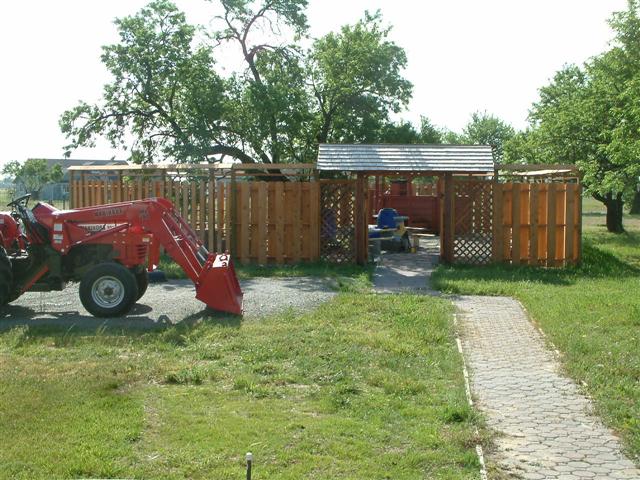

I have searched and read about how to deal with the ground contact part of the post. I'm familiar with the options, concrete/no concrete/post protectors/footing with earth backfill, etc. Alot of opinions, all good ones.
I'm in VA and have a well drained site. Leaning towards using concrete to fill hole, maybe post protectors but they are very pricey. Post are .80 treated.
Question- Has anyone ever tried or have thoughts on using any coatings on the ground contact area of the post. Something like rubberized roofing cement with fiber?
Thx-MD80
Yep. I use auto undercoat spray coating on pressure treated posts for a garden fence I built a few years ago.
That stuff's also good for covering pruning wounds on my old almond trees.
