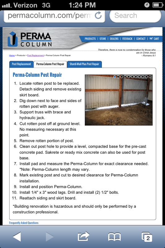

That is a good idea. Found this while researching. Seems pretty straight forward.

The Perma Column (or concrete in general) is the way to go these days for new const & repairs. Govt. won't let us use the good chemicals for rot proofing wood.

I used to haul Perma Columns for a company that also had a franchise and plant to produce them. As I recall, the columns would add 25% to the cost of a new building. Something to consider especially for builiding intended for other than ag purposes. If memory serves, engineering studies showed the connection to the wood to not be a weak point. The wooden parts on the new barns sold with them were nailed up 2x rather than sold or gluelams. The columns by the way are produced and cured under controled conditions. They are heavy to work with. (No connection on my part to the company or columns)
