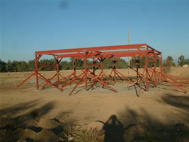

I built a 20 x28 ft shed recently using doubled 2x10 and 2x12 nail-lams setting on top of 4x6 pressure treated posts. Seems to work OK. 4x4 posts are too small for this type of structure.

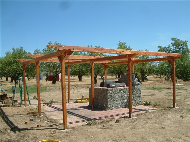

I've used the sandwiched method on pergolas with 4x4s, nuts and bolts. Small wind loads so 4x4s work OK.

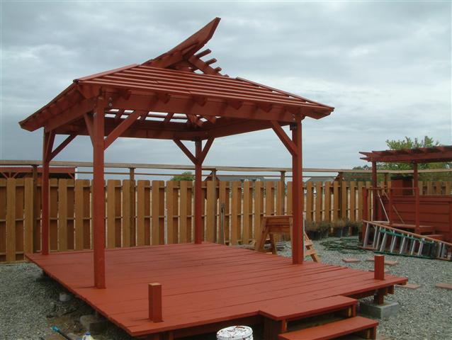

Finished a Japanese style pergola last month with doubled 2x10 glulam/nail-lam construction on 4x6 pressure treated posts.
Good luck with your project. And be sure to use a lot of 4x4 knee braces on the frame.
