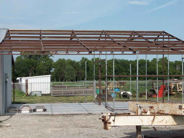

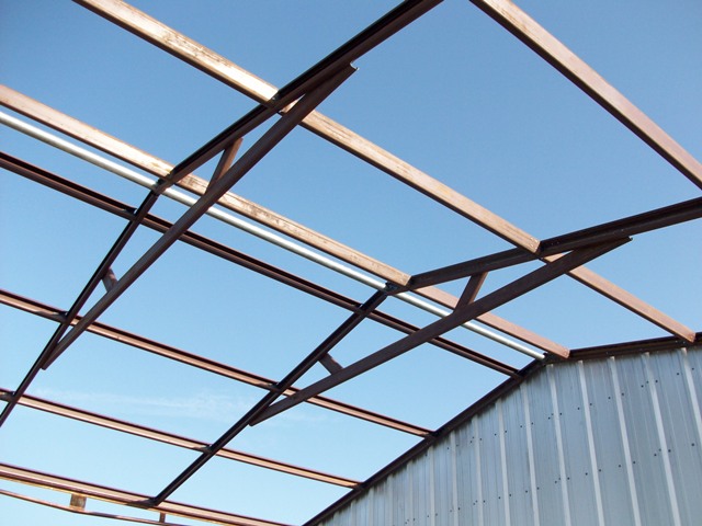

That price is half or less of what I'm paying at my usual sources. I would have a couple of questions about the material.
All pipe isn't the same. What the steel yards sell as fence pipe schedule forty is the absolute minimum for wall thickness and I've found it inferior for strength also. The only stuff I'm aware of going for those prices is thin wall, real thin wall, fifteen-sixteen gauge.
I would use pipe and purlins. But then I've got a couple of patents pending on brackets using pipe to purlin and purlin to purlin construction.
