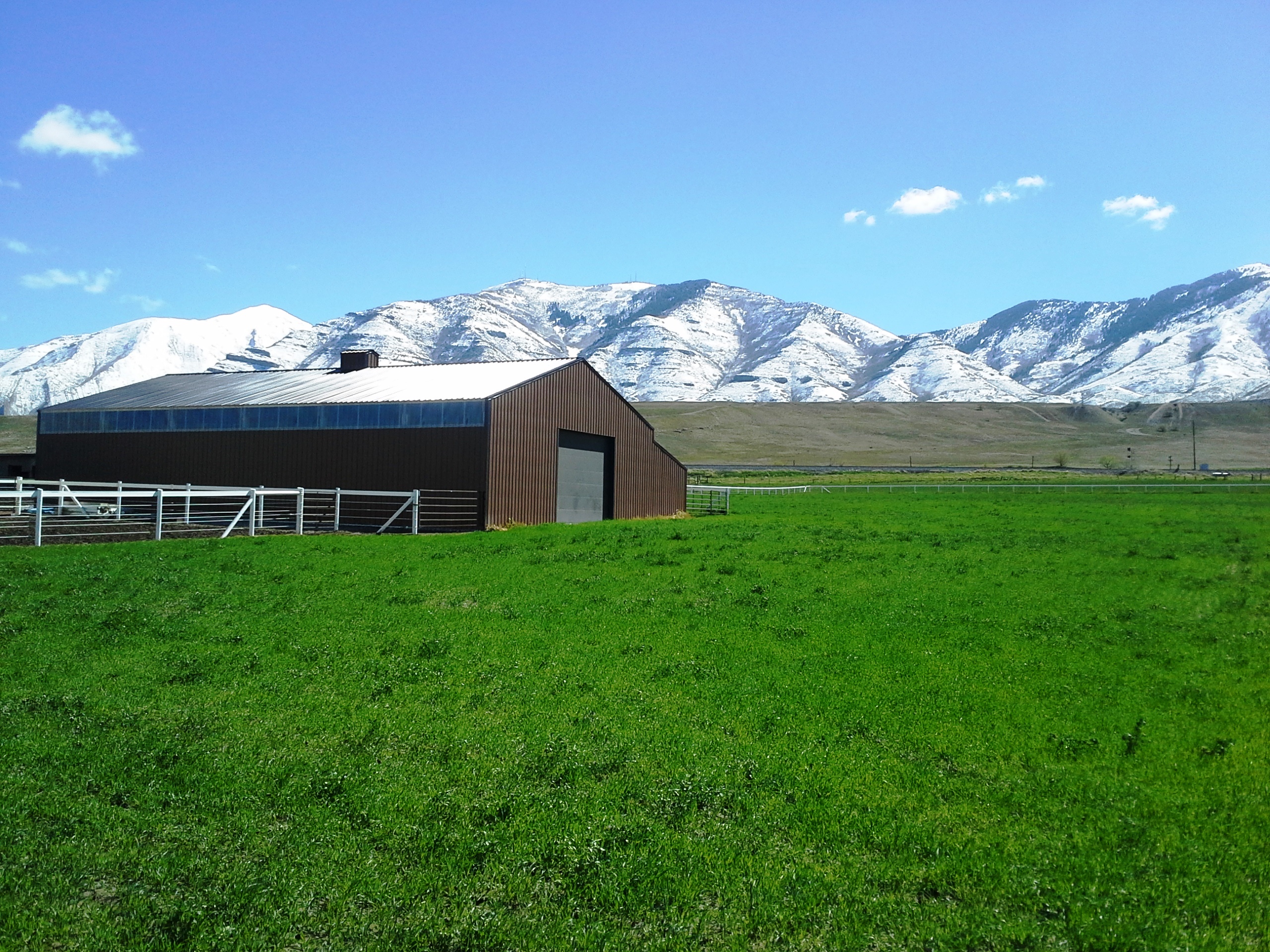

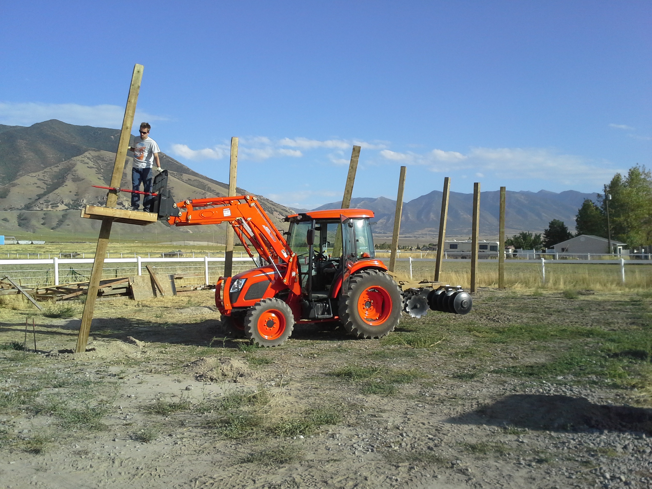

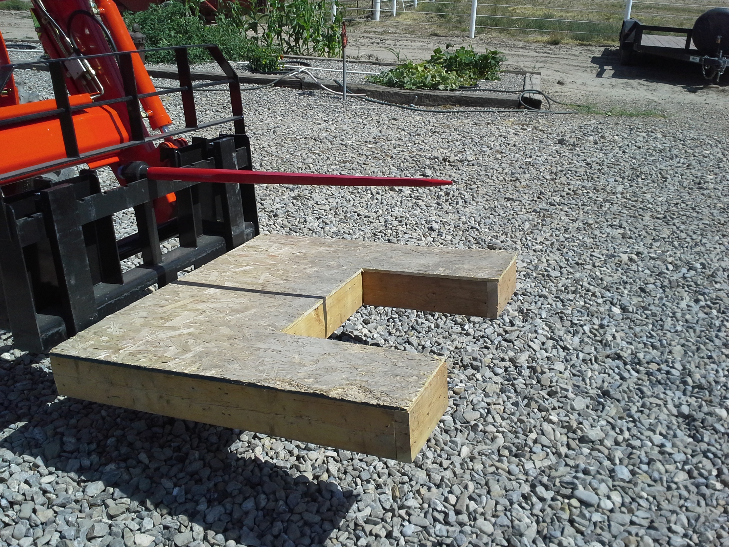

If you search in "rural living" for a thread called "Raising a Barn" you'll see the barn I built. (57X72X12) I have lots of pictures and I think you might get some good ideas on what/how to do yours. One example is setting the posts. Yours are going to be heavy. The method I used eliminated most all lifting. Here's a picture.
Finished barn.
