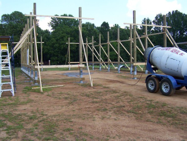

   / pole barn questions #3
Have you followed <font color="blue"> this thread? </font> You really only need to look at pages 7, 8, & 9 to see the construction. Harvey has come up with a great way to do your own pole building. And we had a great get-together testing it out.
Can't really comment on cost difference.

   / pole barn questions #9
Jim,
I'm in southern VT. My pole barn is about 15-18 years old, the posts sit on concrete (attached via a metal bracket) and ALL 18 posts are rotting at the base - even the ones in the center of the barn that don't get wet. Needless to say I'm not thrilled with having to rebuild all 18 ground connections next year but it's gotta be done.
I reallly think you'll need to isolate the wood from the concrete, and, keep the wood-concrete connection 1-2 feet off the ground to minimize contact with ground water, snow, and just splashing from the rain runoff.
Another consideration is sinking the concrete footings below the frost line. My aren't and some posts have heaved and some have sunk (which creates a nice pool of water for the wood post to sit in).
This guy Dick Walker Saw Mill does complete pole barn (& regular barn) kits, other saw mills in your area probably do too but I see his ads in some the papers. Might be worth a chat on pricing since he can quote both.
-Norm
