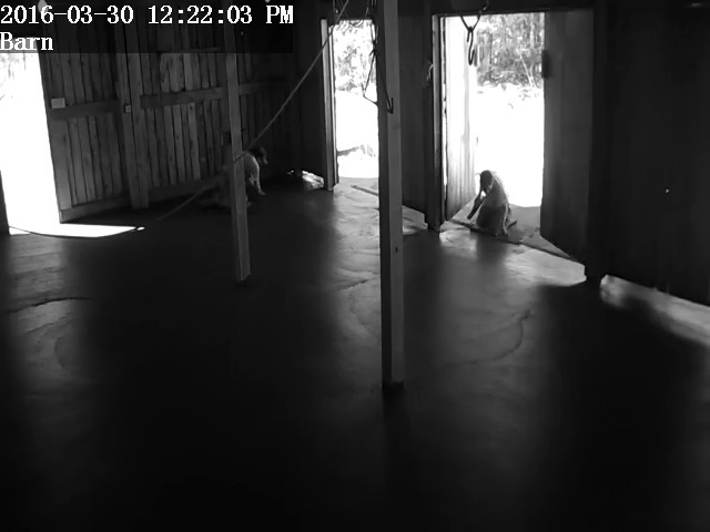

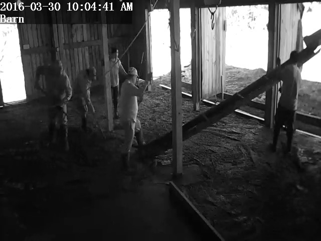

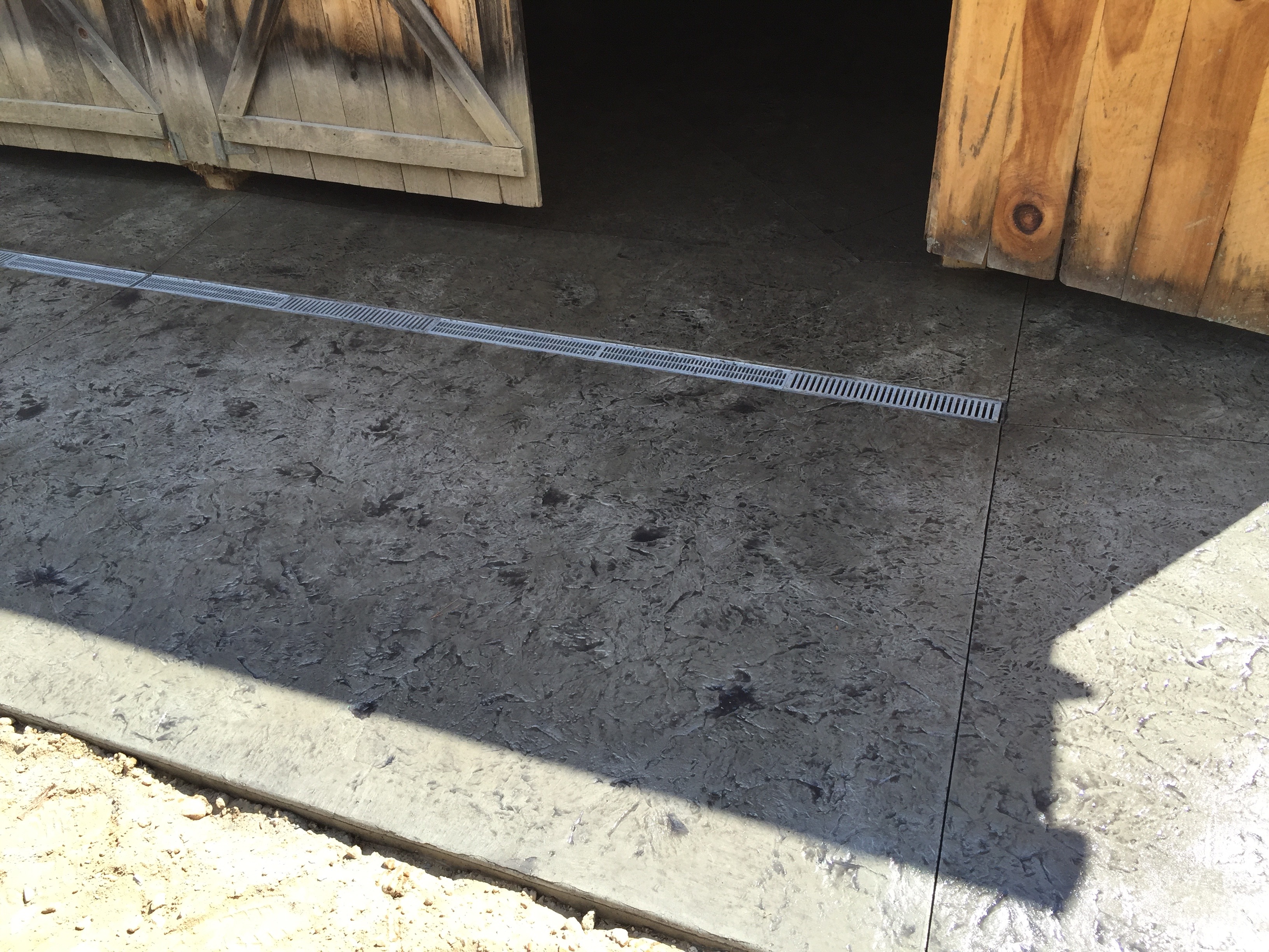

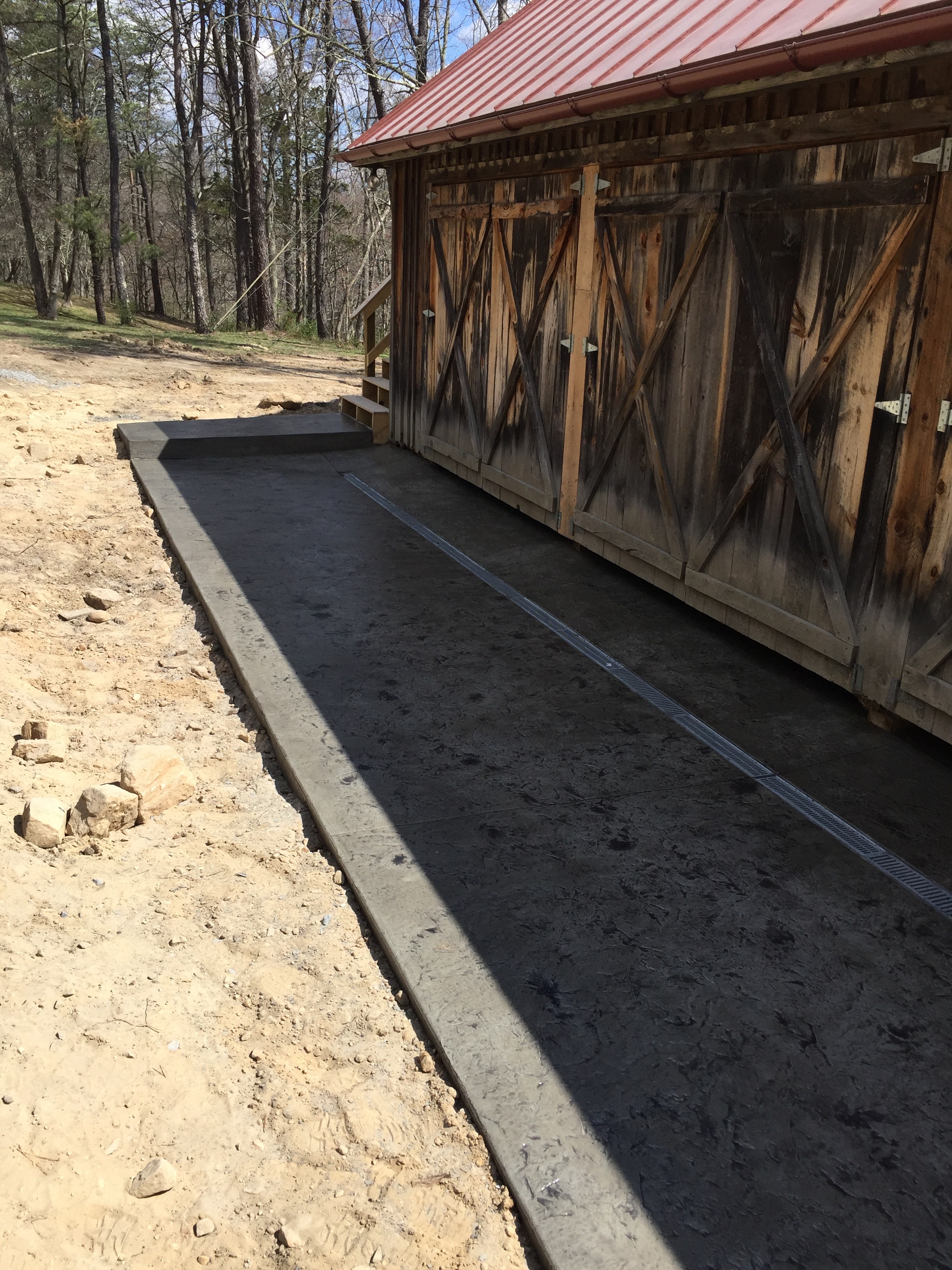

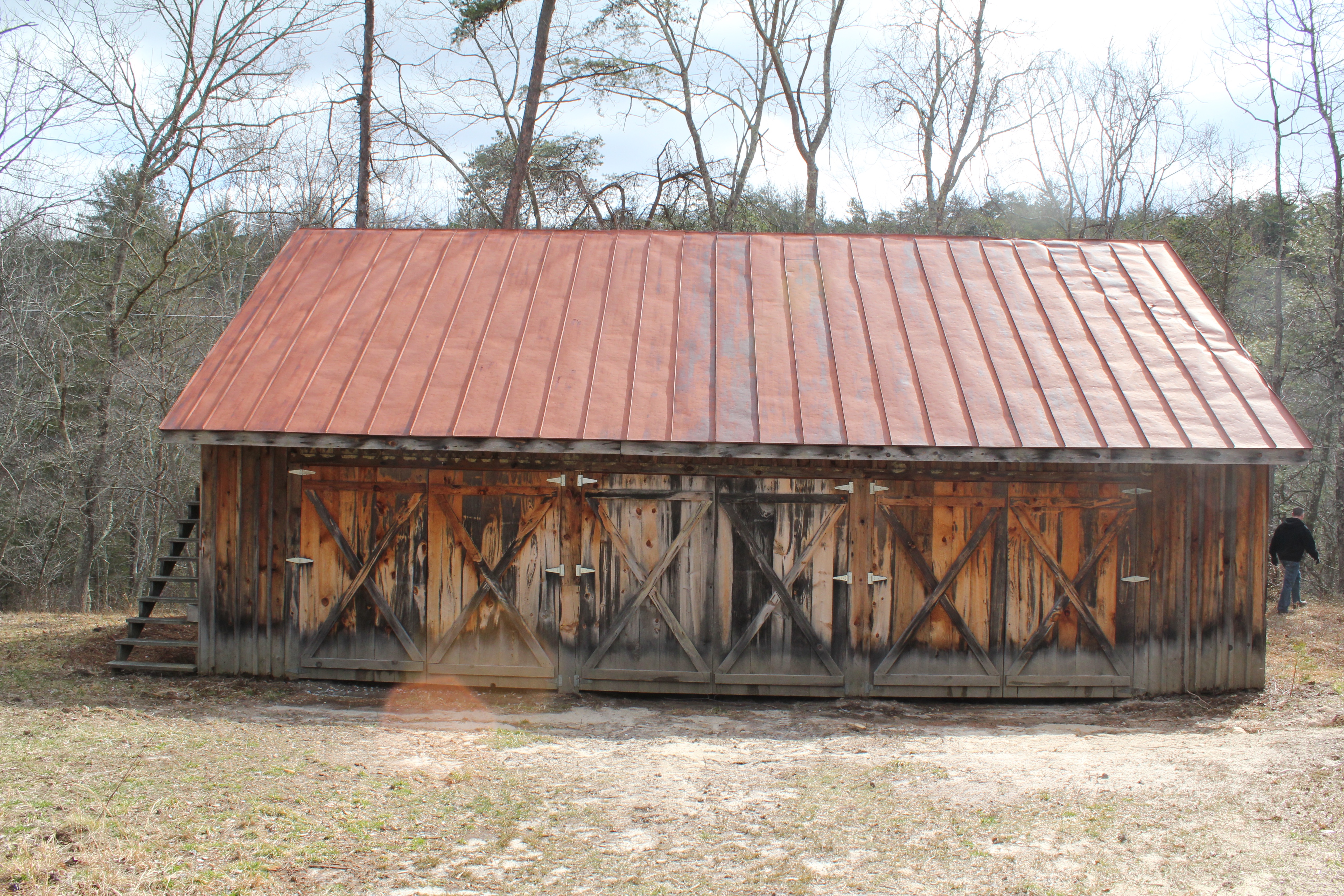

I may have mentioned here somewhere that I was planning to do some improvements to my rustic pole barn. Well, we just completed one of the first major phases. Had a beautiful stamped concrete floor installed just last week. Here are a few pics of the before, during, after.
Before picture of the barn

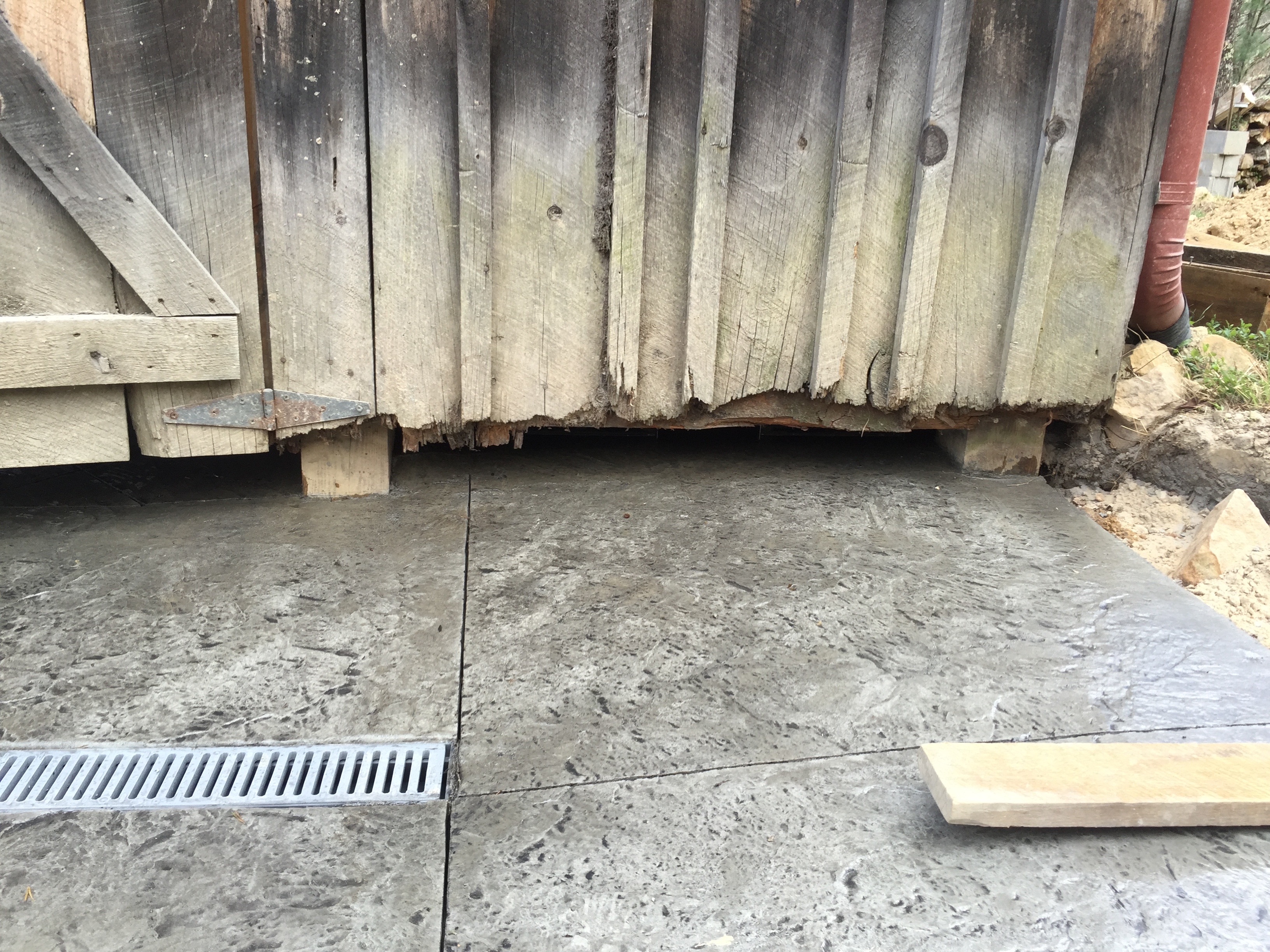

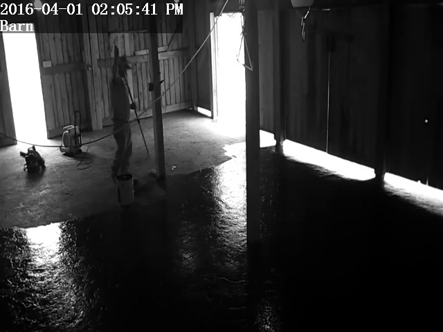

Pictures during Installation
Antique color being applied
Concrete sealer being applied

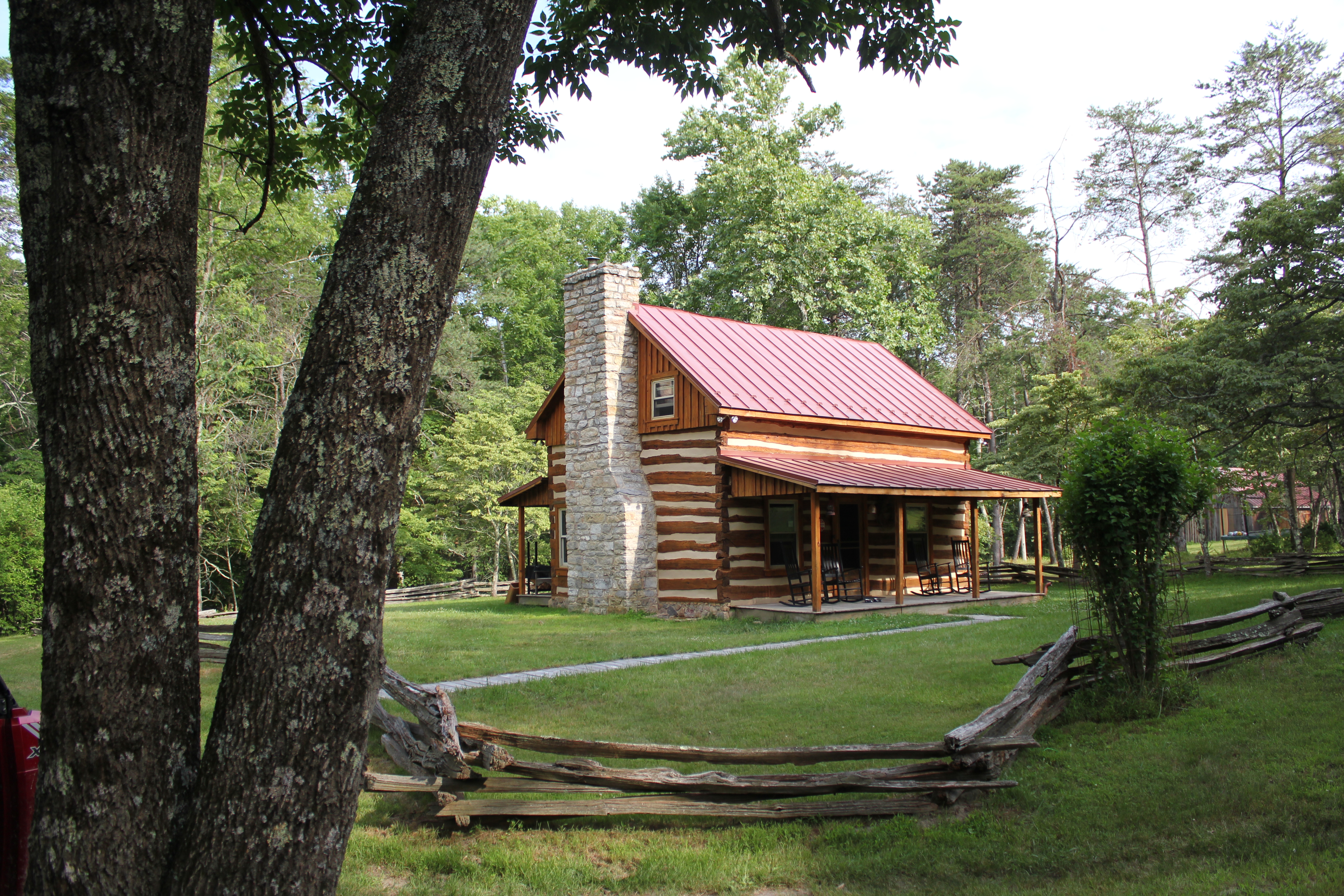

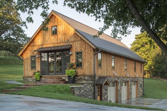

Before the concrete floor was installed, the wood exterior walls were in direct contact with the ground. I plan to trim the wood about 1-2' up from the ground, and then replace it with a stone pseudo-foundation, or facade, all around the barn. Just not sure where to start in terms of a backing to adhere the stone.
Here's a picture of the cabin with a stone foundation that I want to replicate on the barn:
Any suggestions on how to go about the stone facade would be appreciated. In the meantime, I will be working on running a water line from the cabin to the barn (I think I posted about that in a previous thread)

The "lick & stick" fake stone is a good choice, and only requires a sturdy wood wall. I'd frame it 16"oc and sheath it with 5/8 osb or plywood. The only thing wrong with that fake stone is you know it's fake. It's impossible for someone else to know unless they walk up to it and "knock" on it like a door. The sound is all that will give it away.
