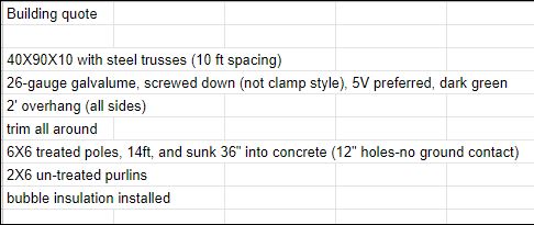

Would you guys mind looking over my shoulder and see if I'm missing anything below? I've requested bids from several pole barn builders and received one for $15,500. This is what I asked for (see below). Do you see anything glaring that I missed? I'm just looking for a pole barn structure, steel trusses with roof-only. Thanks for your input.

The quote doesn't mention sides, roof pitch, or purlin spacing. Are you going to do doors and windows yourself?

I'm doing sides/doors/windows myself (hey, I gotta have some fun out of it). Thanks for the other items. Guess in my ignorance I assumed that pitch and # of purlins was pretty much standard among manufacturers. I'll ask them to clarify it. Thank you.

Why 5v? And I wouldn't use bubble wrap. I have one barn that I used the double foil bubble wrap on and its lasted. That was 2004. All the ones I've used the white/foil bubble wrap on it all deteriorated. Insulation I use now has fiberglass in it. 6' wide rolls

I like the look of 5v. Main thing, I'm not wanting whatever that clamp-down stuff (whatever it's called). 5v seemed to be a good-looking standard. Is there something better you'd recommend? Also, on the insulation, got any links? Most of what I've been seeing around here (other venues) is bubble wrap. Let me ask, can you start with bubble and change out or add-to it with something else later on?

5V (24" coverage ) is more expensive than Rib Panels (36" coverage) you also will get more oil canning on 5v if you do not use heavier gauge 26 or 24

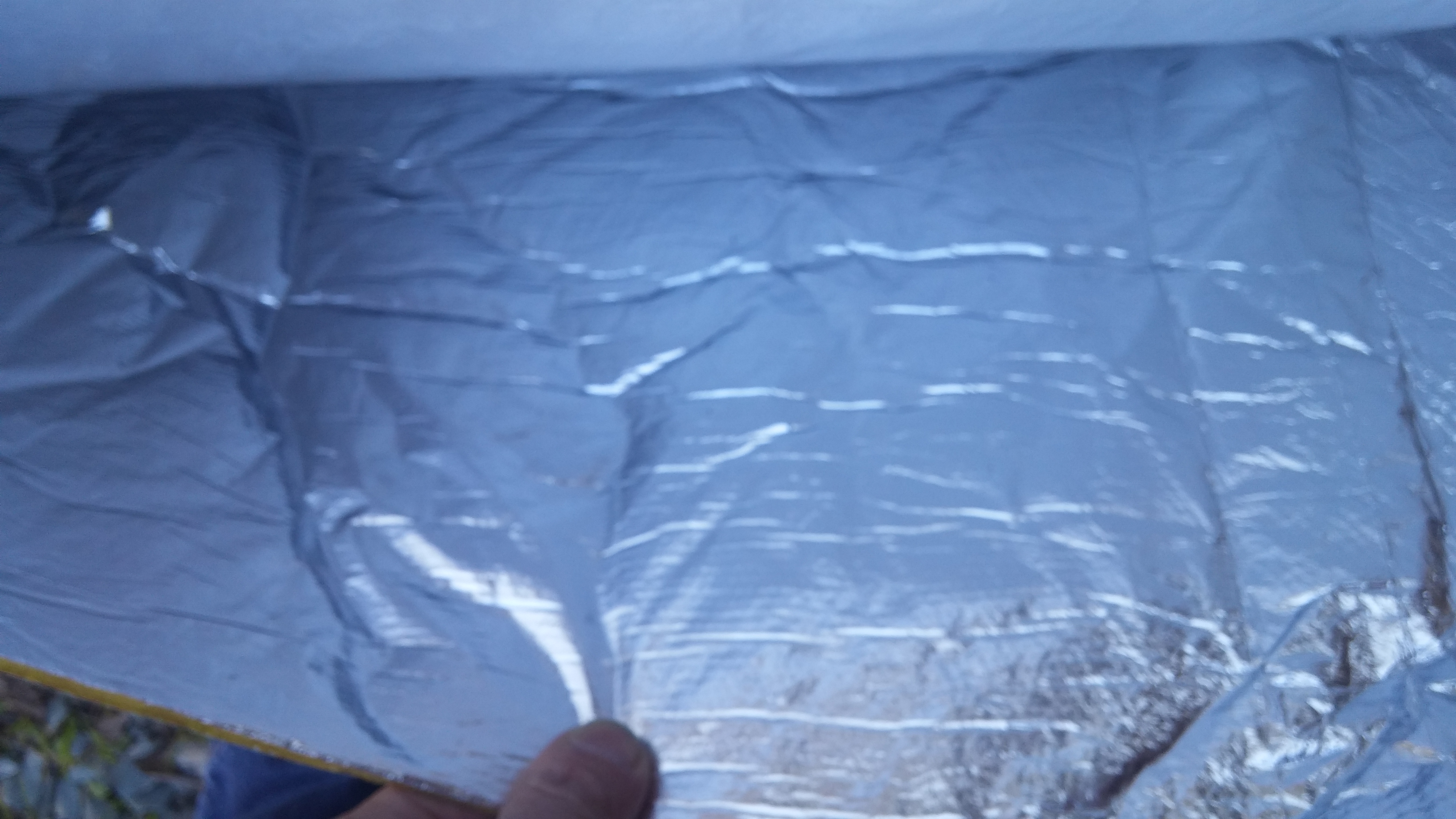

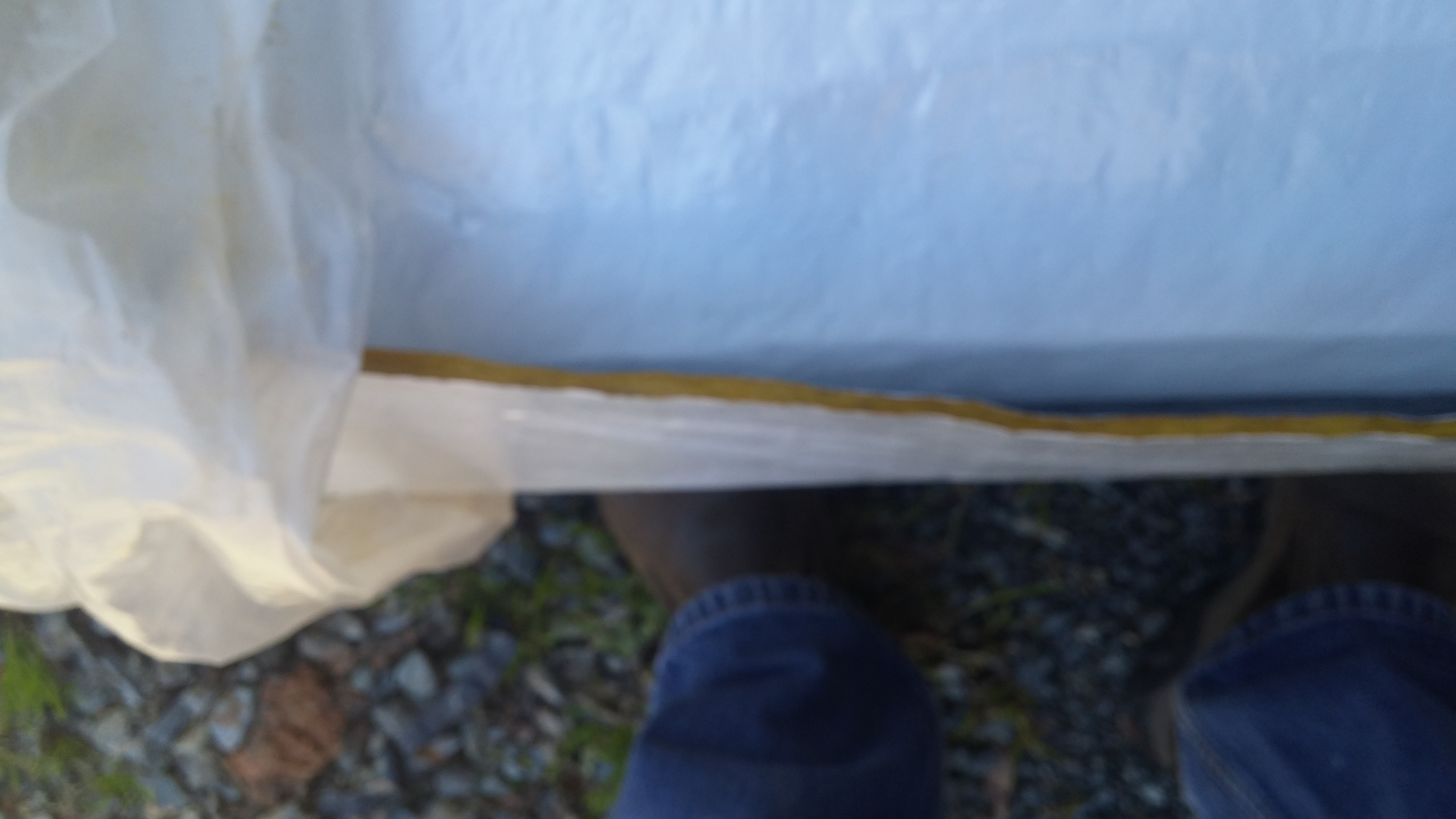

Summertown Metals
This is from a middle Tennessee builder of pole barns and upon reading some of this it seems 29 ga. is suggested for residential and 26 ga. for commercial. I recall once upon a time thinner gauge can be used if it has a higher tensile strength.
