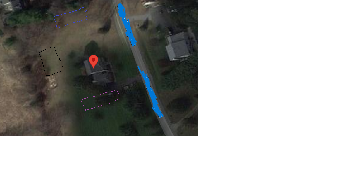

The current garage is 20x25 and is pretty much tightly packed with all my woodworking eqpt and a zero turn. There is literally no standing space on the woodworking side of things. So I am set on a pole barn . My initial thoughts were 24x32x10 and slowly I became convinced it should be 24x40x12. Some more posts from TBN later I am now at 30x40x14. Here is a list of my current eqpt.

Give all these is a 30x40x14 sufficient for future needs as well. I have ample space on my property and have 3 locations scooted out
The purple block is closest to my house and near my current garage. A lot( i mean a lot) of fill dirt would need to be used to level that area. The other two blocks, black and blue are relatively flat.
I will be having someone pour the concrete and install the brackets for the laminated pole posts and then do the rest of heavy lifting myself(with that CUT hopefully).

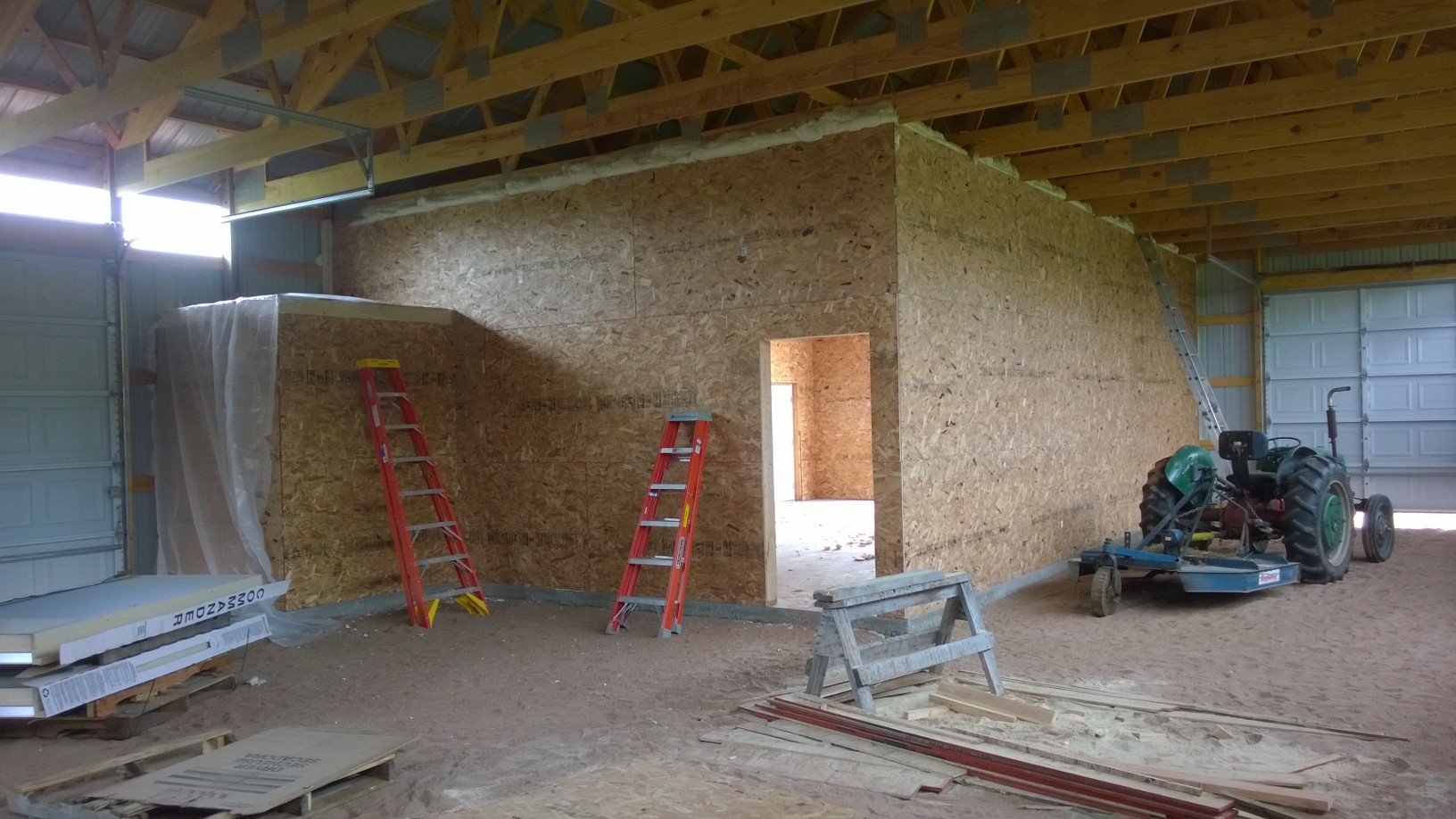

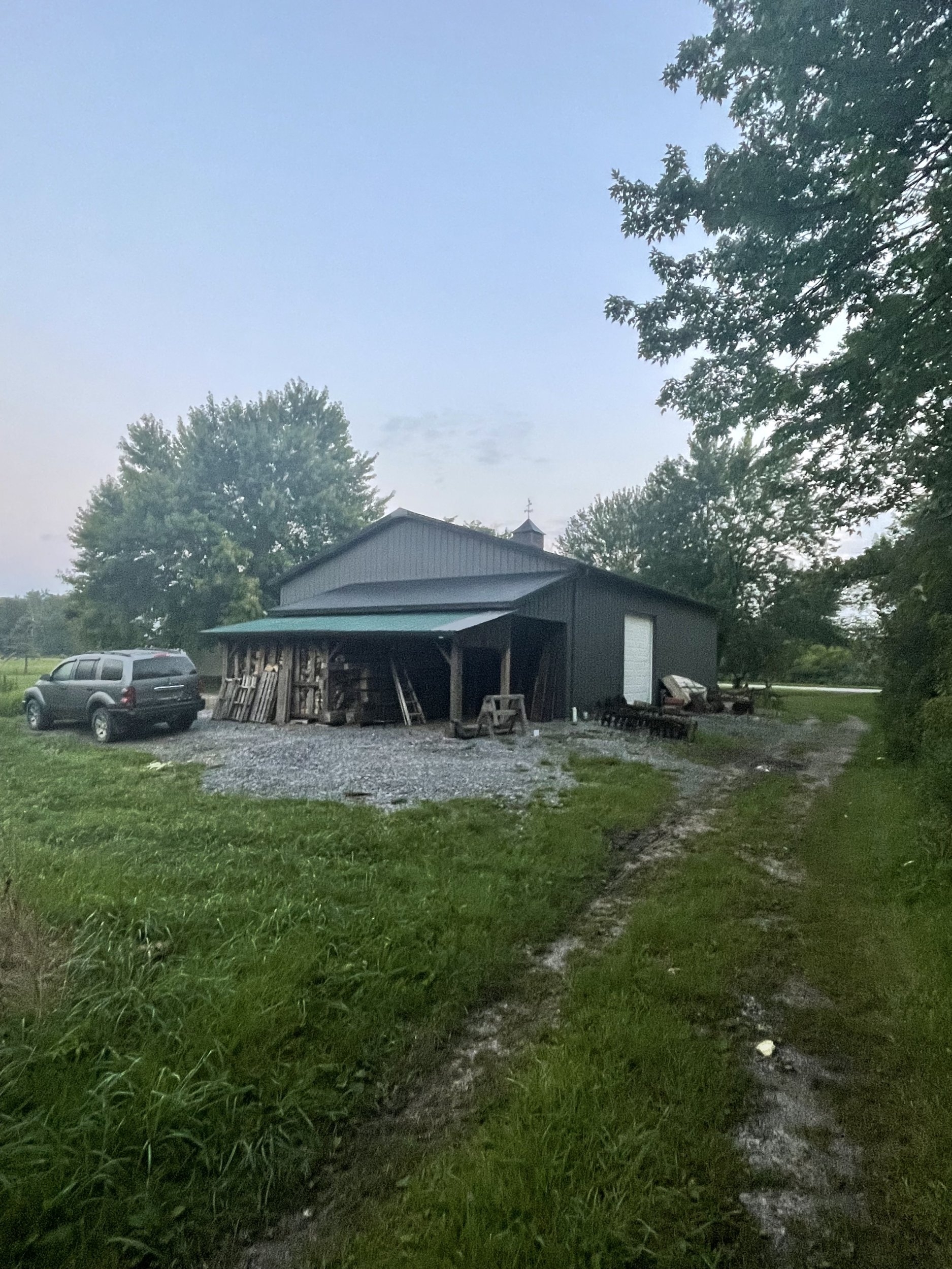

Do what I did, I'm a bit ****. I got some of the paper that has all the squares on it. Cut paper to the size of my tractors, equipment and pickups and placed it on there to see if everything would fit. Worked out great for me.
Mine is 40x60x12 and one thing for sure, it will never be big enough.
My 22x33x12 shop in the SW corner with a compressor room added on.

For the placement you should calculate the amount of fill required vs the amount if gravel required for the barn driveway. Also find out if the city or county would let you do a other driveway some place are restrictive about that and that has a cost too, it looks like two location out of the three would work best with a other road entrance.

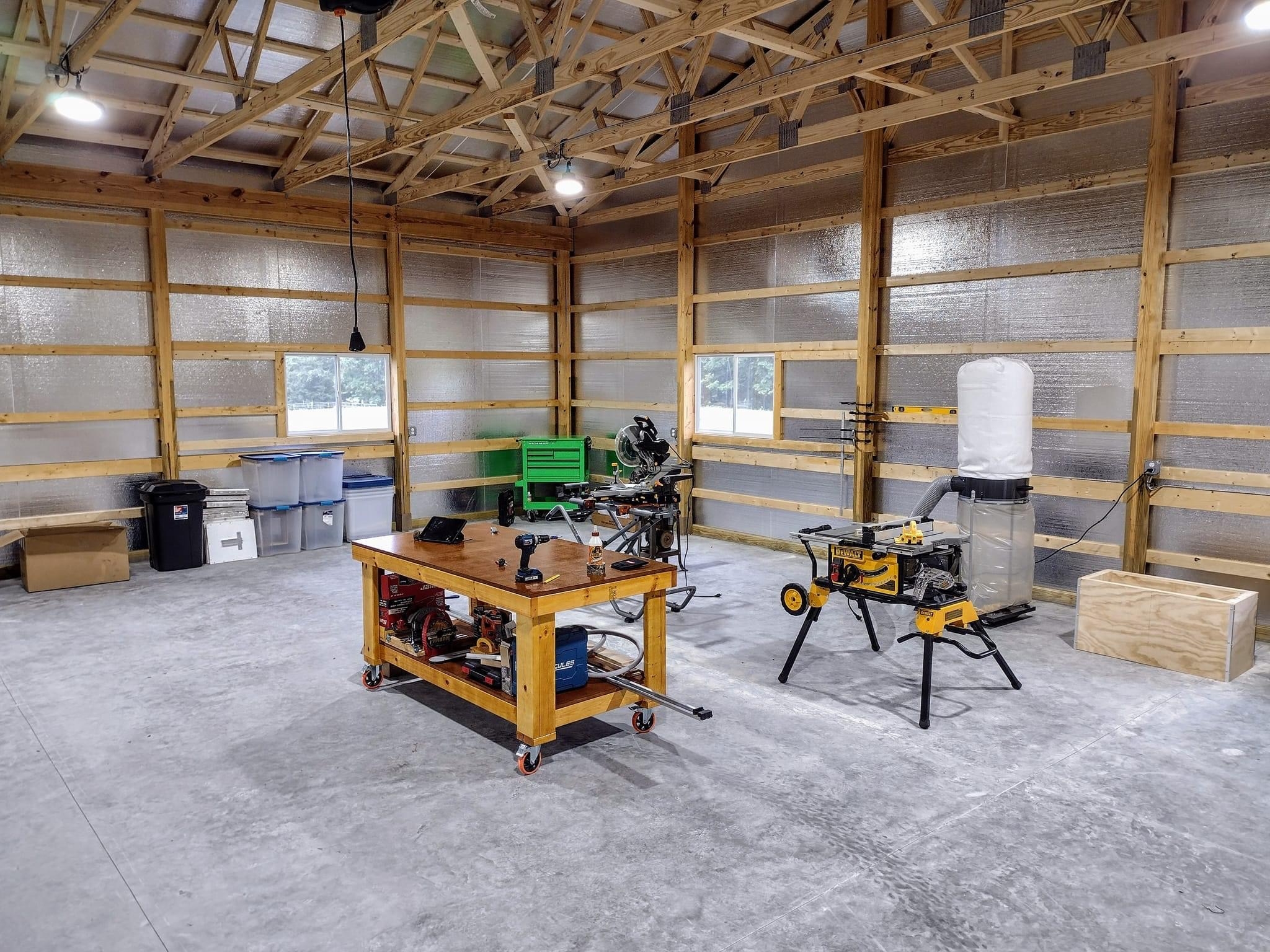

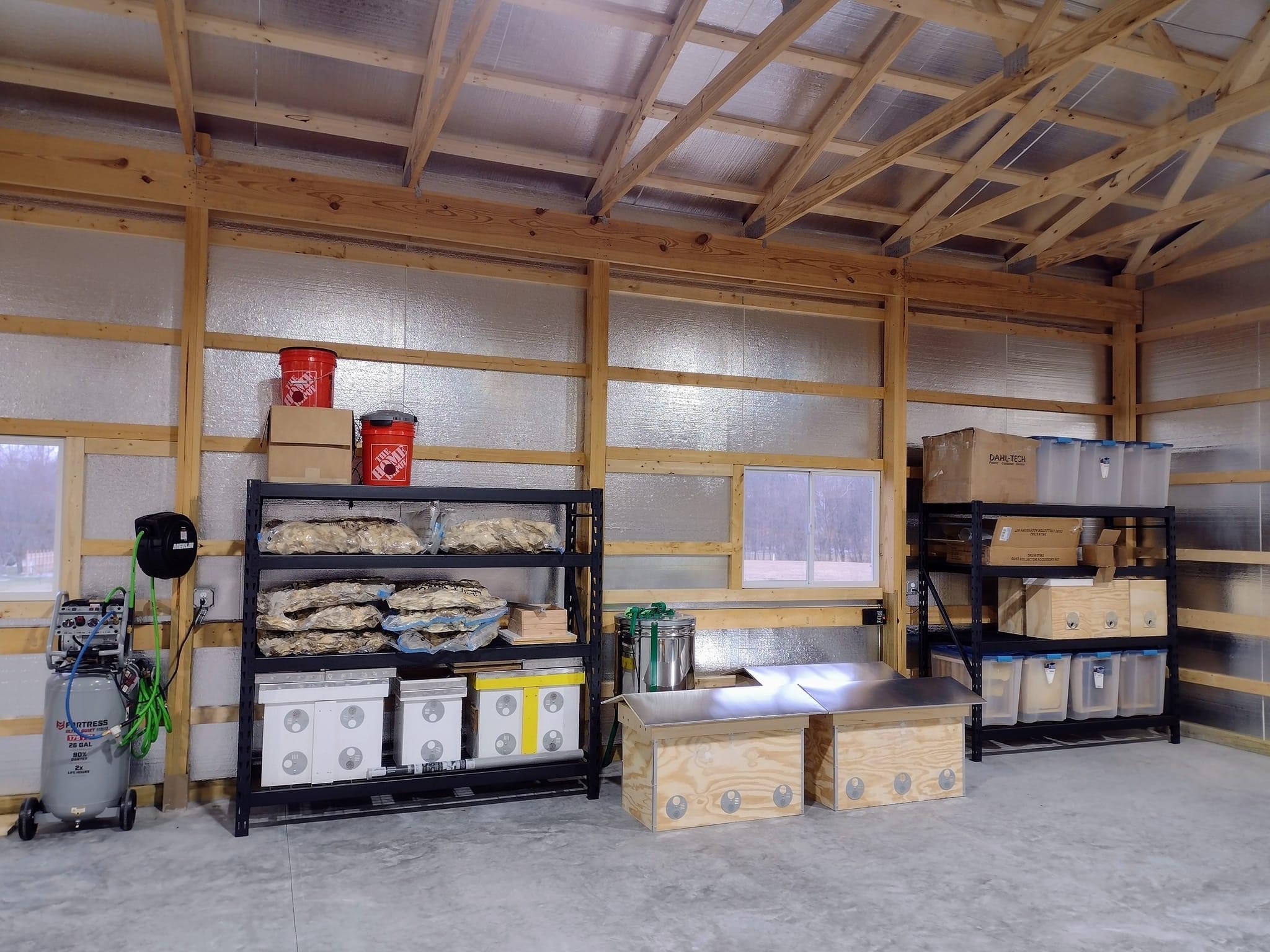

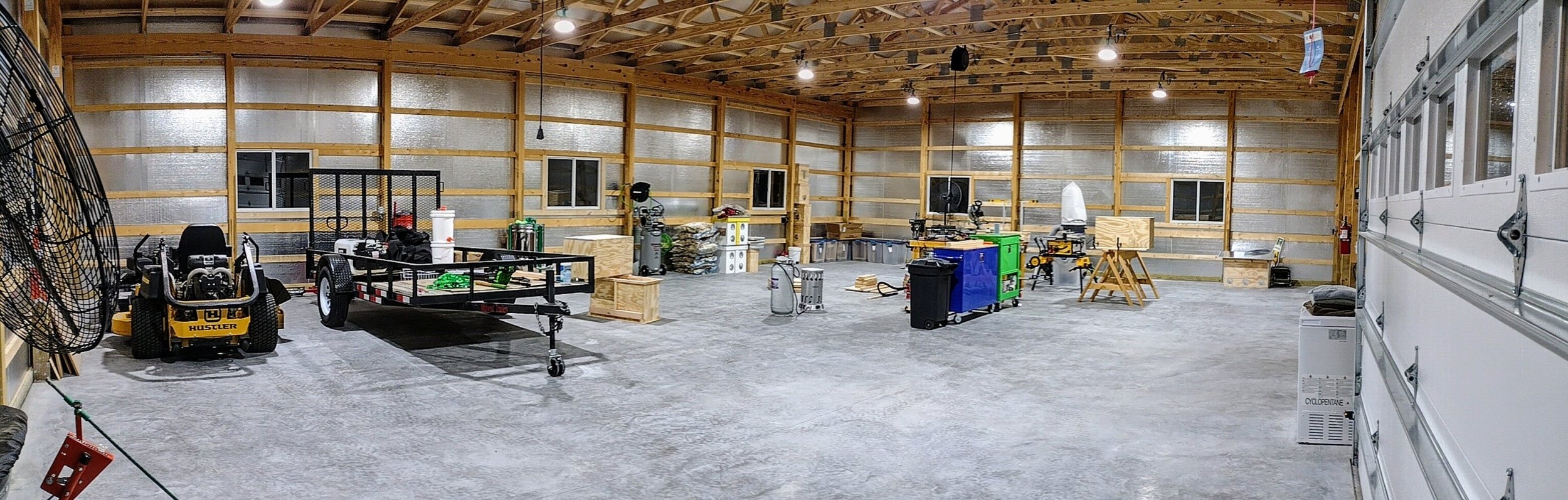

You sound JUST LIKE ME, two years ago. Virtually same space, and equipment. I went 40x60. I’d not go smaller. 30x40 would be TIGHT.
72” ZTR
12’ trailer
48hp CUT
Workbench
Saws
Dust collector
Storage for beekeeping suppplies
ATV
Trail mower
Cultipacker
ETC…

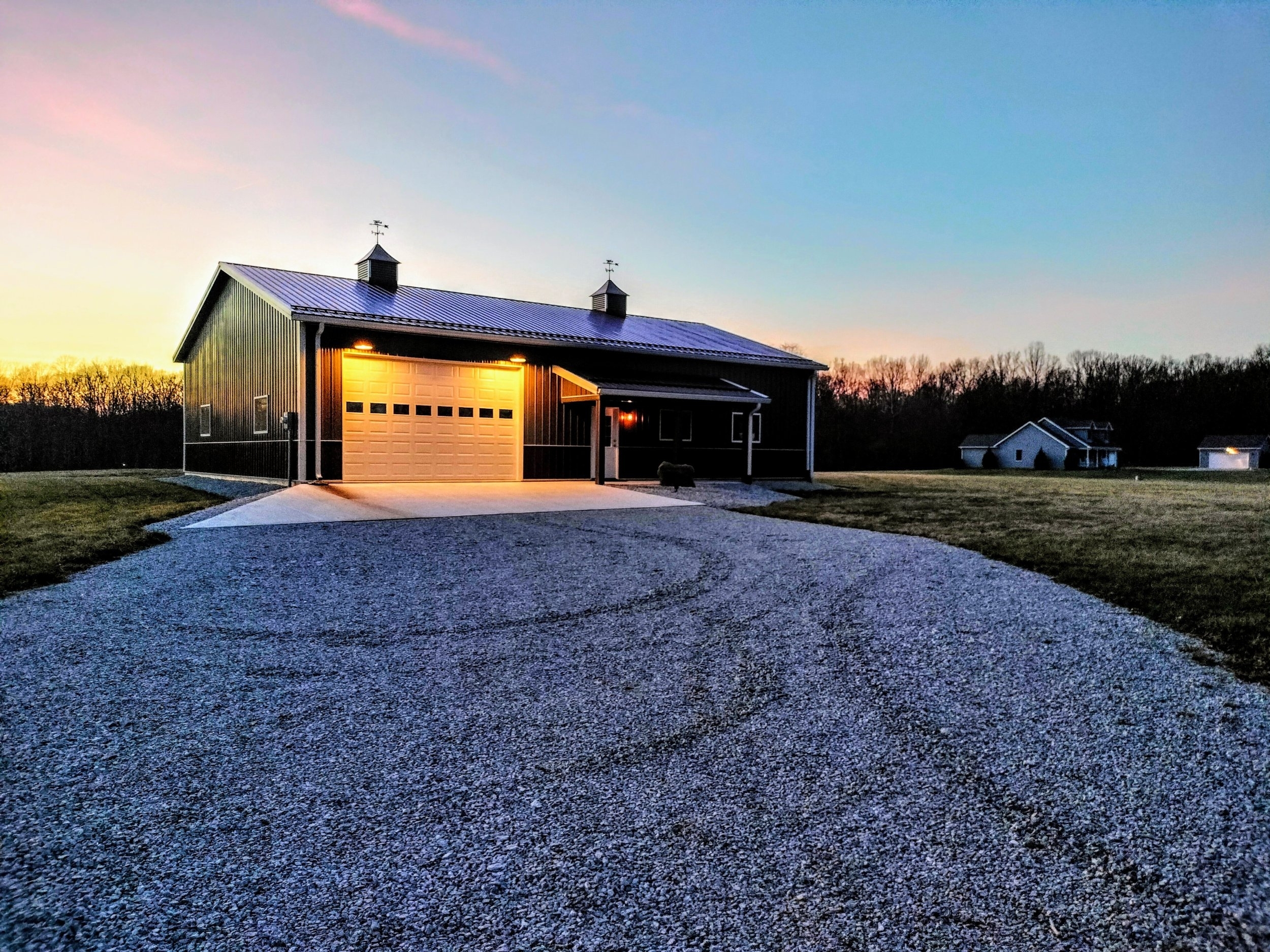

View attachment 855744View attachment 855745View attachment 855746View attachment 855747View attachment 855748View attachment 855749
Great building, inside and out. Curious about what kind of light fixtures you used that appear to work so well? I used 4 each 500 watt halogens because they were only $10 each, but if I ever forget to turn them off, in a few days my electric bill will...
/ Pole Barn sizing for workshop and placement #11
I used (8) Hyperlight Hero 150W 21,000 lumen LED high bay lights. The total shipped was $610. Theyare amazing day or night. One of those photos was at night and there are virtually no shadows. I’m very pleased.

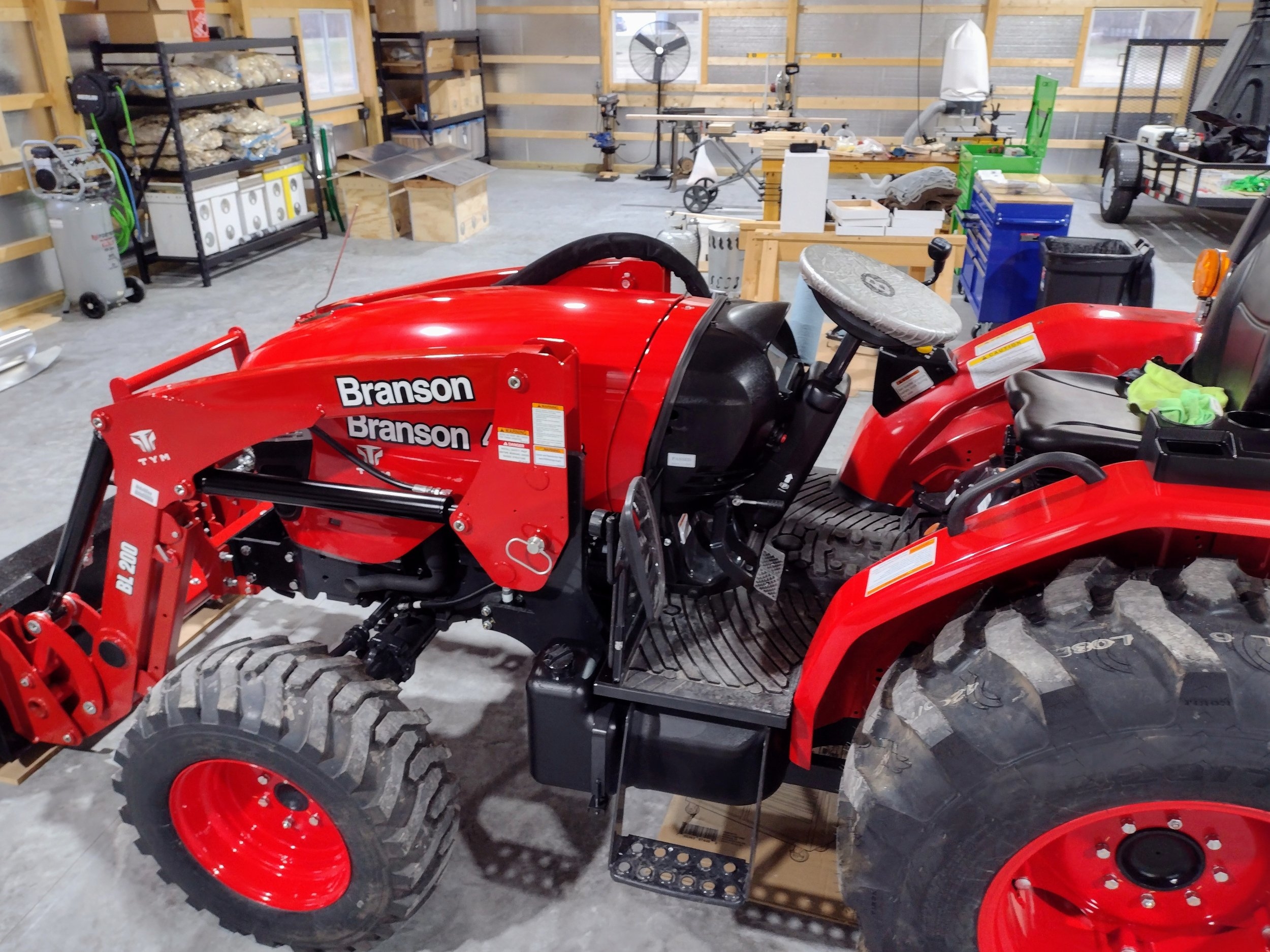

I ended up at 53x36x14. Contractor (Morton) said it doesn't add much cost to make the walls higher and at 14', they can drive a cement truck inside to reach the hard to reach sections. Otherwise, they would have to water down the mix or bring in an expensive cement pumper.
Tall walls might let you build in a little mezzanine for bulky storage.
If you get a tractor, you're going to have attachments, which tend to accumulate over time.

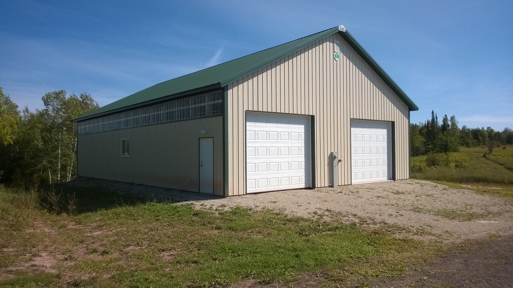

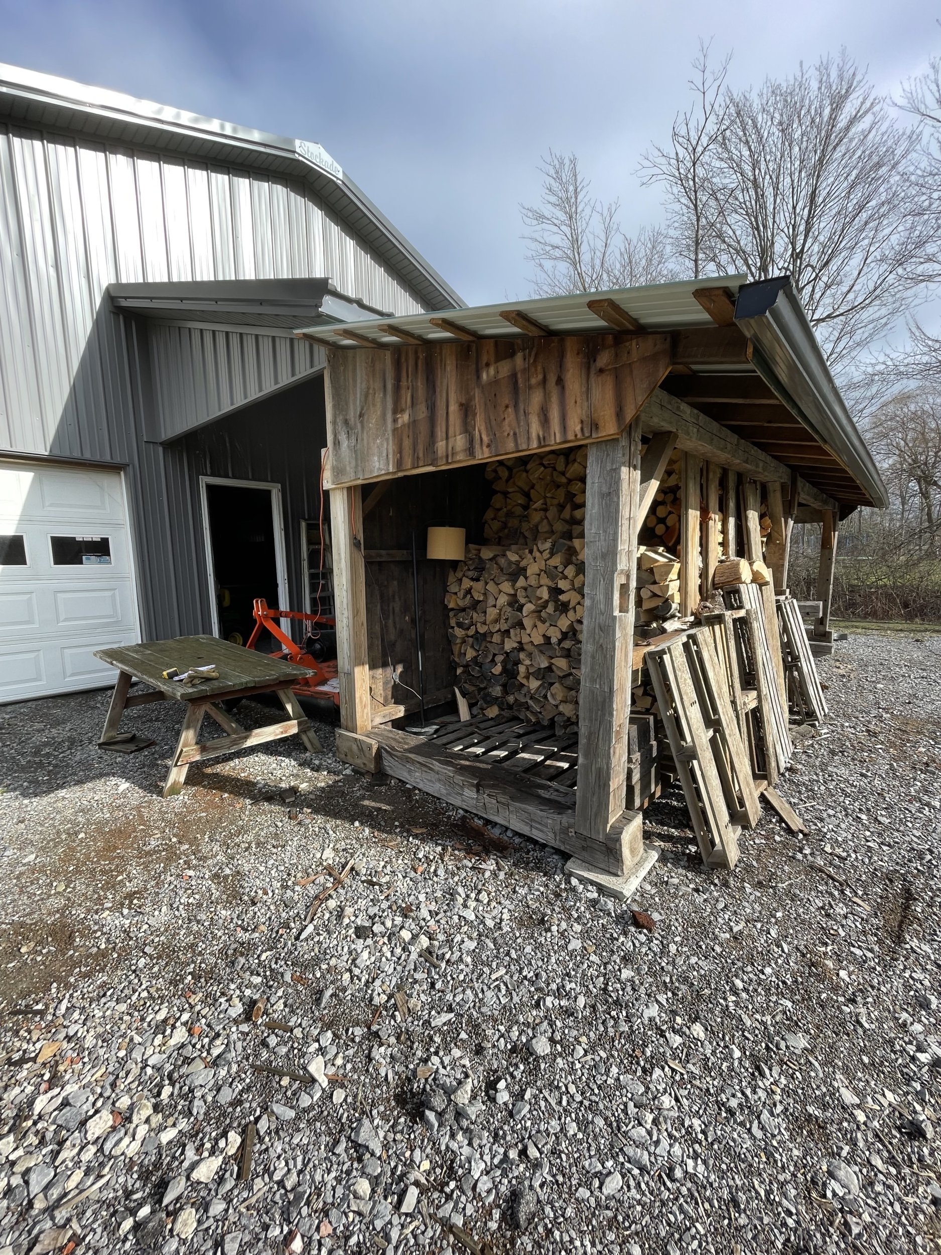

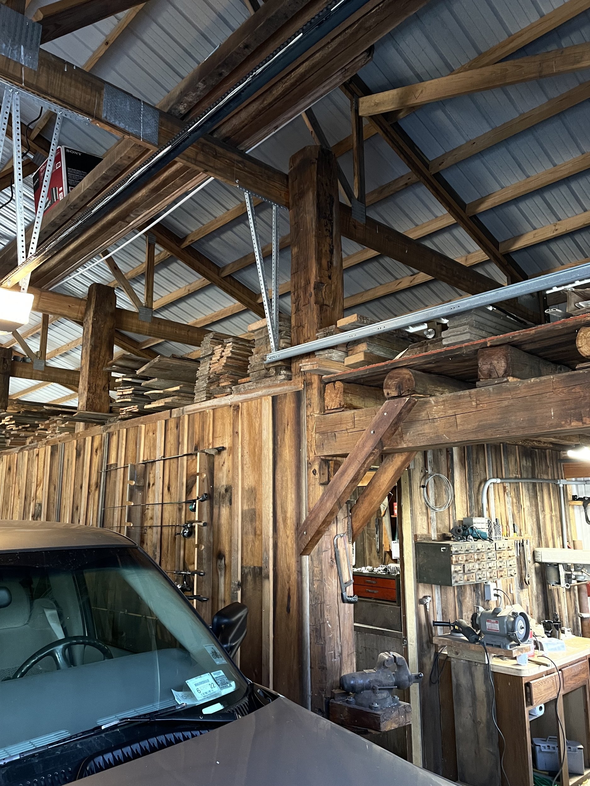

Sizing mine was pretty easy because it was a replacement for a couple of 36’ x 46’ x 16’ post and beam barns that my great great grandfather had put up in the 1880’s. Unfortunately, he had built them on poorly drained ground and the foundations and roofs were failing simultaneously.
I would have liked to have saved them for nostalgic reasons, but that would have cost several times more than putting up a new metal building.
I used to use one of those old barns, which had never been painted, mostly to store my firewood. During the tear down and new construction, I stacked my firewood outside on pallets, and covered the top with tarps. That was a major pain that I hope to never have to repeat.
High winds were tough on those tarps, and shoveling snow off of them to fetch wood in the winter was horrible. I had been spoiled by having my firewood in that old barn for so many years.
After clearing the firewood out of the back barn, I filled it with tractors and tools (after “thinning the herd” a little). Next, I dismantled the front barn to make room for the new one, saving all of the timbers and boards that were not rotted.
The new metal Stockade building pole barn I put up is 36’ x 50’ x 12’ with (2) 10 x 25’ porches. I used posts, beams, and boards salvaged from the old barns to build shops and a loft inside the new one, and a 24 face cord capacity woodshed behind the back porch.
I was planning on using that back porch for firewood storage, but they sent along a bunch of extra green metal cover sheets when they shipped the building from Ohio. I used that left over metal to roof the woodshed I built out back, using more recovered wood from the old barns. With the completion of that woodshed, I finally have plenty of shop space and covered storage.
I’m currently enclosing the back porch with more of that old recovered barnwood. By using so much of that old wood, I was able to keep the feel of my great grandads old barns, for just a fraction of the cost that it would have taken to repair them properly. The modern building is also one heck of a lot nicer to work in.

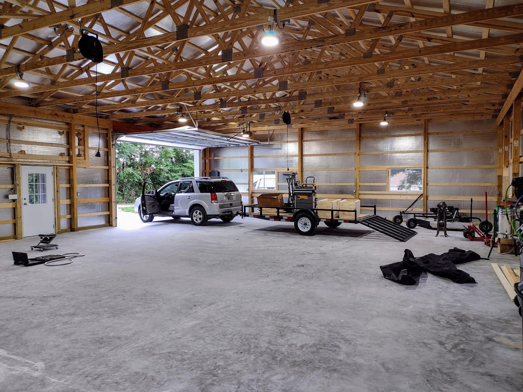

72” ZTR
12’ trailer
48hp CUT
Workbench
Saws
Dust collector
ATV
Trail mower
Cultipacker
ETC…
Wow! That is quite the setup bro!
We have a 48x48 and I would be embarrassed to show inside photos of mine!
