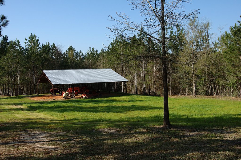

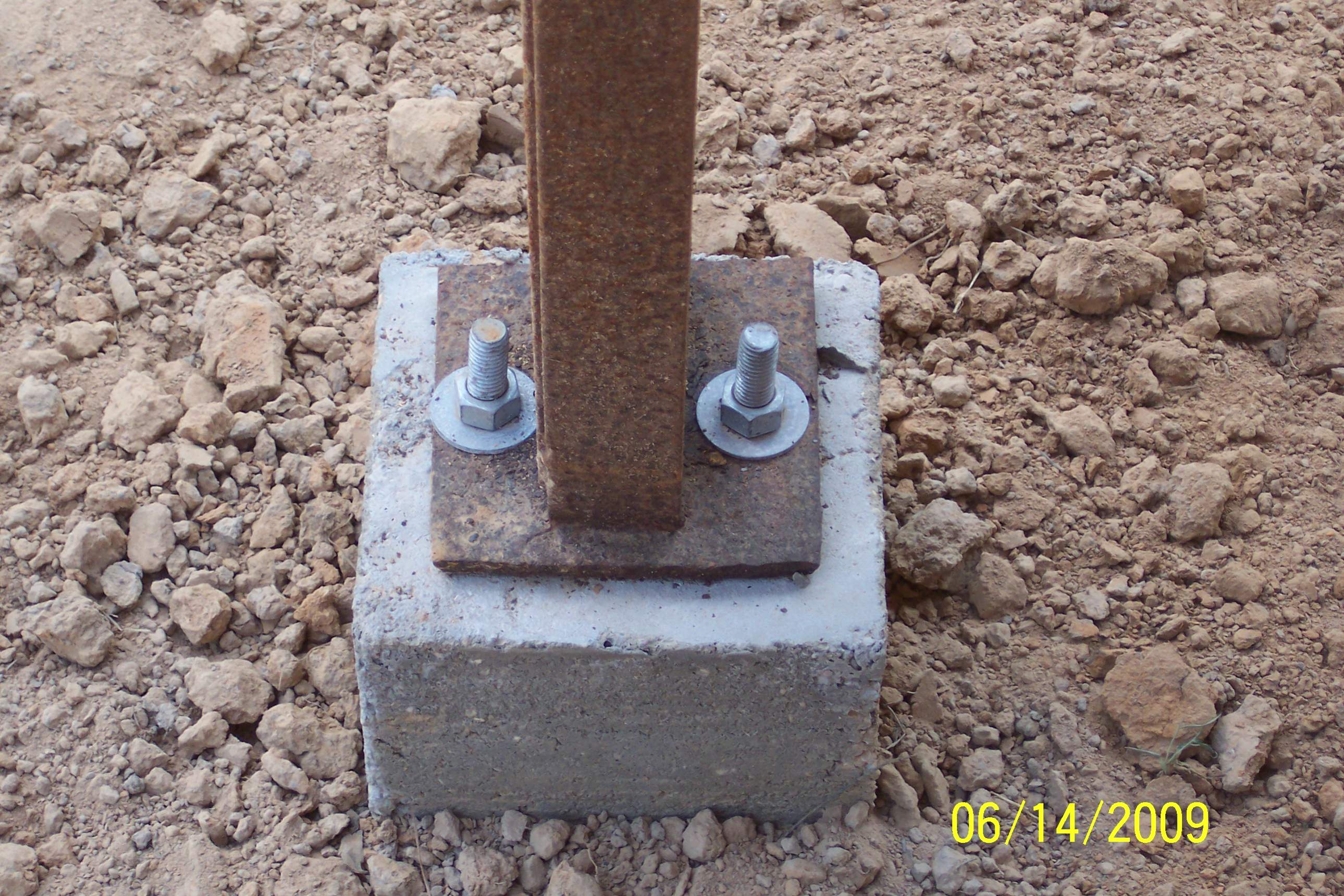

That's what I did, except I erected steel trusses instead of wood posts.
I used a 12 inch PHD to dig the hole for the pier (3 feet deep), then I used 2x6 lumber to build a 6x6 box with "arms" that spanned the hole. Sat the armed boxes over the holes, lined everything up with strings, then mixed and poured Quickcrete.

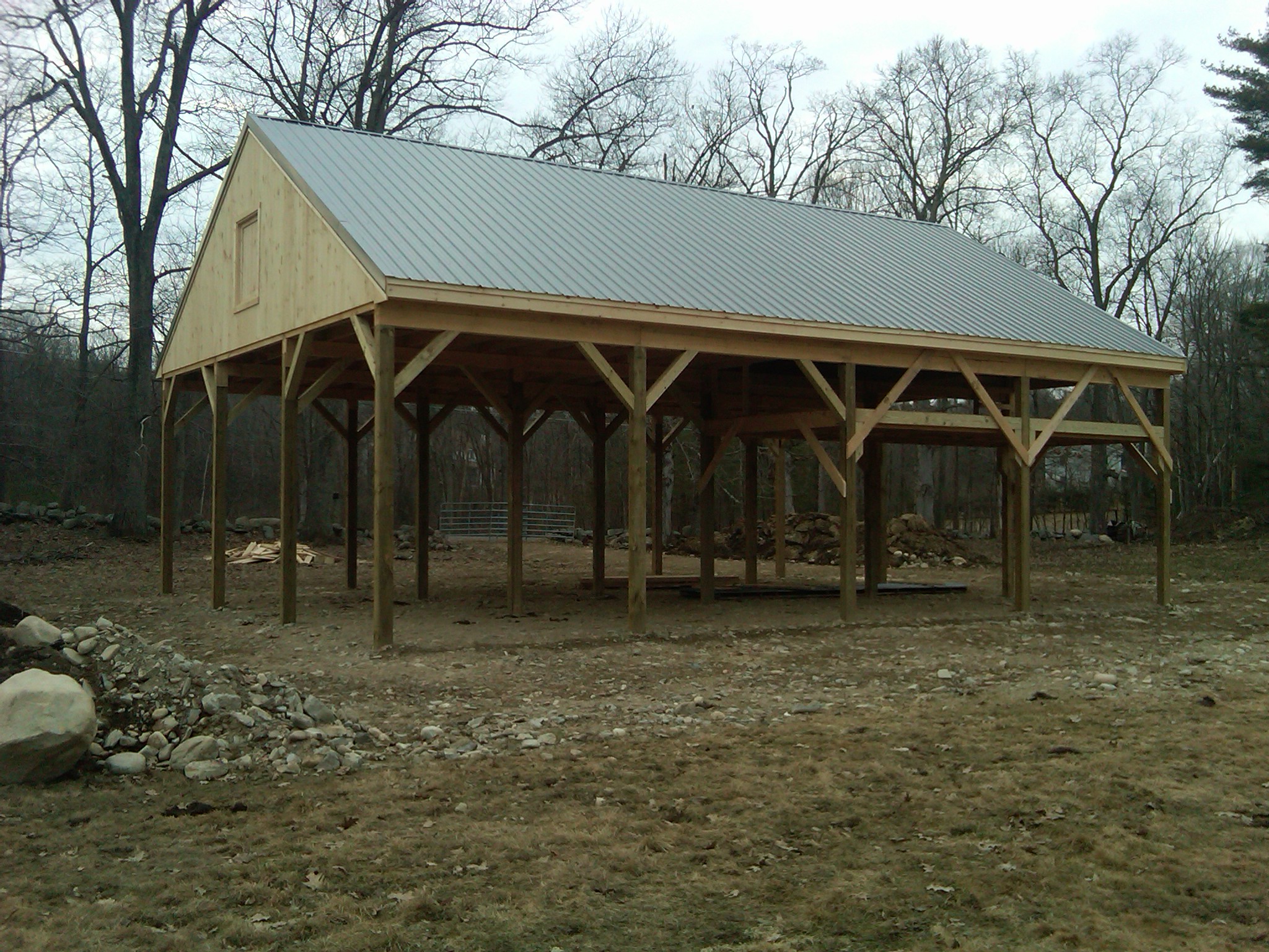

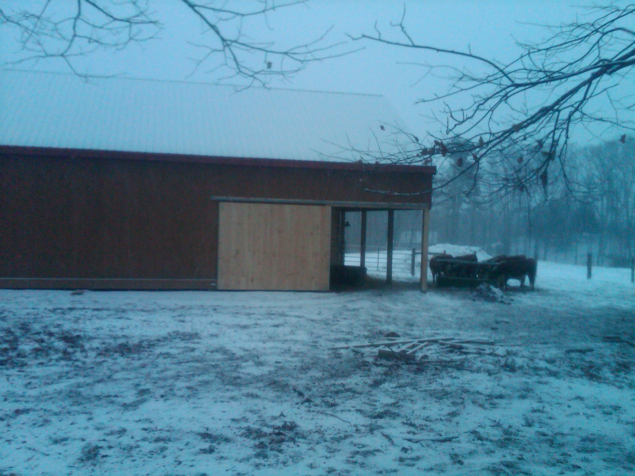

We built a 36x48 barn last year, went with the pole barn approach. A full foundation approach here would have added around $12K to the project for the foundation alone.
So we used 6x8 PT set on concrete "pads", set 4 feet underground, back filled with good draining material. Went with good quality metal roofing with enough pitch that there are no snow issues, snow slides right off. Went back and forth between using trusses or conventional rafters, finally opted for the rafters to gain some space.
We wanted a traditional looking barn, so we went with vertical pine siding. This was *not* an inexpensive building. I won't say what it cost, but I could have cut some corners and made it probably 30% less expensive than it was. But no regrets...
I thought I had some more pictures of it on this laptop, but here's one before the siding and doors, one with. (Got the doors on too late in the season to stain!)
