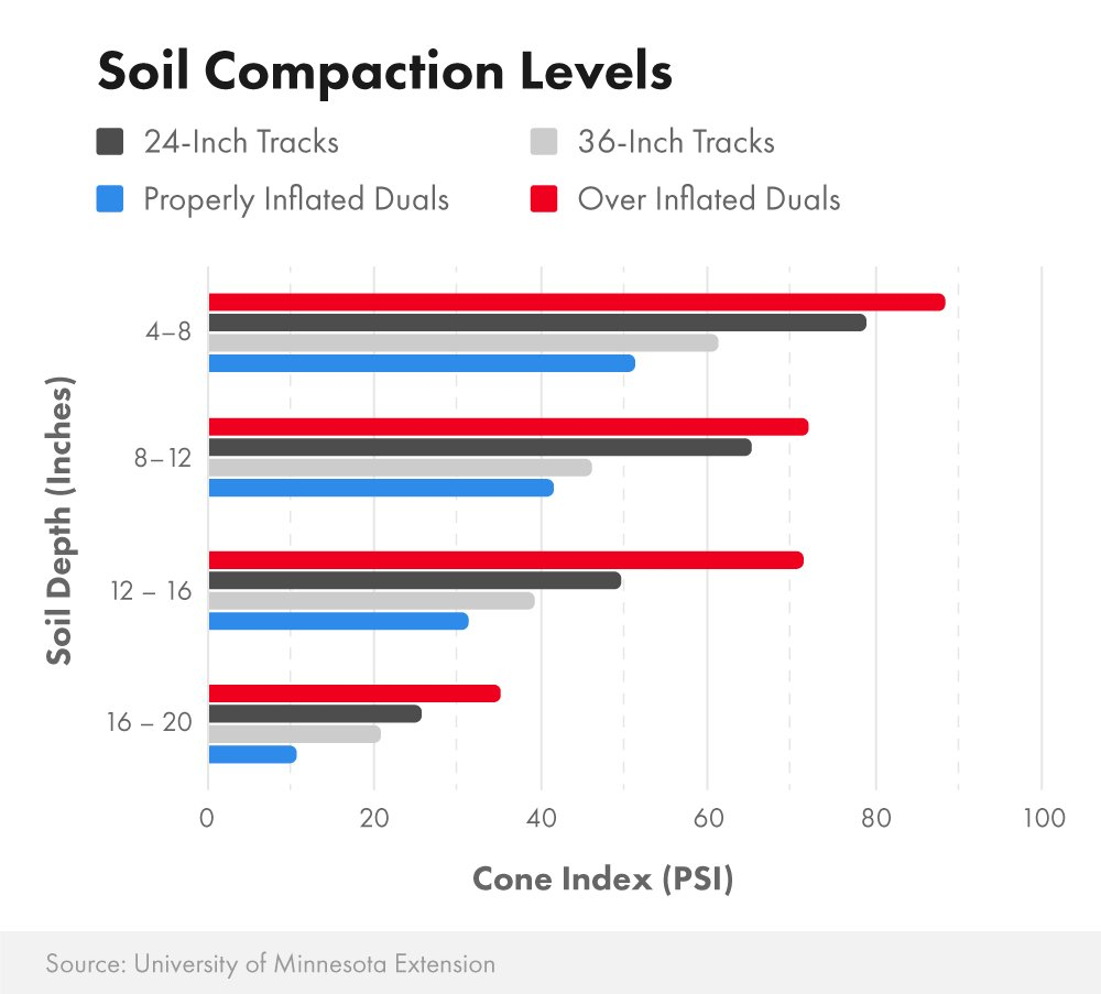

Why does everyone believe tracked skid steers are useless for compaction. I thought the same way, and found that reality to be much different than what I thought. We have a new subdivision going up near my home, about 225 new homes under construction, all in the 2500 to 3800sq-foot range. These have Concrete foundations on typically a 24" thick compacted select fill base. Foundation crews are using a New Holland tracked skid steer (24" tracks) for distribution and compaction of the select fill base. It is done by layers, with 3" to 4" thick fill being spread and compacted until the full 24" thick pad is completed.
I went online and found three university academic studies done on this very subject.
The attached picture shows compaction data for both tracked and wheeled skid steers, and also varying the layer thickness of fill material. It shows tracked skid steers outperformed wheeled skid steers with normal tire psi tire inflation of 45psi. Wheeled skid steers only out performed tracks, if the tires were over inflated to 65psi. As expected, compaction was better achieved with thin mutiple layers. Rather than trying to compacted a very thick single layer of fill.

Because they’ve never tried doing it. Sure a vibratory roller is better but a tracked skid steer with a bucket of dirt will compact as good as a tractor or any other off road vehicle will do.
