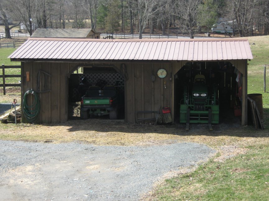

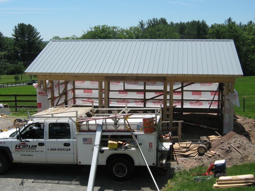

Getting ready for the the new pole building. Started yesterday tearing down the old 14x24 shed. New building is going to be 20X32.
Old...
IMG_0012_1.jpg I cannot believe how much stuff I have in this old shed, simple amazing.
   / Pole Building (Gizmo2) 20X32 #3
Old...
View attachment 207730 I cannot believe how much stuff I have in this old shed, simple amazing.
No room to keep shed and build new building?
Finished getting the old building down this morning, the wife is a real driver.:D

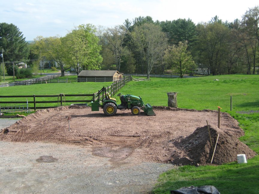

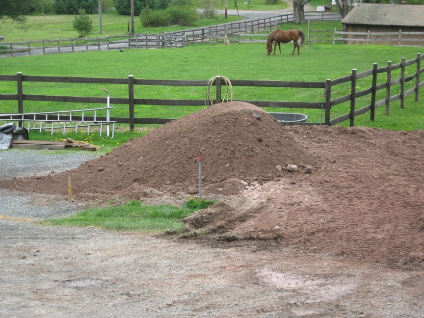

Added 72 yards of bank-run today. I have to hurry, trying to catch up to blueriver and his barn project.
   / Pole Building (Gizmo2) 20X32 #7
This is some nice looking stuff for bank run!
Yes, I was very pleased. Leveled off 72 yards of bank-run here and I never touched a shovel, got to love these compact tractors.

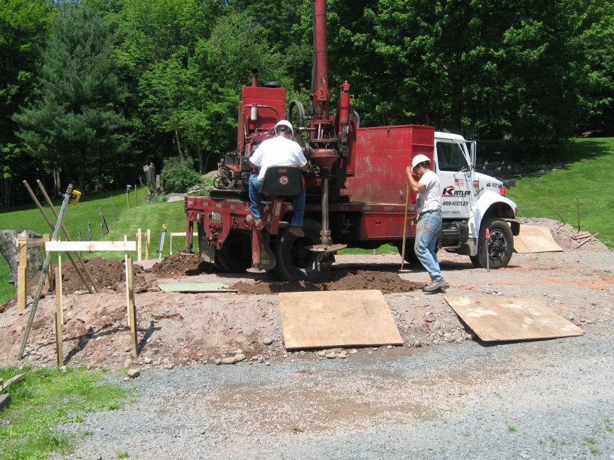

#9
Day 1

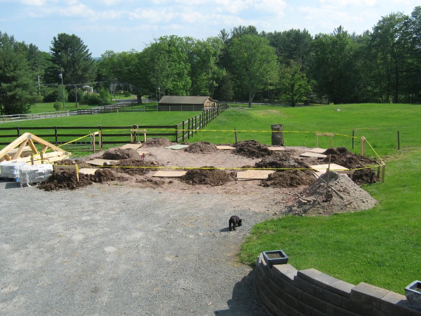

Brings a whole new meaning to gopher holes.
Even brought their own toilet.

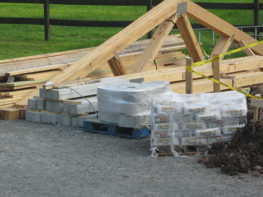

Two bags of Sakrete in each hole, then one biscuit of concrete 6" by 18" then the Perma column.
