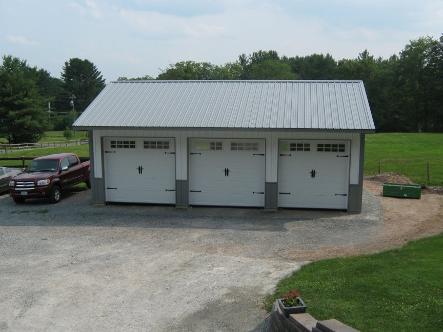

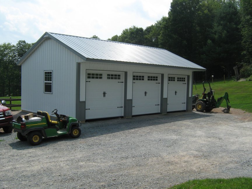

Doors are on. I will do the concrete in the spring.

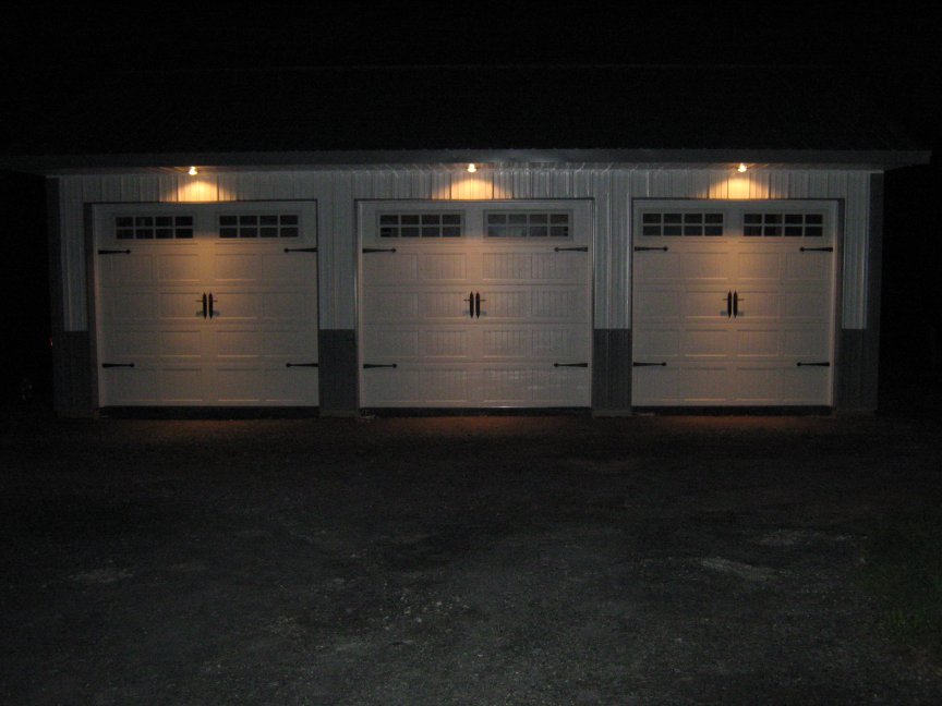

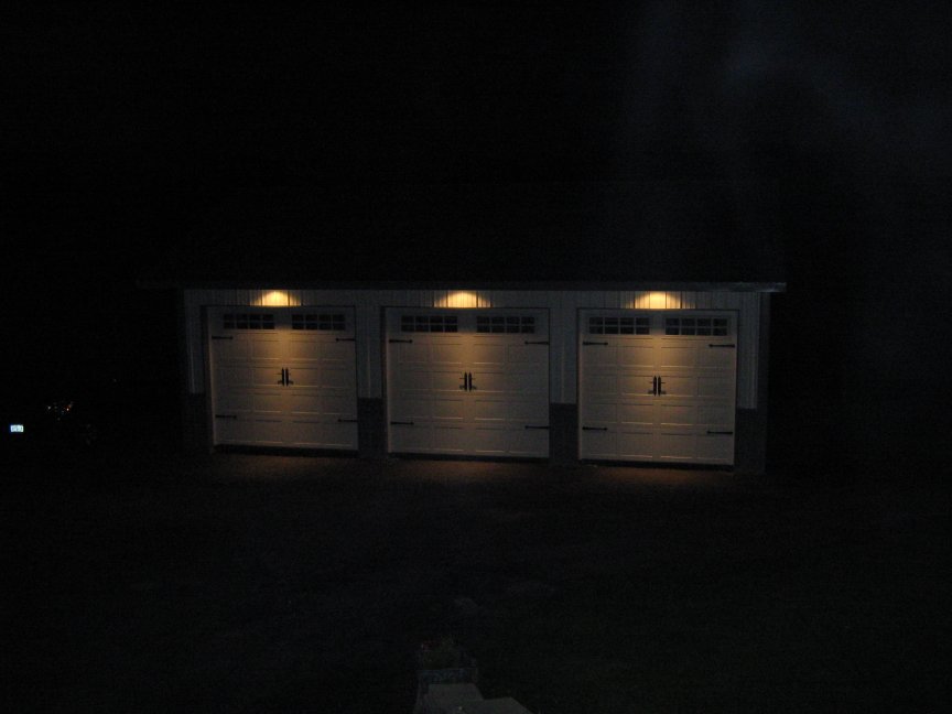

Lights are done inside and out.
