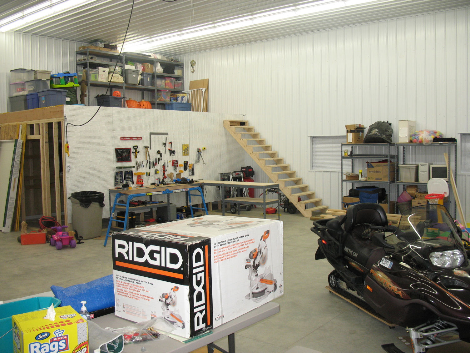

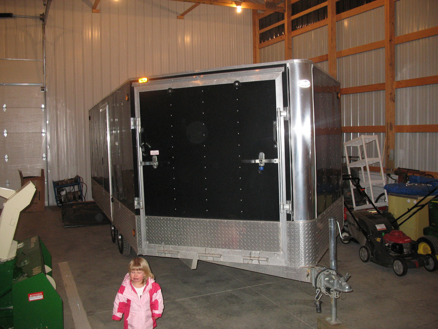

   / Pole Shed Project - Input Always Welcome
#20
I thought that I would give you an update as to how the building project was going. The process has slowed down now that I have been doing most of the inside finishing myself. I continue to work on the office and bathroom on the heated side (really has been nice with the in-floor heat this winter). As can be seen in the pics below, I also have a 125,000btu furnace in the corner to heat it up to 60 from 50 degrees when I am working in the shop. The tractor, snowmobile trailer, four-wheelers, boat, and mowers are all stored on the cold storage (unheated) side and it seems to be filling up fast. I enjoy everyones suggestions and would love to hear them from the readers. Here are a few updated photos.
Thanks,
DW
