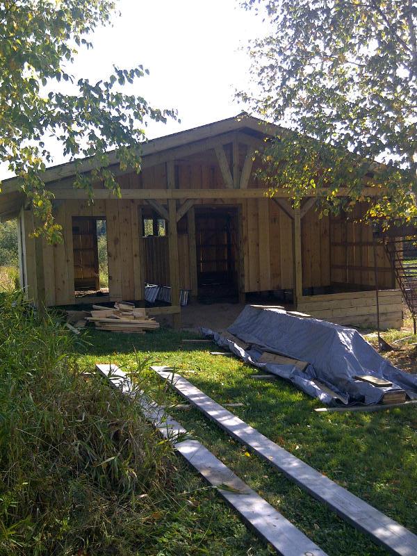

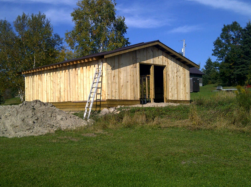

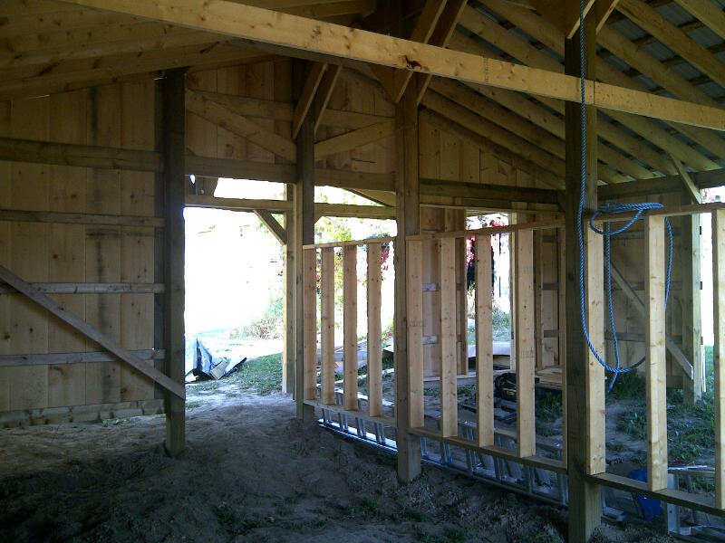

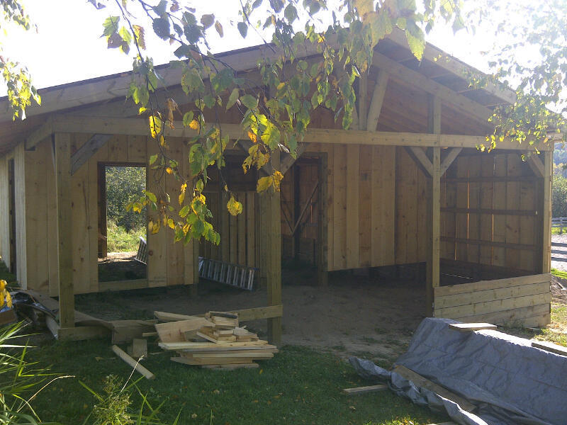

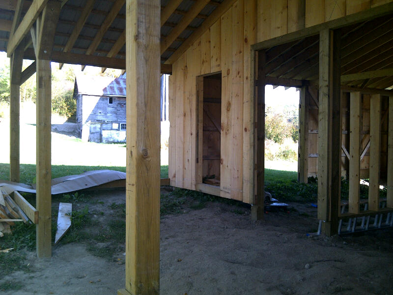

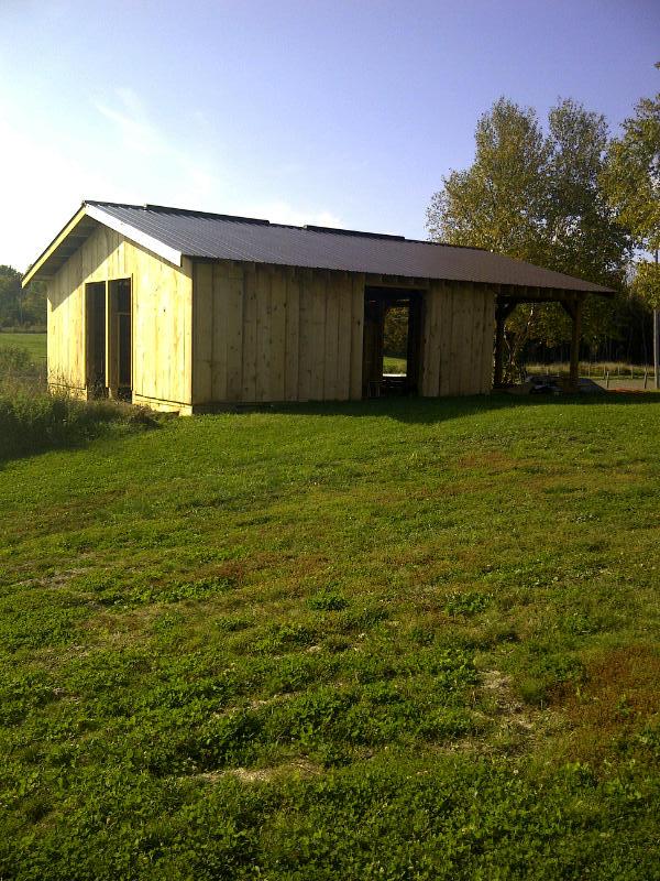

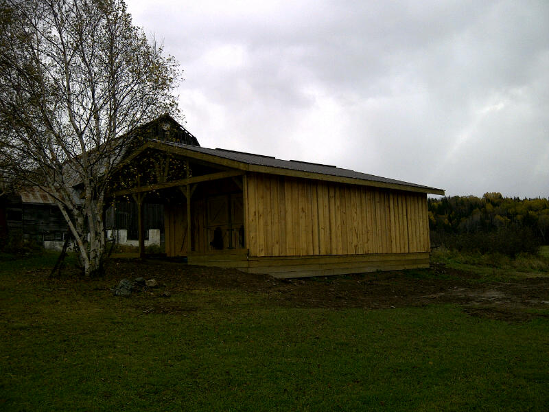

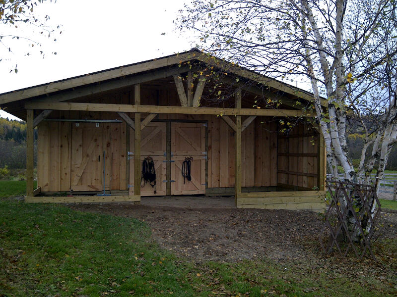

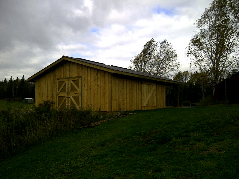

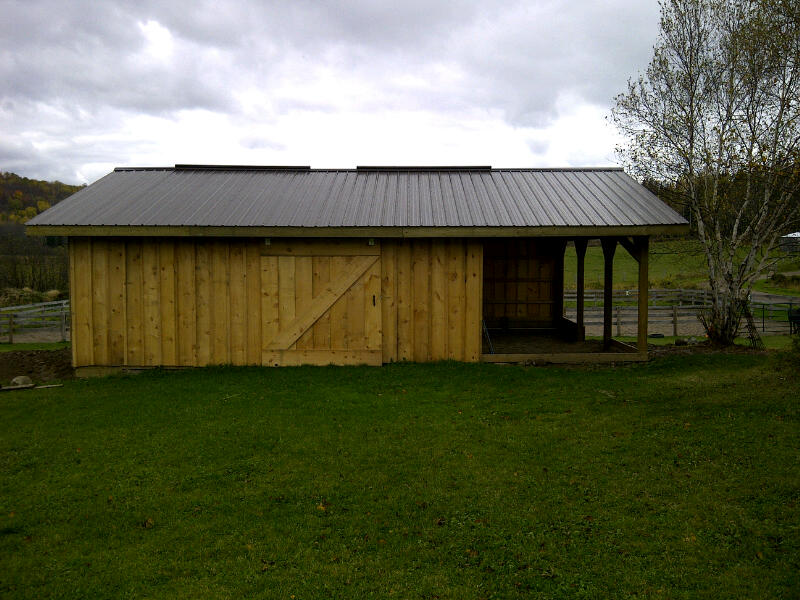

Here are some update pictures, the roofing is done and the siding is in progress. Boards are up but battons are still to be done.
Pic's 1, 4 and 6 show the portch, you'll see from the floorI still have a pile of dirt to put in the floor to level it (see pic 2 for the dirt I still have to transplant)
Pic 3 shows a bitof the inside and 5' divider wall (in progress)
Pics 2 and 5 give you a wider shot of the outside wall, and the 6' sliding doorway Im putting in the one side.

6x6 railing for Portch
Dirt/Foor leveling
Patio Stones for Portch
