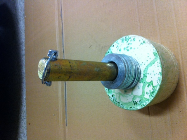

I had standard steel skid shoes for my Frontier Front Blade that I use for snow plowing. I plow mostly over finished concrete or asphalt and don't want to scare either. So I took my steel skid shoes and coated them with polyurethane. See Picture attached.
I found a small bucket to use as a mold. I have approx 1.5" on the bottom, 1/2" around the sides and an inch on the top of the shoe itself. Doing it myself cost about 1/3 of the cost to have it done professionally if you can find anyone to do a small one off job.
I decided this was better than a wheel or the steel shoe. It should last several years. I will be trying out next week after it fully cures.

Yes you're correct they (Falline) will do it and after I looked at that option I decided to do it myself for 1/3rd the cost or less. It was easy to do. Main thing was figuring out a mold and with a little thought I came up with an easy solution.

Beings you used a small bucket, I take the lower edge is somewhat rounded off ?

Not exactly but not sure that it mattered as I used a liquid PVA release spray that kept it from sticking to the mold.

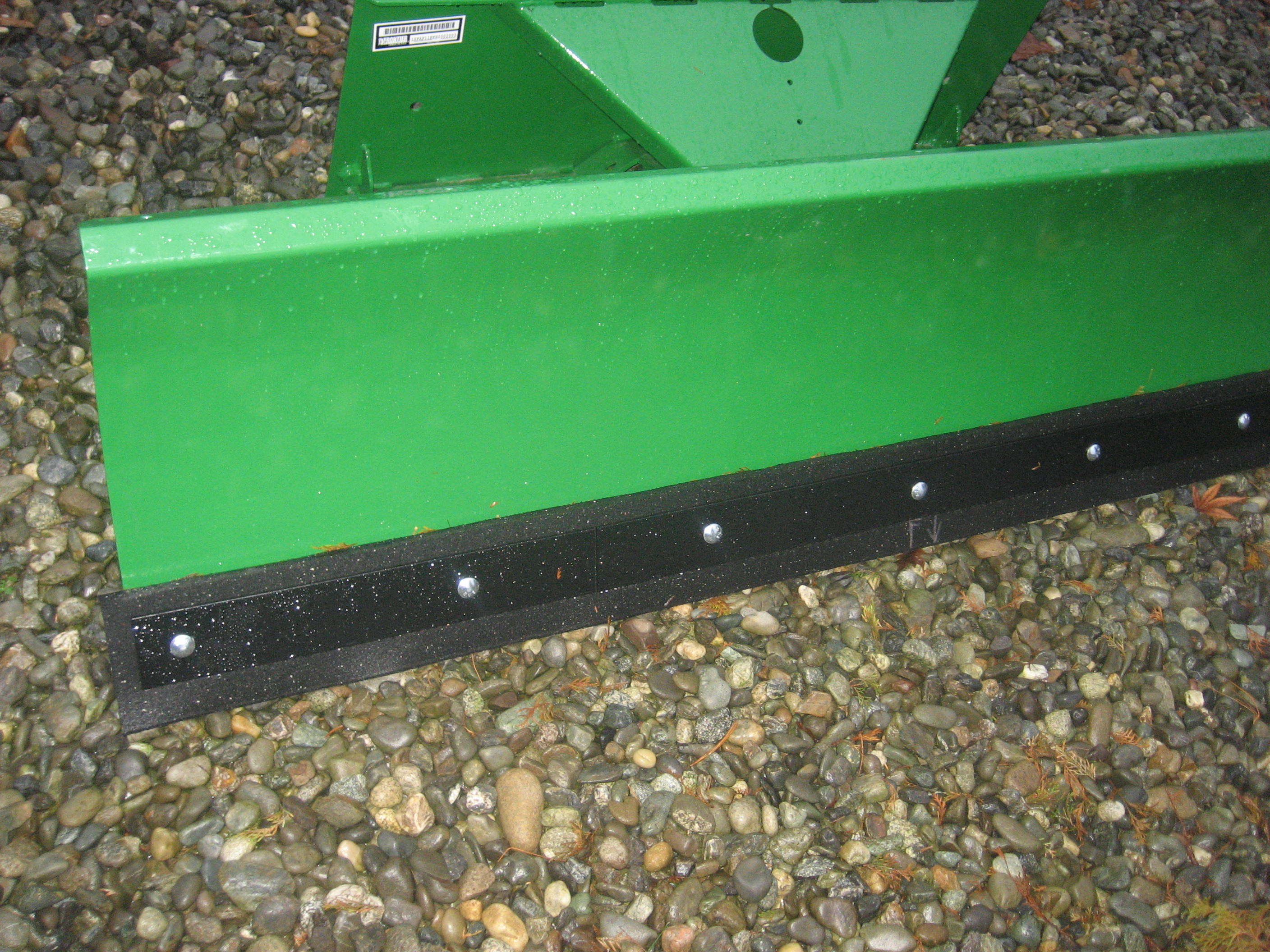

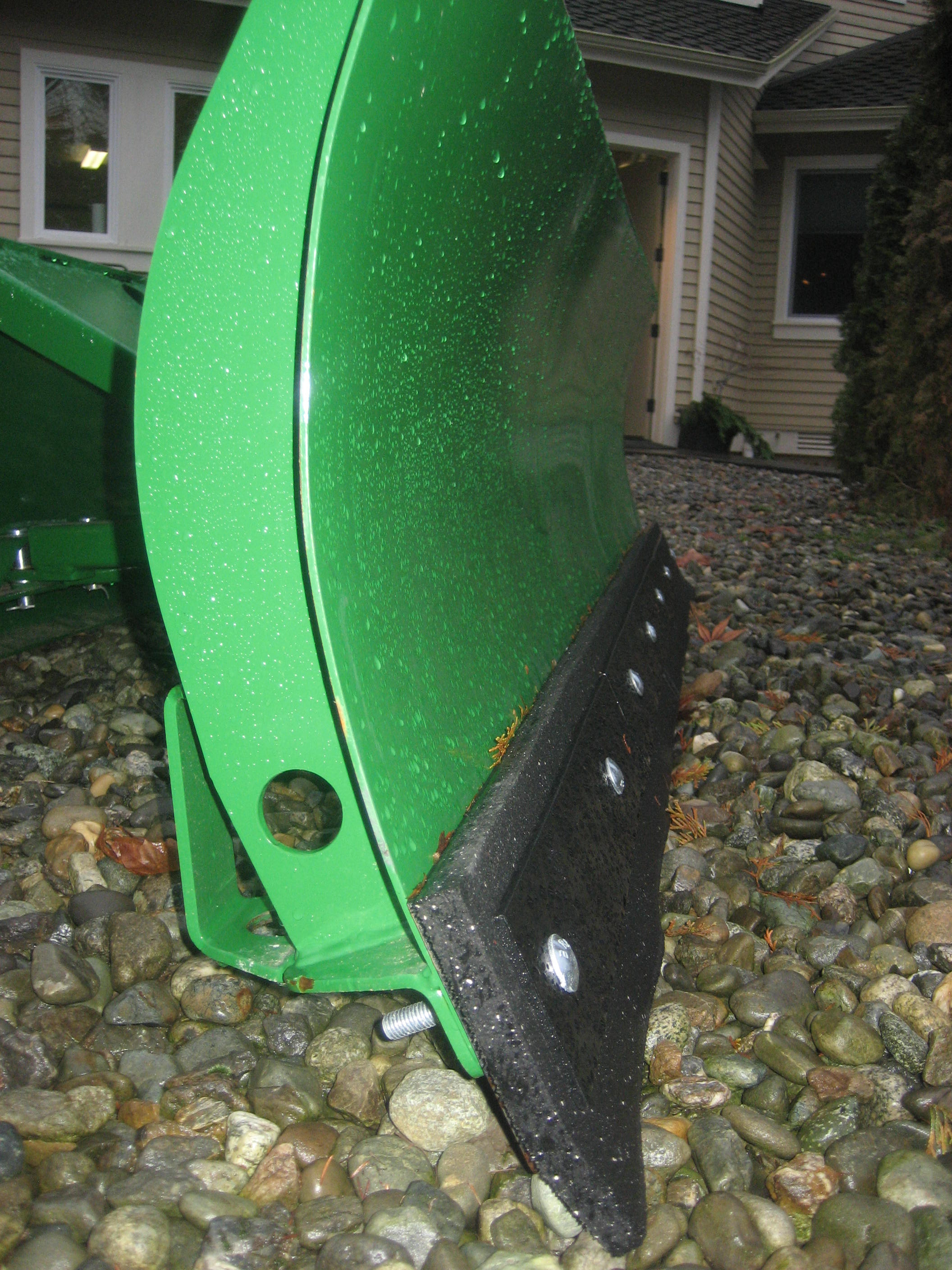

For a cutting edge, I took a barn mat and cut a six inch piece and bolted it to the steel cutting blade. It hangs below the steel blade by more than an inch. I also used a 1/8th inch steel plate over top it to maintain the strength of the rubber edge. If interested, I could attach a picture.
You use a rubber edge then? Hmmm your making me wonder. if you could attach a picture. We had it done for a skidloader bucket edge to protect a color topped sidewalk

Here are a couple of pictures of the front blade rubber edge that I made from a barn mat. Behind the rubber blade is the steel blade that doesn't show up. I left that on and extended the rubber about 1.5" below the steel. The steel gives it support. Then on top of the rubber is 1/8" steel to hold the rubber to the back plate.
If you want more information on anything let me know.

What kind of polyurethane did you use for the snow plow skids . How did it work out ?

The polyurethane worked out very well for me. If you go back to the top of the posting, you can see the original photo of the project. It has lasted me several years. I am replacing the polyurethane for the first time. I do not recall the type or brand of polyurethane that was used initially so I am looking into that now. I hope this is helpful to others.

Okay, I figured out what I had used the first time around and plan to use TAP Quik-Cast Polyurethane Casting Resin System. It will take about 16oz per skid shoe. I will post a picture once I do the pour.
