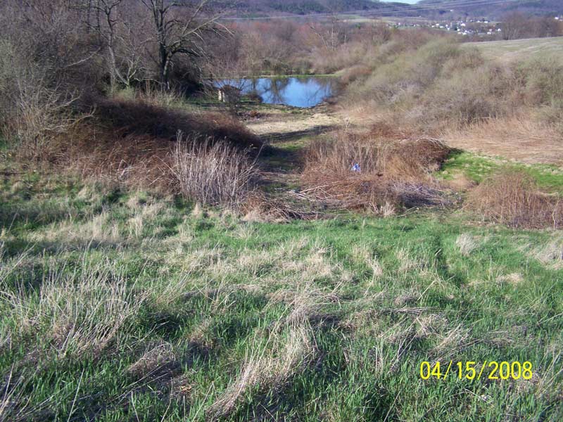

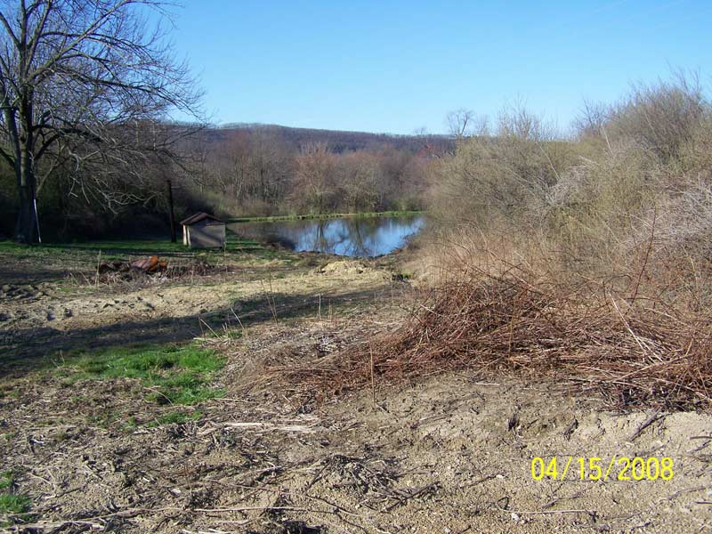

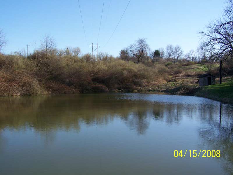

Now that I've got about 100 hours seat time on my new tractor I'm ready to tackle a project I've been wanting to do since I was 15 years old..(I'm 35 now...) My parents own about 35 acres. Most of it is leased to a local farmer for crops but in the middle is a hollow with 2 dams that have been there for about 50 years. Years ago we stocked both with sun fish and large mouth bass. The lower dam is now producing some really nice fishing. The majority of the bass range from 7 to 18 inches with a couple of whoppers in the 21+ range. Everything in the upper dam (pictures) has died off except for the sunnies. I think several factors are involved. It's pretty small but I think the main reason is someone put 5 carp in there years ago and they just create muddy water and low oxygen levels.
So I want to do something but I have a couple of options. Looking at the pictures, would it be best to dig down, expanding the dam, or would it be best just to create a new breast and make a third dam. The 2nd option is obviously a lot easier but when I'm done, I still have a useless dam. I like the idea of expanding, but I realize I have a enormous amount of dirt to remove with a 27 hp tractor with a 50 in bucket. Either way, I want a huge body of water and as deep as I can get it. I would like to shoot for the 15 foot range.
The surrounding area is perfect for any option. Natural springs keep water flowing pretty well and it's all clay underneath. I really want the ability to grow some enormous fish when I'm done. I'm considering walleye and stripped bass hybrid for this pond with minnows as the baitfish.
So what would you guys do?

If you do this, you need to realize that it's going to be 100 times bigger, harder and more expensive then you think it will be. Are you the type who finishes what you start? If so, go for it!!!
When I dug my small 3/4 acre pond, all I had was my backhoe. It has a one yard bucket, which helped, but it's also 2wd, which was a challenge. It was a mudhole that was holding water up to 2ft deep in areas, but mostly it just dried out except for a few areas. When I got the backhoe in there, I sunk. The silt was hard to walk on, hard to drive my truck across, but too soft to support my backho. It was a nightmare that took all day to get out of. I wasn't stuck, but I was severly delayed.
Something like this should be done to the extreme. Go all out and make it like you've dreamed of it looking like. Any shortcuts that you take will just be something that will bother you down the road. The only reason for shortcuts is to save time and money. If you are not prepared to put both into it, don't do anything.
Hiring it out is always a nice option, but probably extremly expensive and cost prohibitive. I know that I could never afford to have hired either of my ponds out. My large pond took me two years to dig and cost me more money and time then I thought possible. Somehow, I came up with what I needed to keep it going and in the end, I have a pond much better then I had hoped for.
Do it right and you will create something that you will be proud of the rest of your life. Do it wrong and you have .....

Not to rain on your parade, but Eddie has the proper equipment to build a pond. Dump truck, Dozier, Backhoe. I don't think a small CUT will suffice. A 40,000# dozier will move and pack the dirt a whole lot better.
400-600 gallons of diesel a month!! That's $1600-$2400 a month for fuel alone. No wonder the guy that built our pond got $85.00 an hour for a dozier, and $100.00 an hour for an excavator. Of course he built it in no time (1 acre 6-8' deep) and it only cost about $8000.
He hauled in 40 tandem dump trucks of clay to build the core. Used a CAT loader with a 6' bucket to dig the core to solid rock, mixed the clay with dirt on site, spread with the loader in 6" lifts, and packed the clay in the core with a vibrating packer.
We had the worst drought in 100 years last summer and I only lost about 4' of water to evaporation. Most of the ponds around us went dry. I did put in a aerator to keep the oxygen level up, but had no problem with fish dying.
When I asked if he would guarantee it not to leak, he said, "If it does leak that's the worst advertising I can get, so I will build it right to start with". As far as I'm concerned he did.
Me neighbor has a pond that's about 2 acres. It doesn't have a properly constructed dam (no core) and it will go dry in about 2 weeks after the rains stop in the spring. Nothing looks as bad as a big empty hole growing weeds. IMHO anyway.

Its hard for me to make a recommendation from the pictures alone, but from what I can see I think I would go with your "create a new dam" option.
I love your DIY attitude, but have to warn you that w/27 hp tractor as your equipment it is going to take you a long time, a really long time to do this project. To kind of get a handle on it, calculate the number of cubic yards of dirt you will have to move and then calculate how long it will take you on your tractor to do 1 cu. yard of dirt....your tractor time should be measured operating in clay to be realistic.
If you are still standing after you see that number of how long it will take, then maybe you can pull it off. I built my first pond at 10 years of age using a hand guided sled pulled by a poppin Johny...I was on the sled, my dad on the Johnny. It can be done, but it is a serious undertaking.
Soil compaction probably won't be an issue because you are going to make so many trips over that ground with your tractor and bucket. A tractor with a load of dirt actually gives more compaction (in the tire tracks) than small dozers. Time is going to be one of your biggest issues I think.
I really think you should consider renting a small dozer on occasions to dig material. Use the dozer to dig out a huge pile of dirt and then later on move the dirt, one bucket at a time with your tractor. I built a beautiful 2 acre pond that exact way just a few years ago....except I bought the small dozer instead of renting it. Even with the assistance of a small dozer it took me several months to complete that project.
Do your homework and make sure you know what you are up against before you ever turn the first dirt....that way you will know what lies ahead.
