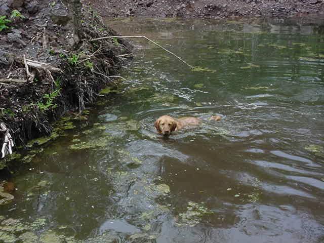

Iww - I'd loan you my "Live Areator" if your pond was closer. /forums/images/graemlins/grin.gif
penokee /forums/images/graemlins/smile.gif /forums/images/graemlins/smile.gif
Ps: For some unknown reason, all the floating algae shown in the picture disappeared in approx. 8 weeks. Only thing I did was dump in 12 dozen crappie minnows.

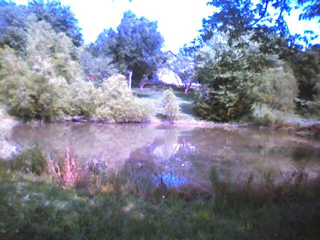

What happens if you don't aerate it? Does it start to grow scum then? Mine drops a lot of water in hot weather, but it never seems to get anything floating on top, always stays "clean", don't have a clue what I might be doing right (or wrong!)

The pond is doing pretty well with the exception of losing water, I think mostly from evaporation. The catfish are fine along with the zillions of bream. We always started up some type of aeration for the hot months just to up the odds for not losing any fish. No surface scum. The water is about the same color as yours. We pump water into it from a springfed creek
