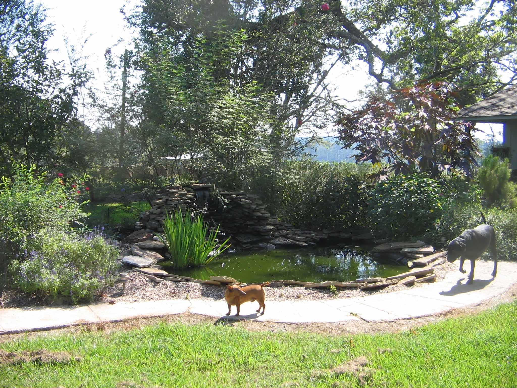

But I was wondering if you had any info/pics (besides the couple you show on your site) on your "micro-pond" you made?
   / Pond Building in East Texas
ldaba,
The micro-pond was born out of a hole left in the ground by a tree that was uprooted during Hurricane Rita. I used my back-hoe to shape it into a 1500 gallon pond, lined with a pond liner, and added the waterfall for aeration/appearance. We really enjoy the little pond, but are always fighting algae in it. Here is a recent picture of it:
