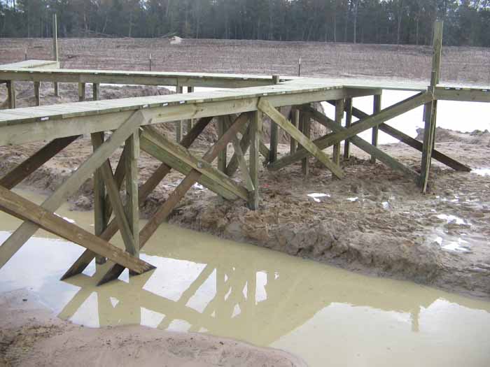

...The other parts of the structure have no wobble, just the "tall posts region" so I think it will be ok without the bracing?
ML,
Remember that in time, it will NOT get stiffer. If you decide not to brace part of it, the odds are that it will get weaker over time and it will be allot more dificutl to brace it then, rather then now.
Saying that, and not actually being there, you can create sections that are heavily braced that will support areas that are not braced at all. This is how allot of decks are built. The house and ledger board keep the deck stiff without any bracing to a certain degree. If you created areas that were maxed out with X bracing, then in theory, the areas next to it would be supported by that strong area. This is what an engineer is paid to do, and not what I'm qualified, or capable of doing. Especially from just the pictures I've seen.
For X bracing, put one board on one side of the posts and the other board on the other side of the post. There is no need to tie the two cross board together with each other. It's the triangle that's giving you all the strength and locking it together.
I'm thinking that with the length of your pier, and it's height, I'd X brace every other pair of posts to stop any side to side movement. I don't think you need to do every set, but I'm not there and you'll have to decide how much movement you have. Any movement now, means more movement in the future. Something this amazing needs to be done right. I just hope you have the time with those storms on the way.
You might want to pre drill a pair of holes on the lower posts at water level and then if you have to, you can bolt on your bracing under water with a pair of wrenches. Two 5/16 galvanized carriage bolts would be more then strong enough.

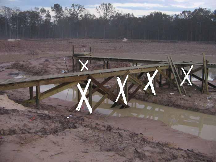

I put up the bracing in the critical areas today between showers. No question, the X bracing helped greatly, but in the one tall posts area, I'm still not satisfied. My requirements are probably tighter than most because of the fly fishing...on each cast the body weight is shifted from back to front in a rocking motion and that means no wobble in the walkway is a requirement.
All other areas are rock solid, no wobble. I put bracing on the piers areas and mid-way on each walkway and it is all rock solid.

Here's the bracing on the critical area. Thanks again for the tips.

ML,
Nice job on the bracing.
You got it solid going lengthwise but you didn't put on any bracing going sideways.
I added a few X's to your latest picture to show what I mean. I think this is what is giving you the wobbles.
Eddie

You're the master....added the inside X bracing and it solved the problem. It is all solid through and through. I think I will do as you and Tim suggested and add bracing on parts of the other long runs for insurance, but first I need to make a lumber run for some more 10 foot boards.
My thanks to you and Tim for your insightful comments. I got trapped by the other two piers I had built which did not need any bracing at all....but they were 1/10 the size of this one.
See the added inside X bracing below as well as the almost finished product.

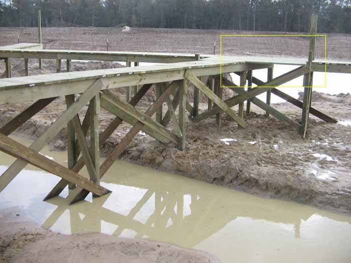

Meadowlark, Awesome Job!! There is one area that concerns me from looking at the photos. I have high lighted it below. I do not see any stringers under the decking. I think this area will get progressively springy as time comes. You may want to consider framing up under this area if you haven't already.
   / Pond Building in East Texas
#27
Tim,
Good observation. That is the place where a 5x8 pier ties into walkways going west and on the other end going east. The area you noted has a span of 4 feet from stringer to stringer and the posts are cross braced. If it ever stops raining, I'll add something and I also want to add the rest of the bracing.
