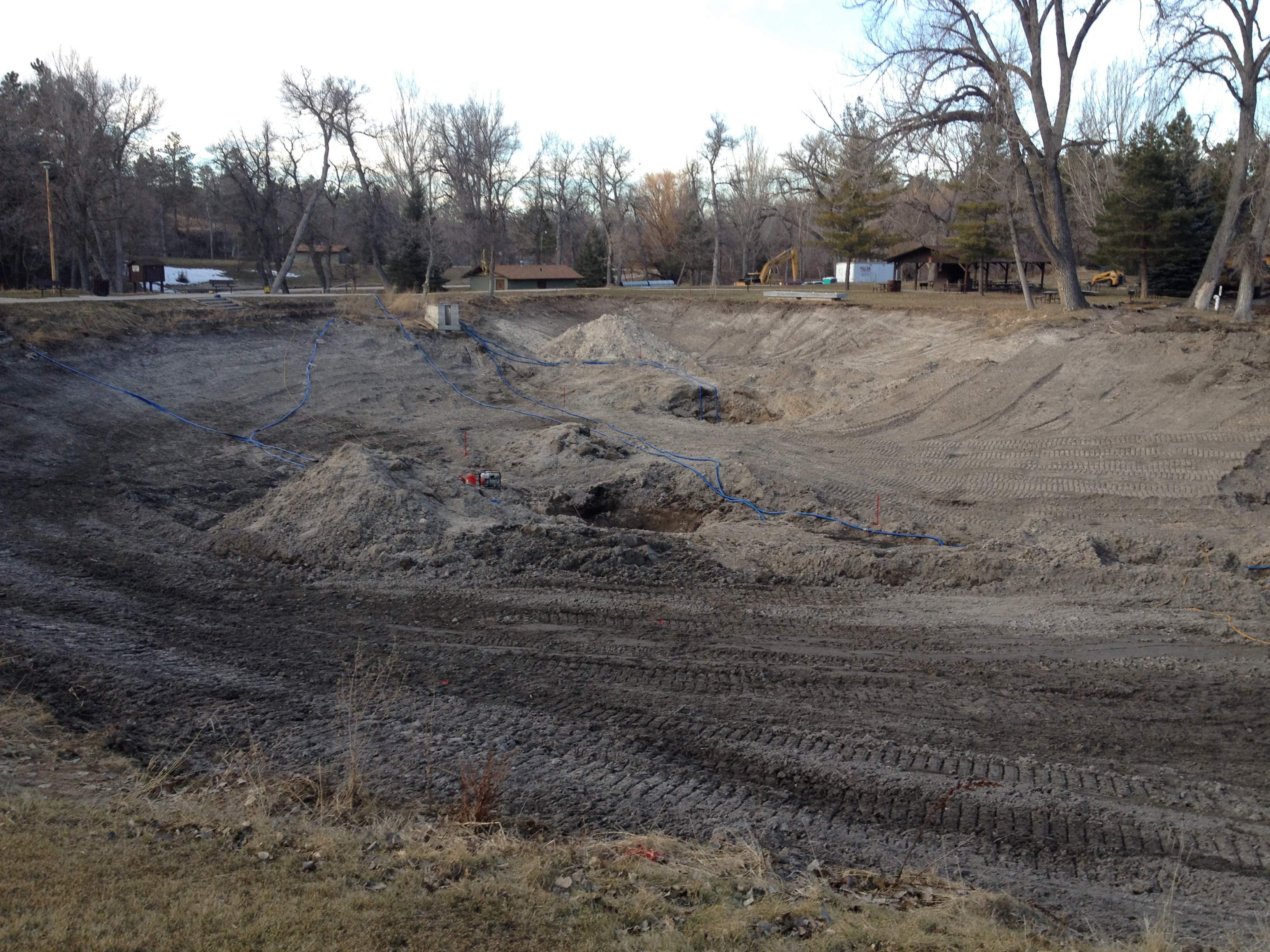

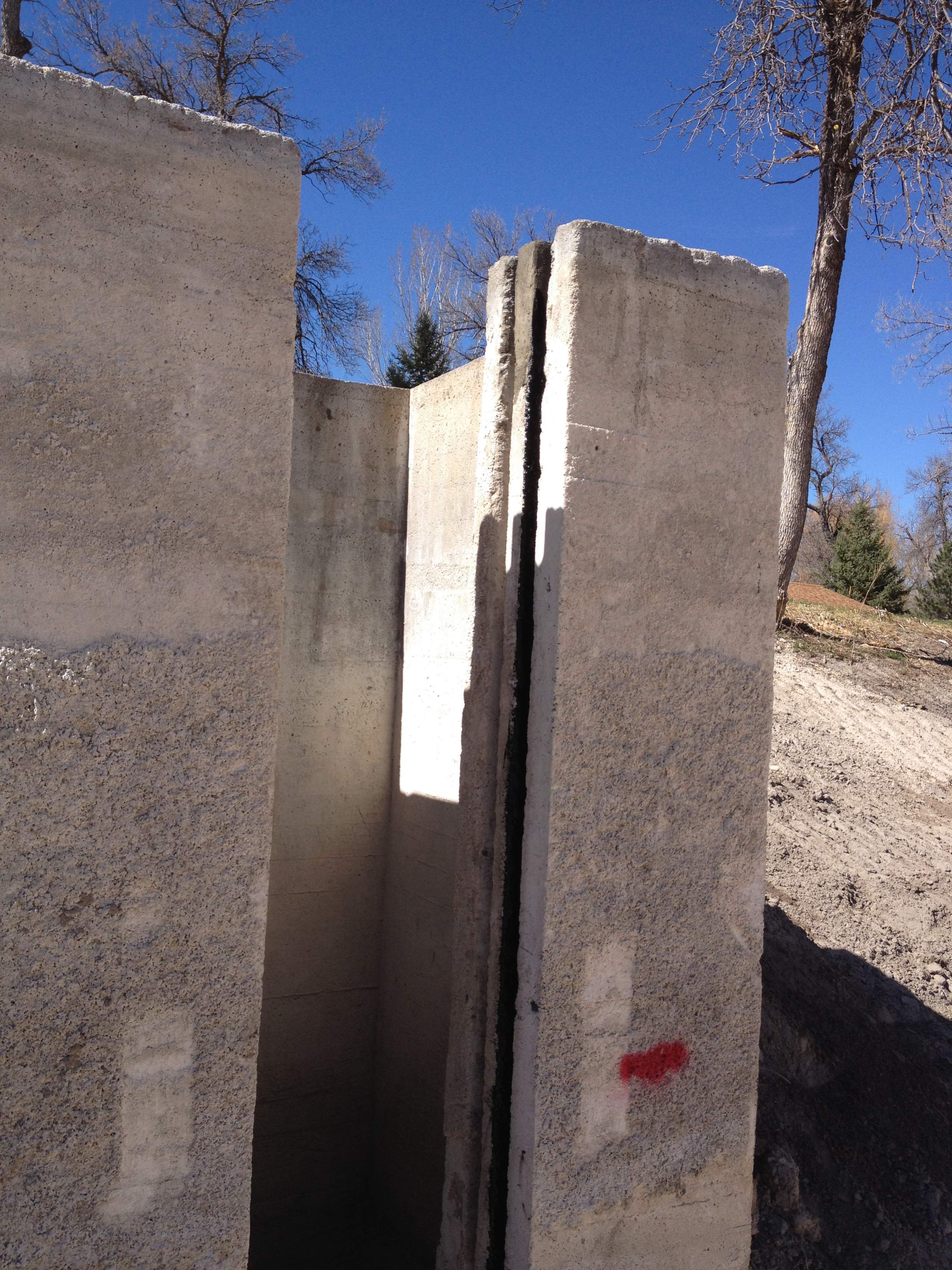

Here is a water control structure on a project I just finished up at Chadron St Park. They used a concrete outlet structure with stop logs.
More detail

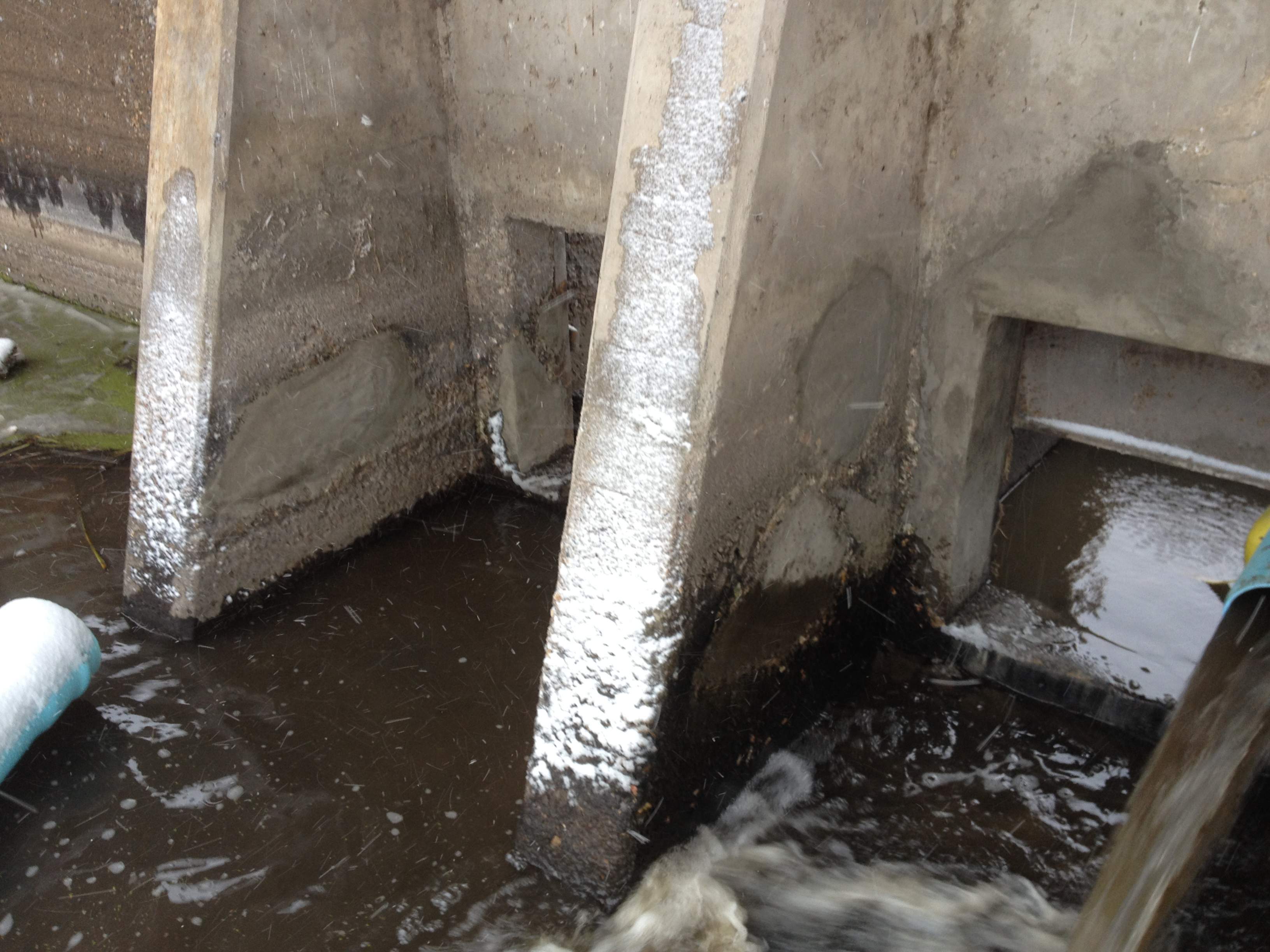

Now the water is up to about 6 inches below the top of the concrete structure and the owner built a expanded metal guard over the top and front to keep debris out.

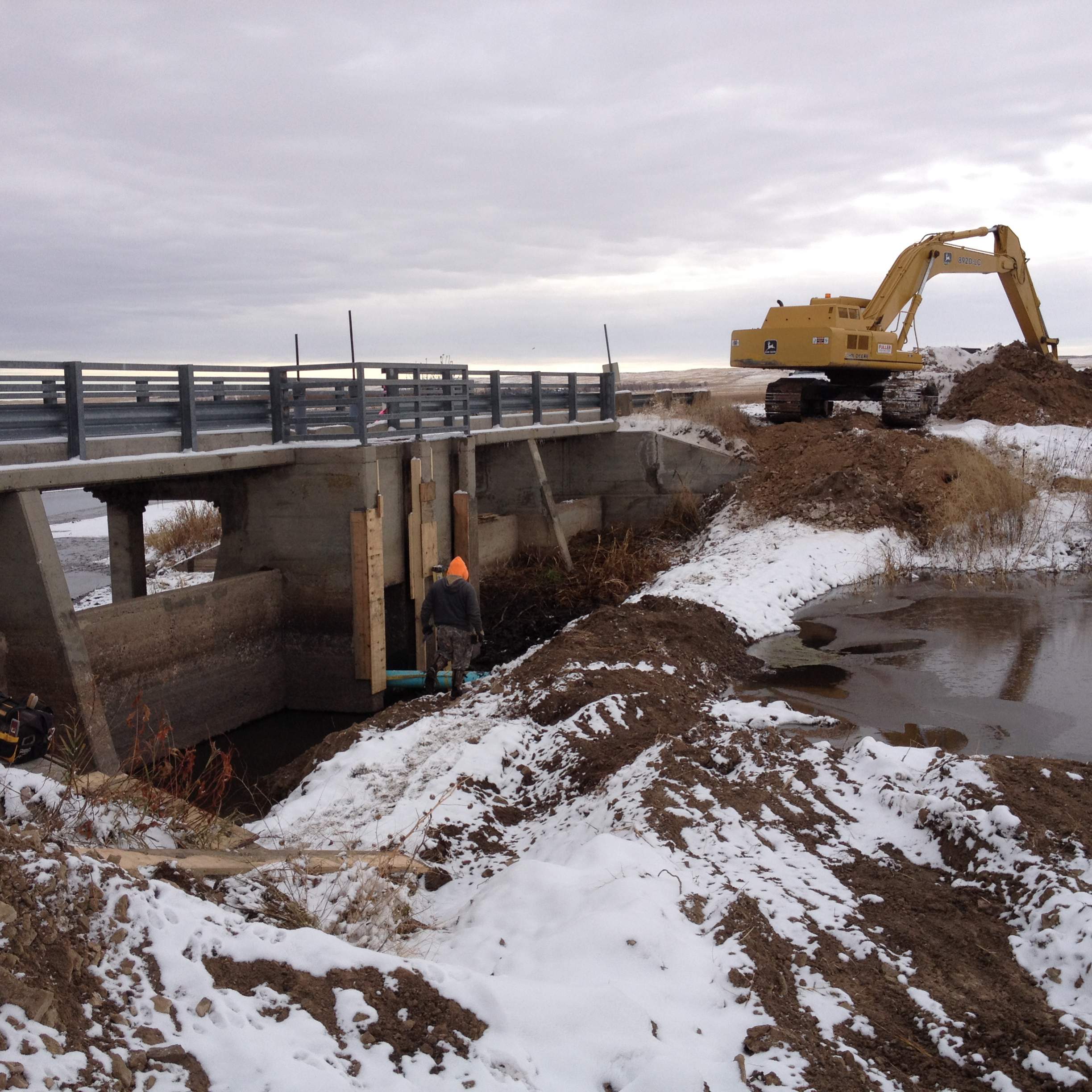

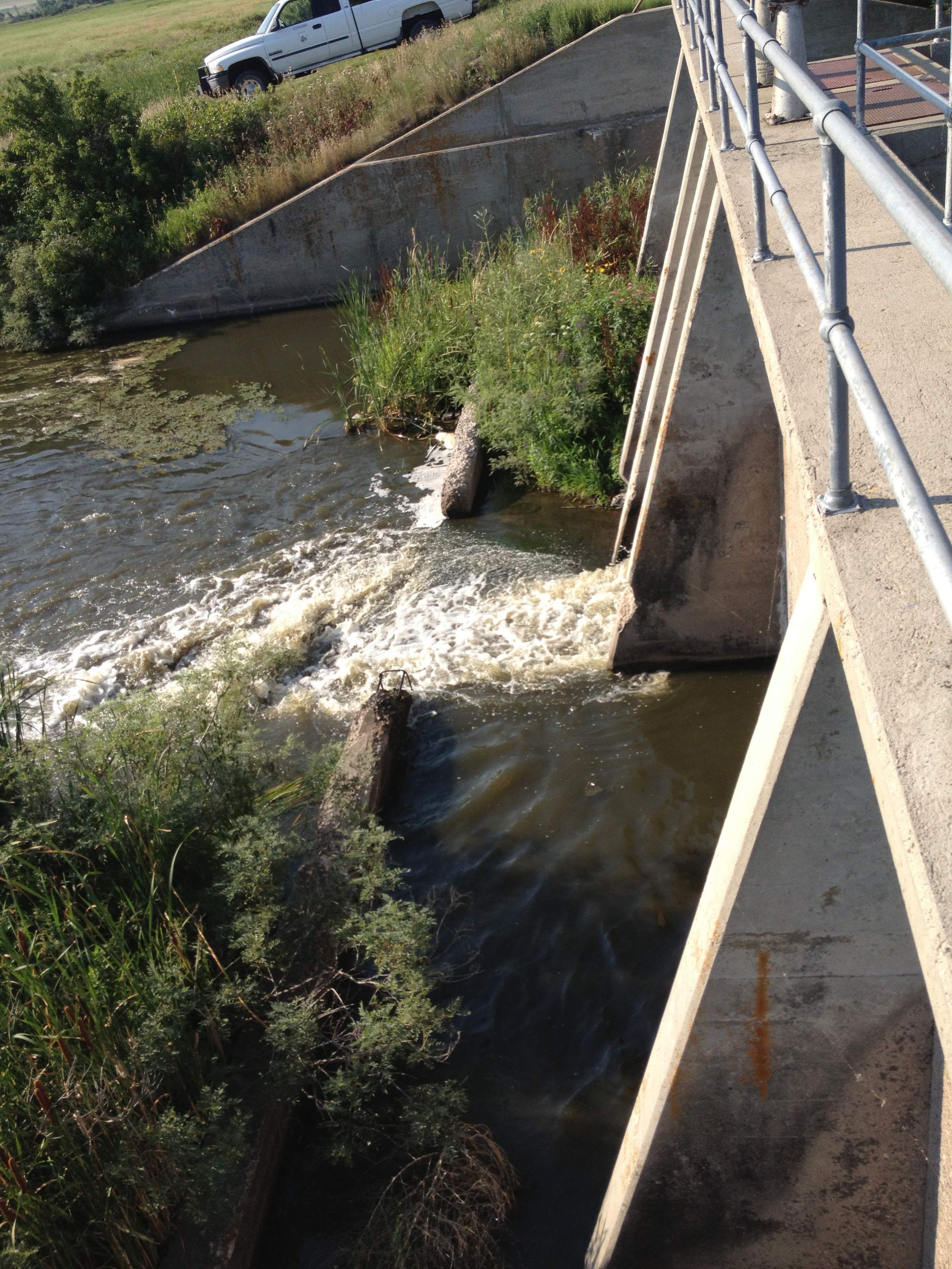

Some others from LaCreek NWR. They use gates.
