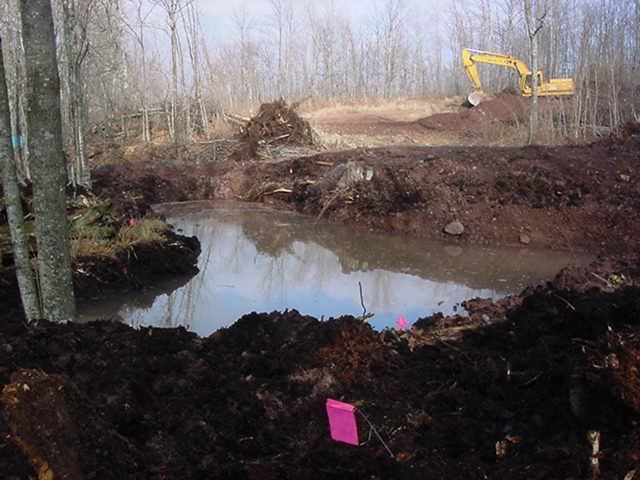

First picture is of a pond I had dug last Fall, just before snowfall. Have to dress it up and seed this spring. It's spring fed, so plan to plant some Rainbow Trout for the Grandkids to catch.

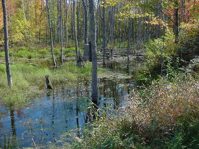

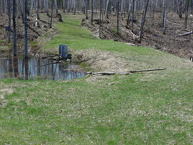

2nd and 3rd pics are of a "Wildlife Impondment I built several years ago". Received a Grant for 50% of the costs, but had so many permits and Government types involved it was unbelievable - all just so a couple of Mallards and/or Woodducks could do their reproduction thing. Max. 4'head at the dike - floods 1 acre.

Wildlife Impoundment

Same Wildlife Impoundment
