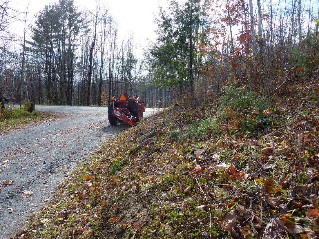

I use a 7' sickle bar with a hydraulic angle cylinder on my roadside banks. Been doing it for 12 years and it works quite well.
The tractor he has appears to be matched to a 50" cutter bar. Hardly worth the expense to cut a 4 foot swath at the bottom of the dry side of his dam.
We don't know how high his dam is but the problem comes when trying to cut from the top of the dam down either the wet or dry side as well as down any banks approaching his pond from the other sides.
Regardless of the length of the cutter bar or the tractor, if he were able to drop the outer edge of the bar down at an angle opposite of the way you illustrate yours up, in the picture, the inner shoe pivot point of the bar would be inside the outside edge of the rear tire. This means in order for the bar to drop down to the contour of the ground the right tractor wheels would be precariously over the edge of the dam top. Most earth dams with any age do not have a sharp edge where the top starts going over the sides making the problem even worse.
On other slopes to the water, in order to cut to the waters edge or drop off his tractor could still be very close to the side roll over angle in places unless the slope is very wide and gentle.
From his description of using the bushog I doubt if this is the case.
It would be nice to see some pictures of the pond.

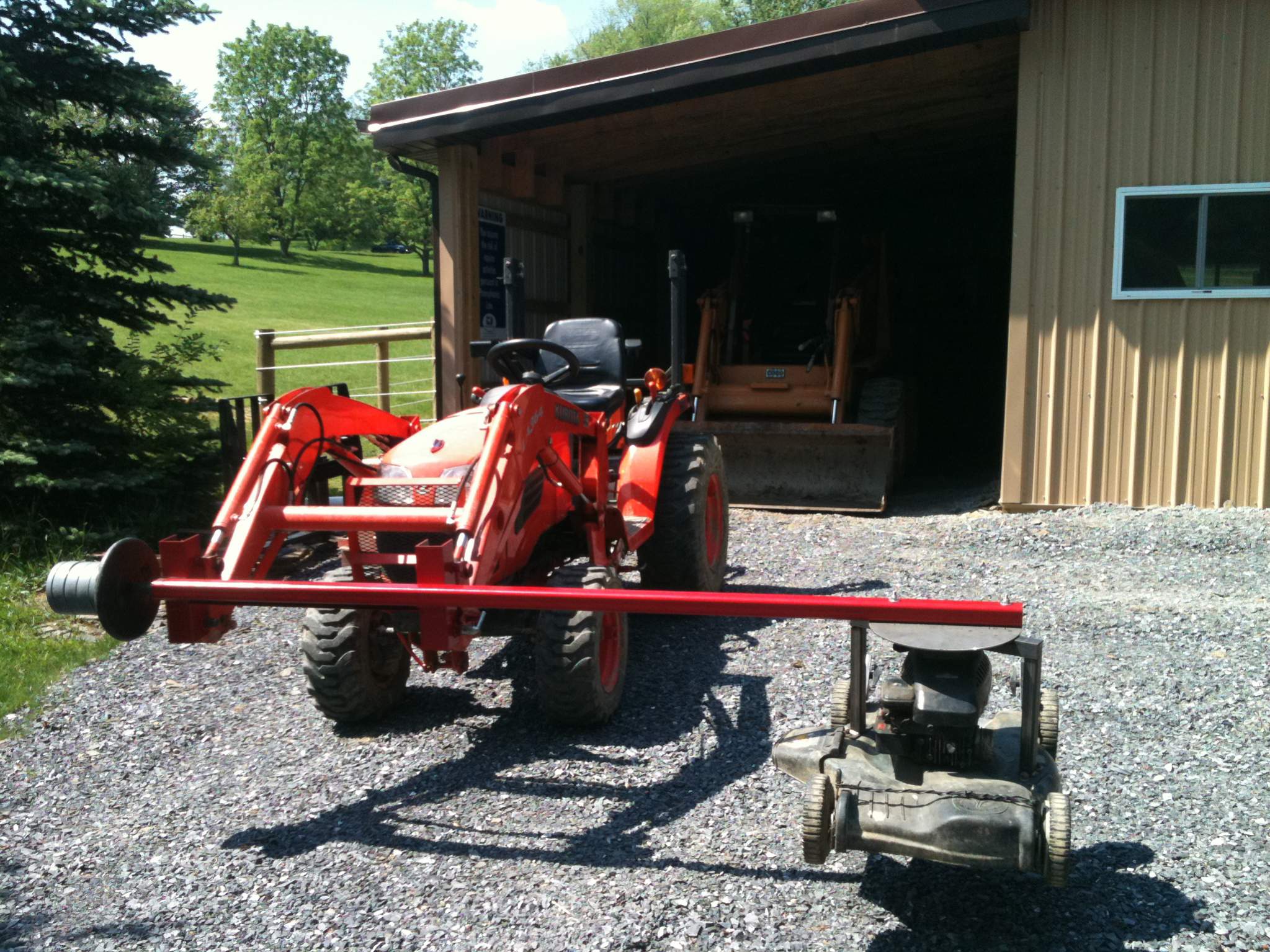

I have a pond approx 2acre and this is what i did. It's probably not the safest idea out there, but it works great, and it doesnt blow the trimmings into the water.Mower.jpg
/ Pond Edge Maintainence #36
I have a pond approx 2acre and this is what i did. It's probably not the safest idea out there, but it works great, and it doesnt blow the trimmings into the water.View attachment 271410
WOW! very simple and effective design by the looks. I wonder if you might use a hydraulic cylinder as the boom and have the ability to extend and retract a little bit? Iknow..Iknow....K.I.S.S. is the best way.
I have an old mower deck sitting around and may have to try this one. It sure beats the price of a sickle bar mower!
