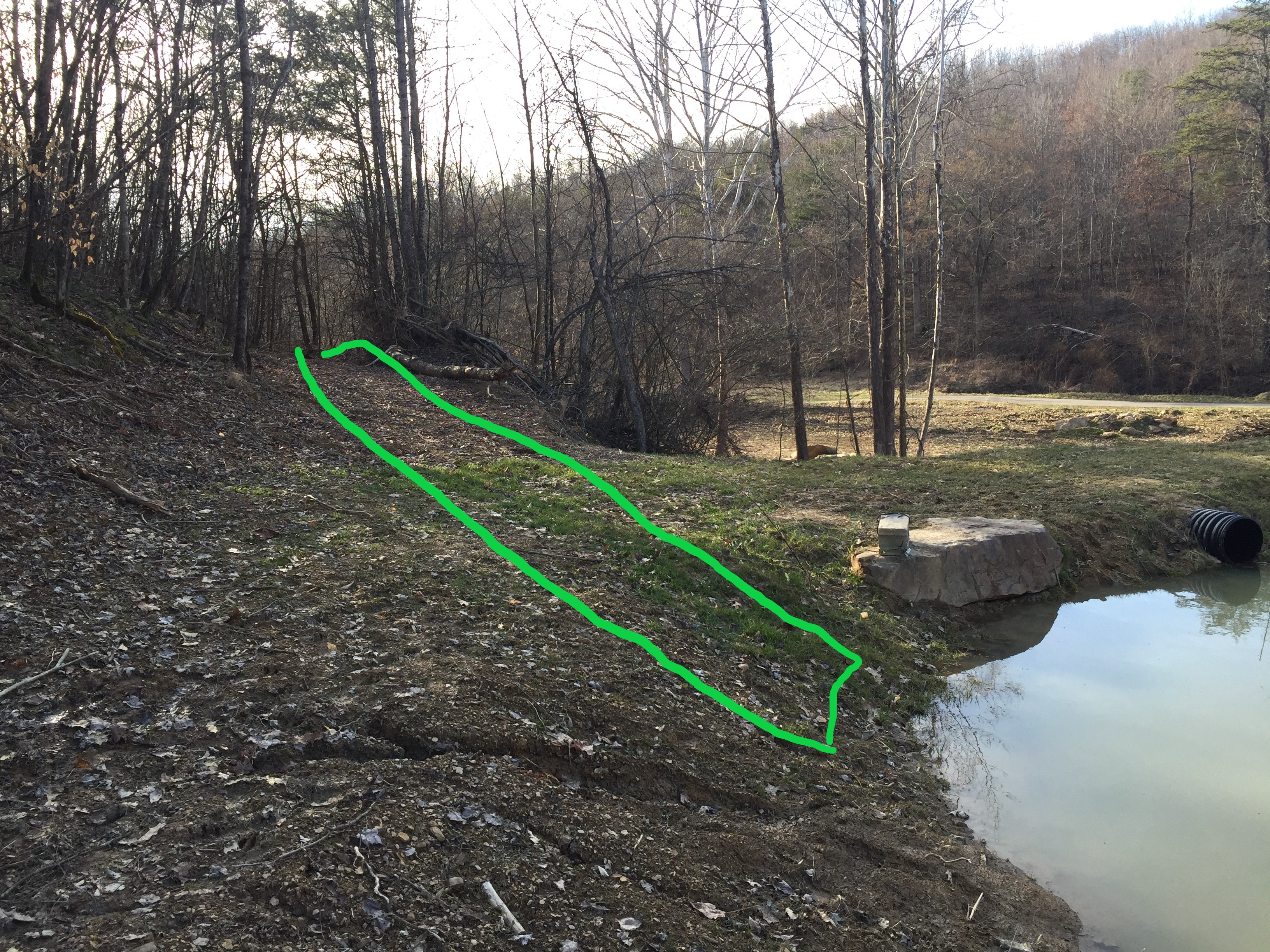

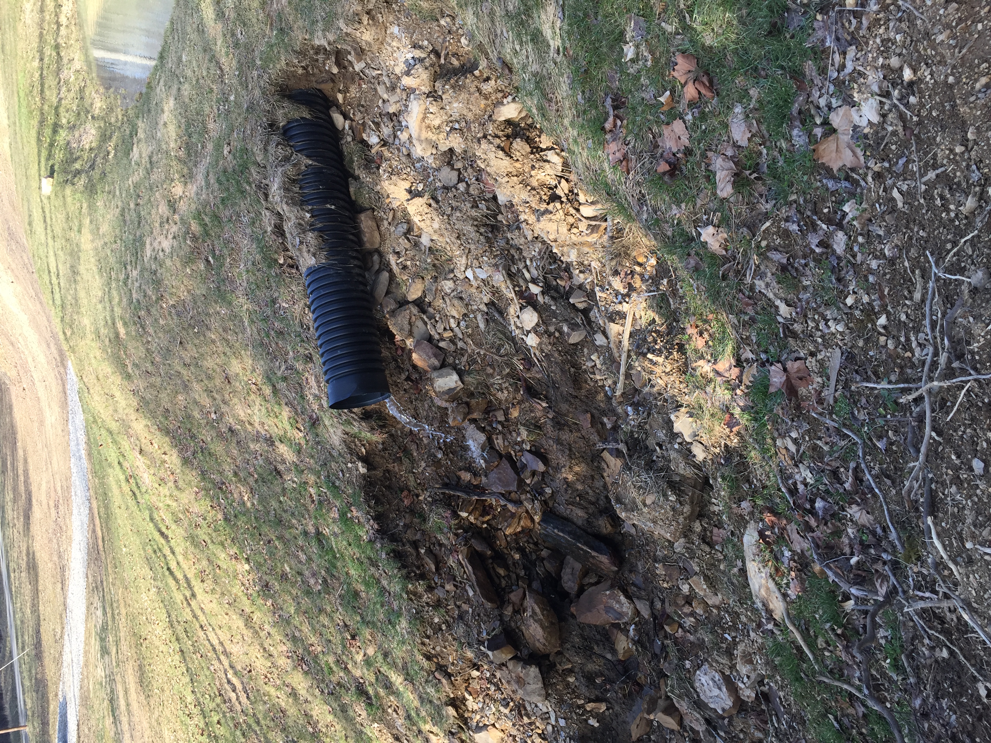

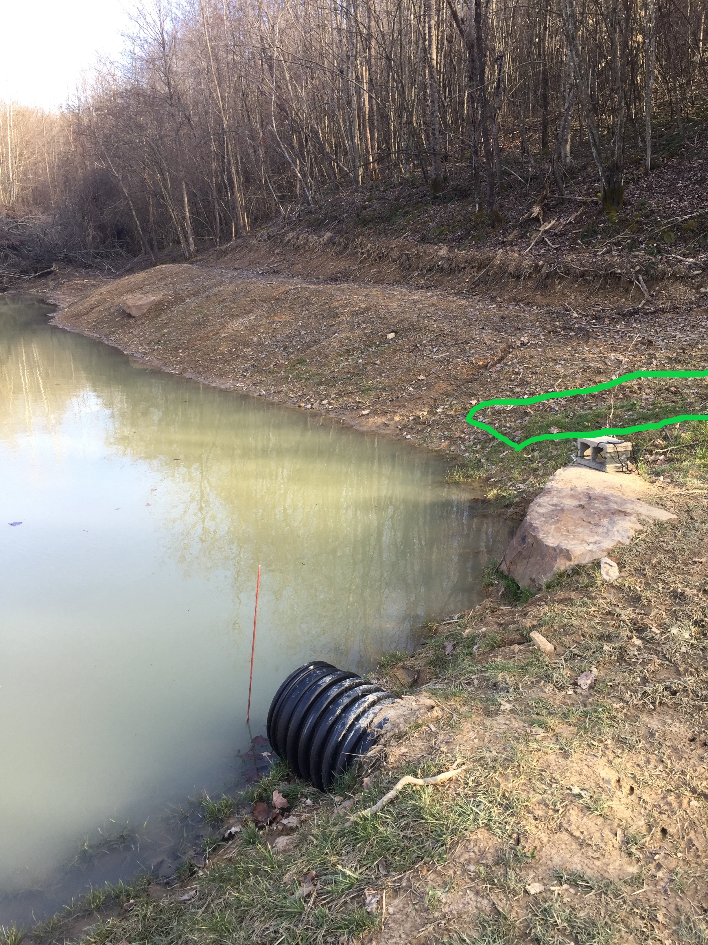

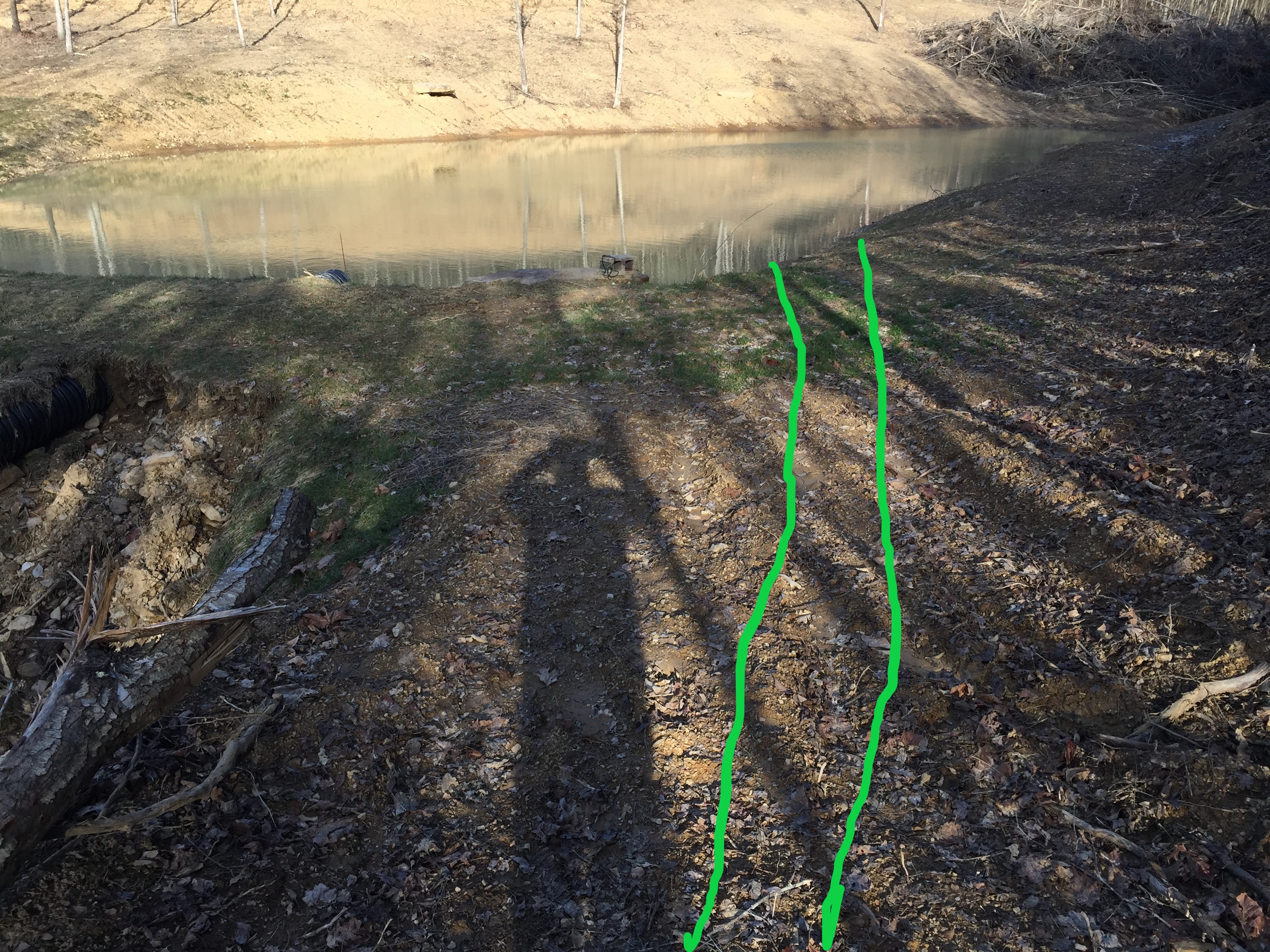

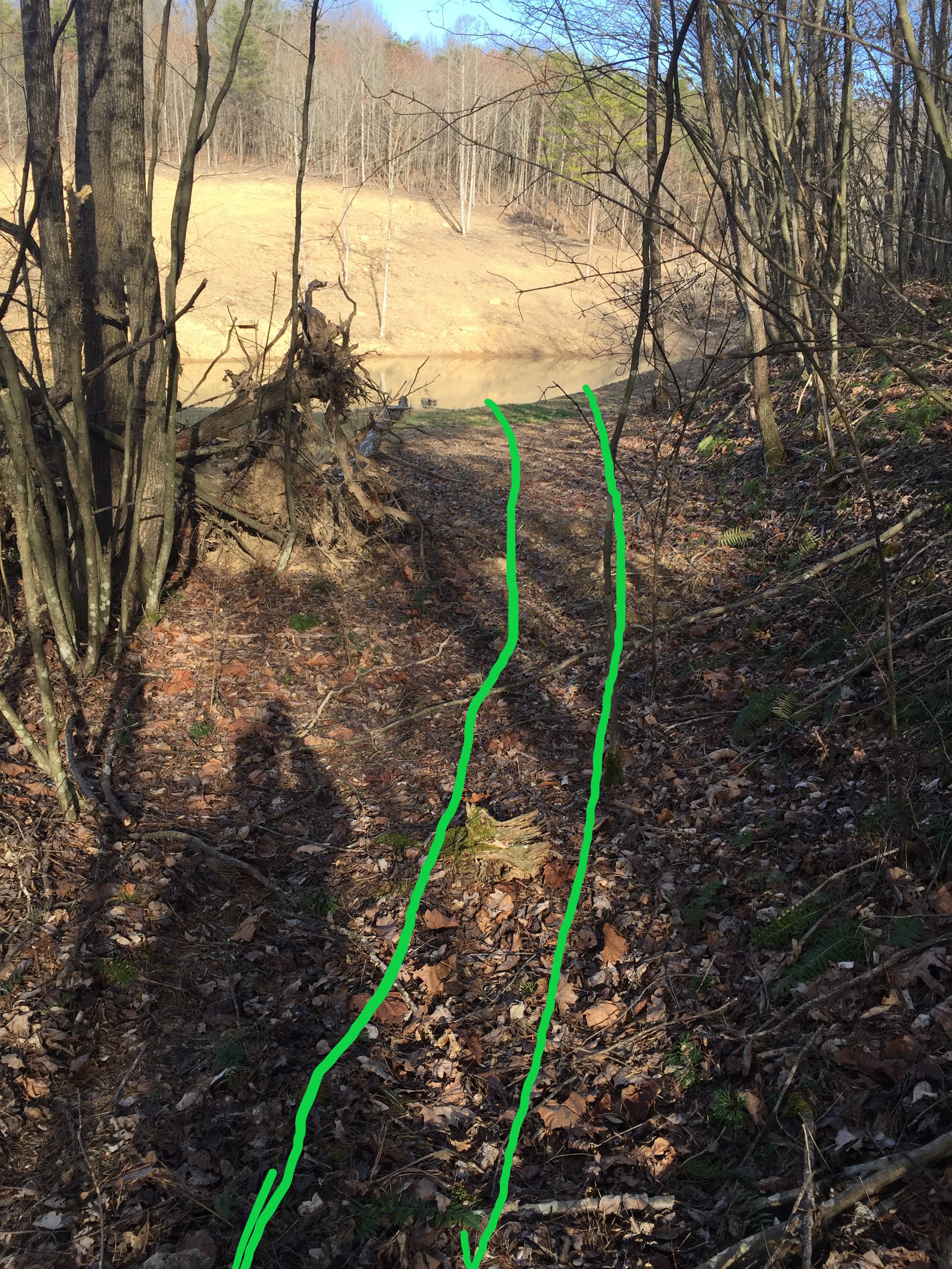

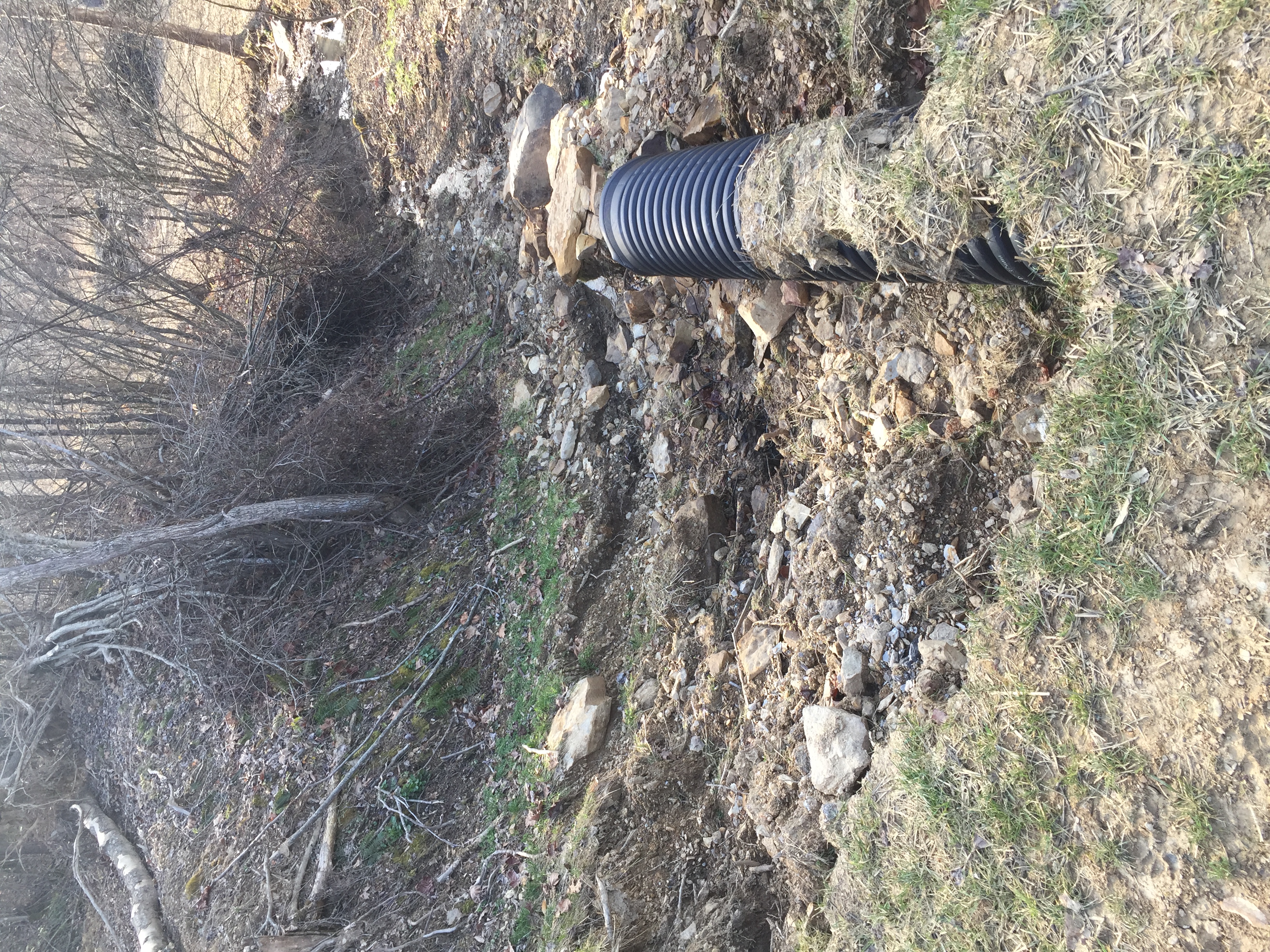

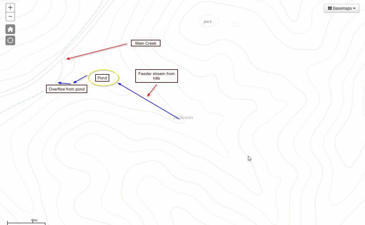

I am attaching a few pics to show the conundrum I'm in right now.... it is a new pond, just built it last summer and I obviously miscalculated the amount of water coming into it as it filled the 18 overflow pipe I have and then ran over the dam.... prior to that it had already ate the overflow side of the dam up pretty good even though I had placed a LOT of large rocks on the dam. What I am planning on doing right now is to pump the pond down and then create an emergency spillway on the left of the spillway pipe as you look from the pond side. I believe this is an old logging road cut into the hillside probably 15-20 years ago so it should be solid. I was planning on just digging it out with my Kioti backhoe and FEL. I know I don稚 have much freeboard and I am planning on building the dam up some over the current pipe with the excess dirt I take out for the spillway. Although some of the dirt will also be used to fix the dam on the overflow side where it is washed out. I would like some ideas as to if this is the best way to do it without spending a fortune. I am going to create a concrete and rock tailrace under the overflow pipe as well to keep it from eating away the dam on the overflow side.

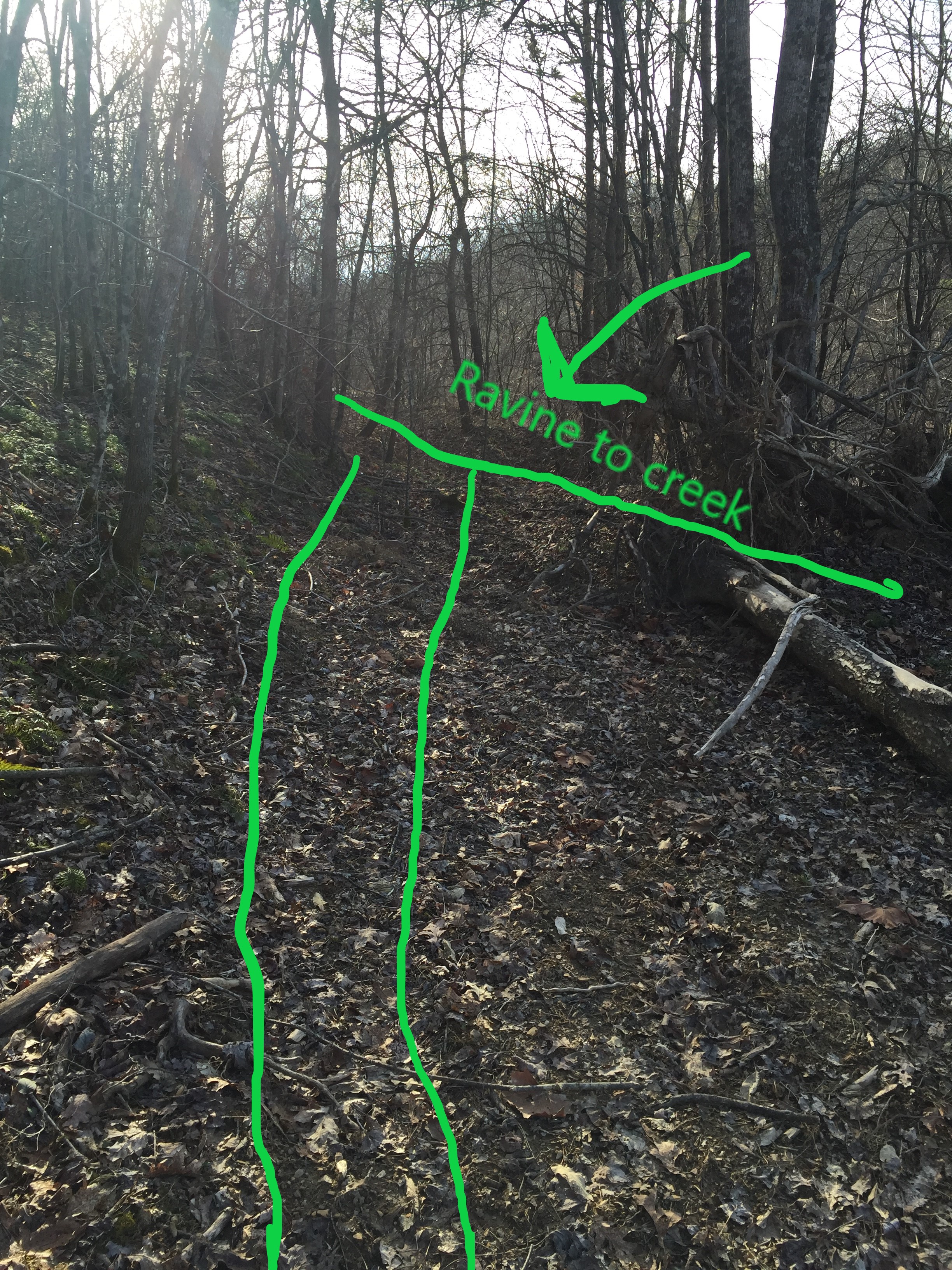

The way I see it right now I have possibly 3 options, as listed below:
1) Dig out an emergency spillway on the area marked in the pic. It is probably about 75' to the ravine from the pond that I would need to dig out.
2) Remove the existing 18" overflow and create a concrete spillway wider that goes over the dam where the pipe was and forget the emergency spillway. Pond1.jpegPond3.jpegPond4.jpegPond6 - Copy.jpegPond7.jpegPond2.jpegPond8 - Copy.jpeg
3) Remove the 18" overflow pipe and replace it with a larger 24" - 30" pipe.
Any other ideas or which of these sounds the best? Thanks!

It looks like a case of too much watershed for the pond size, but that could be helped by an adequate emergency spillway lined with concrete.

You are asking questions that would best be answered by a hydraulics engineer who is on-site at your pond. Any way you look at it, answering this situation is going to be quite a bit of money. Do yourself a favor and seek local professional assistance.
/ Pond Issue.... #4
if you've got that much water coming into the pond then it sounds to me that it won't be an "emergency" spillway but rather a "continuous" spillway.......so the question becomes is that really where you want the water flowing all the time and are you prepared for the erosion it will cause.......I suspect the logging road will look like the pic you have at the overflow pipe in short time......I agree with oosik.....time to get some local professionals in........Jack
Well, no, it wouldn't be using the emergency spillway all the time.... normally 90-95% of the time the overflow has handled the amount of water just fine, other than needing a concrete tailrace. However, we just went on record as having the wettest February ever recorded... so this was unusual for our area/timeframe.

If it overfilled with an 18" overfill pipe enough to top the dam, then you need a larger overfill pipe for starters. You had no emergency spillway, either. There should always be an emergency spillway. You're putting one in, but what do you know about sizing it? And the overflow pipe, too, for that matter. As others have mentioned, best to consult an expert, especially if there's anyone else's property downstream that could be impacted if your dam breaches.

Do you have the option to put the spillway on the other end wa
Where the water is coming from. That would solve 2 issues, one water level controll and you could remove your over flow pipe. That’s how I controll my pond. High side inlet creates consitant water level and prevents lower dam washouts. If that’s not possible eliminate the pipe and do a wide and long spillway with integral creek bed
Where the water is coming from. That would solve 2 issues, one water level controll and you could remove your over flow pipe. That痴 how I controll my pond. High side inlet creates consitant water level and prevents lower dam washouts. If that痴 not possible eliminate the pipe and do a wide and long spillway with integral creek bed
Phil, I wish... but I do not see anyway since it is all higher elevation... see attached below:
/ Pond Issue.... #18
Can you give us a google earth image? Your spillway will work as you have it in the pictures just make sure it is wide and a slope of 1/8” per foot. Water needs to move over it but not fast. Make sure to grow grass to help eliminate washout. I’m a fan of natural drainage not pipes. Put a small creek bed in the spillway and get rid of that pipe. Looks to me like you could raise the water level another 18”.
Just my thoughts
Phil
Phil, I like that idea as well. So, let me make sure I understand what you’re saying. So the emergency spillway that I have highlighted is that what you are saying should be 1/8 in drop per ft? And I had already planned to immediately sow it it with perineal rye grass and fescue. But you also mention removing the pipe and making a spillway there also over the dam in its place? That’s a much steeper drop and I see no way to make a slow descent. I was just going to make a concrete and rock tail race under the pipe. Or are you saying just remove the pipe and build up the dam in its place and then use what I call the emergency spillway as the sole outlet for the pond? If so I would assume it needs to be at least 10’ wide, plus b/c of the lack of freeboard I have it could be close to 2-3 ft deep by the time it reaches the ravine that I plan on running it to.
