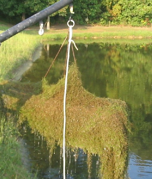

Here is a close up of the weeds and thanks for all of you alls help, thoughts, suggestions and comments.

Holly weeds Stray, I wish I could load them right into a trailer like that. I'm stuck using a pitch fork to get them into the trailer. If you garden they make great mulch between rows of plants. Don't do what I did one time, I left them on the trailer for a couple days. It smelled worse than any manure I've ever come across.
Great weed rake too, I like the rebar tines, great job. Thanks for the pictures.

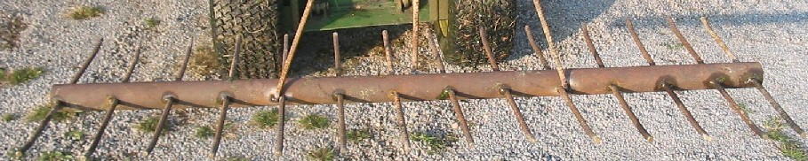

Here is a pic of the pond rake before it goes into action.

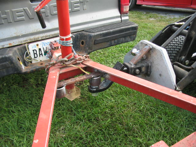

Here is a pic of the knuckle. You just let the rake fold out on the ground or pond bottom as to take the pressure off the slide catch, pull the rope that runs through the pipe(connected to the slide catch) and lift or lower and pull and let off the rope. I hope this makes since.
