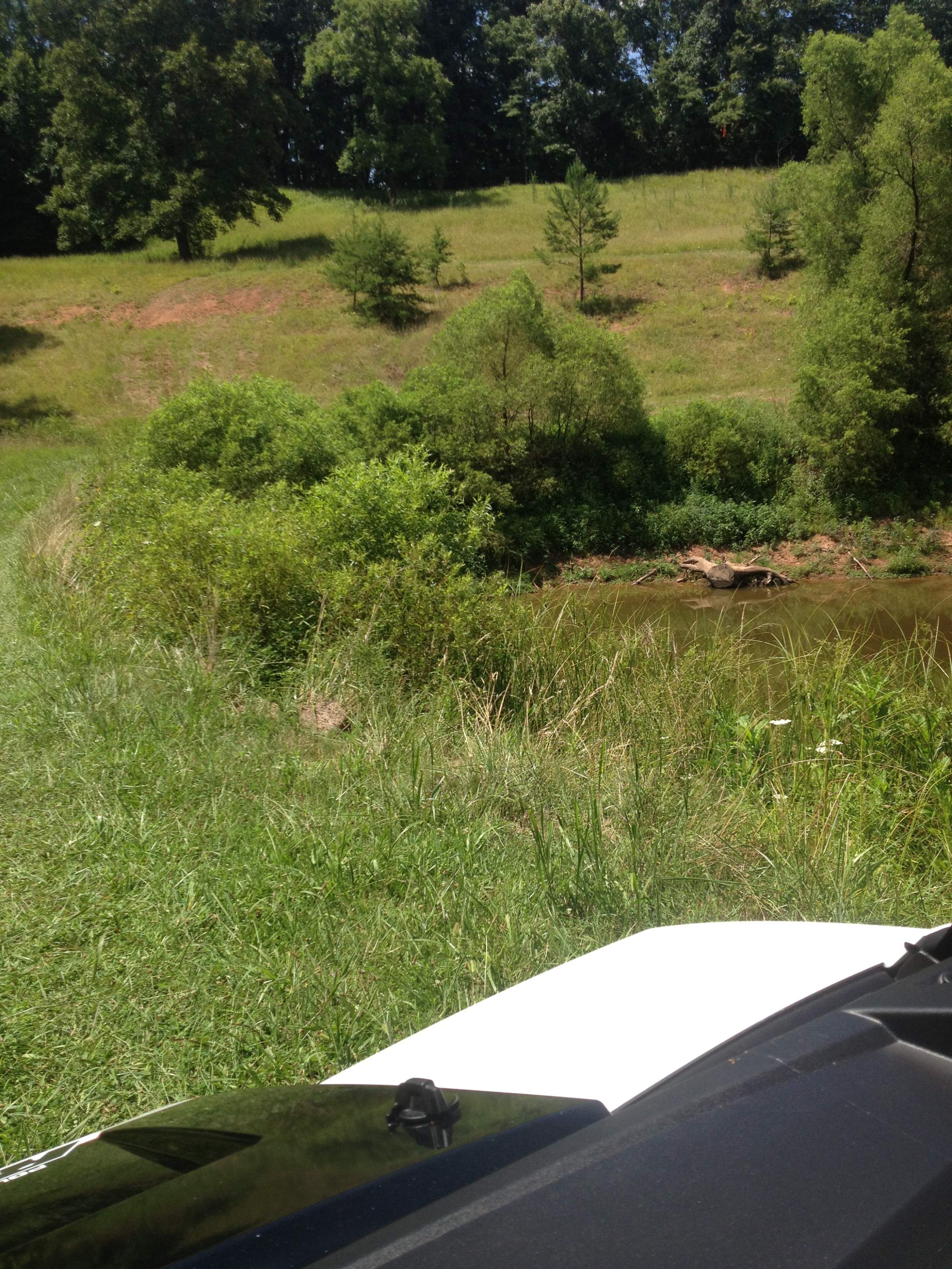

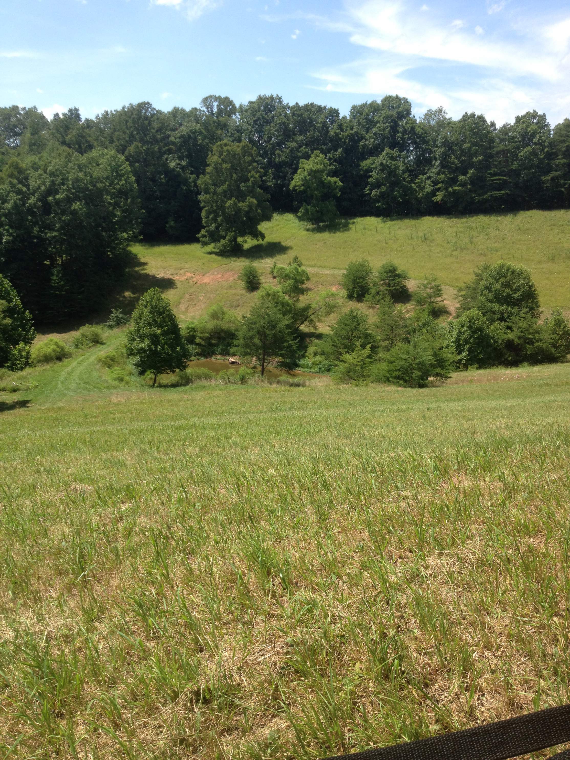

The attached photo's show the pond before any draining started.

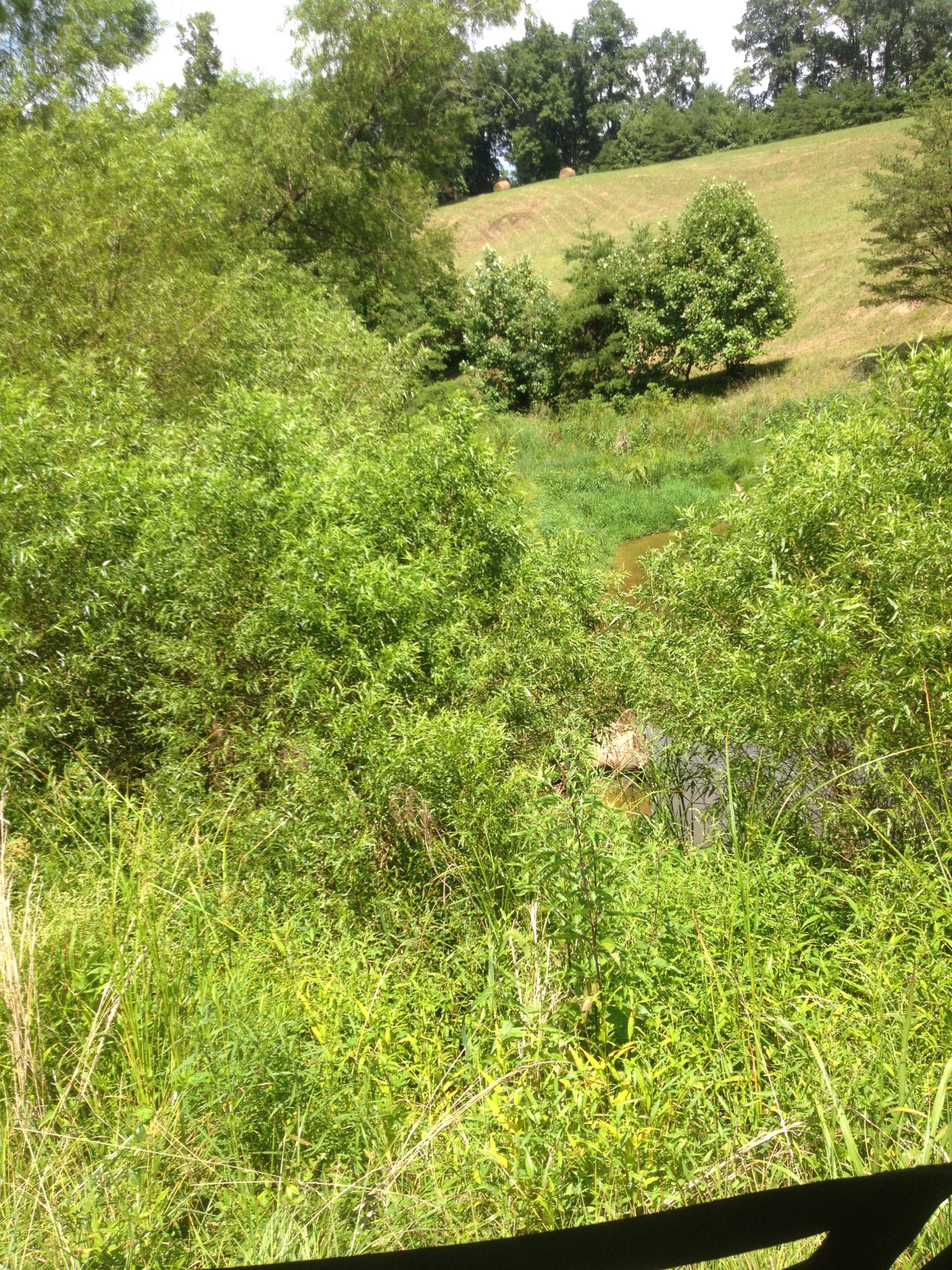

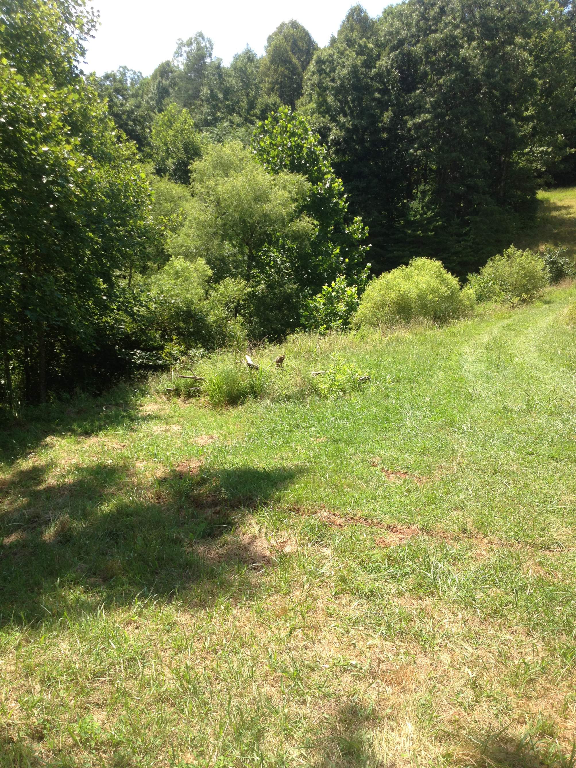

Here is the back of the dam.
Its hard to believe from the pictures, but I use to keep this pond nice and mowed/weedeated, and had begun taking some of the trees out. Once I realized it was leaking and I needed a dozer/excavator in to repair, I kind of let it go. Hopefully it will turn out nice and I can keep it clean again. We really enjoy having a place to fish, and our future hom will be built at the top of the hill behind it, so its time to ge it looking good again.

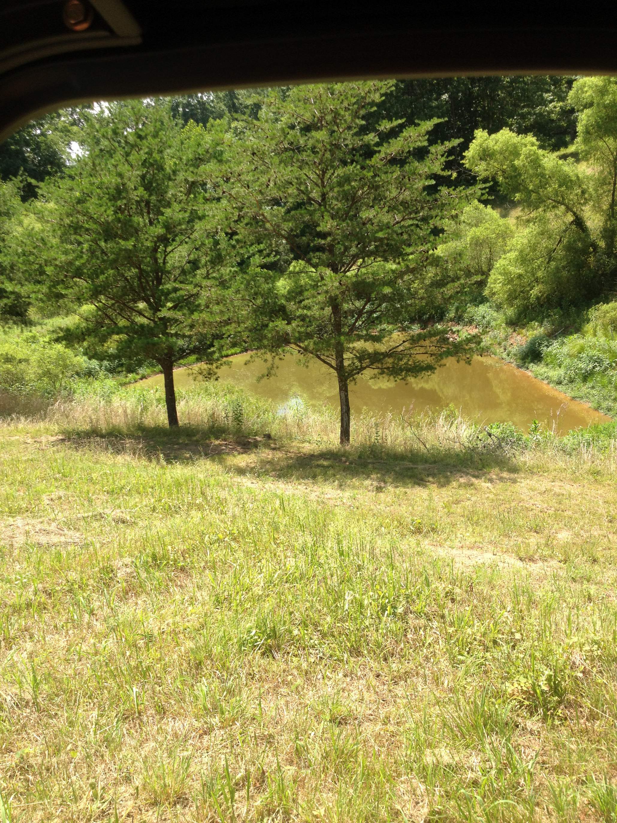

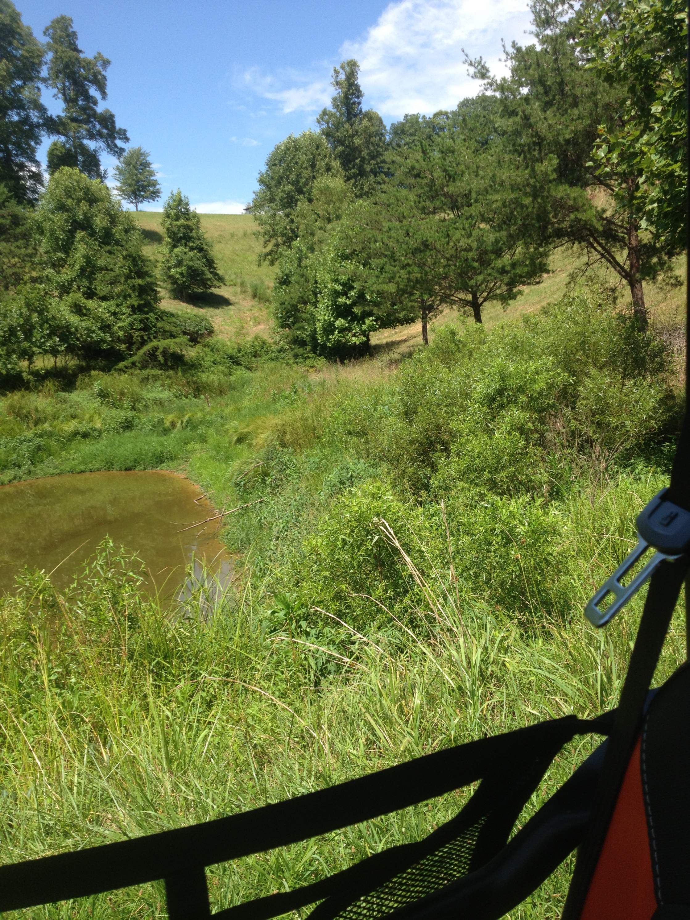

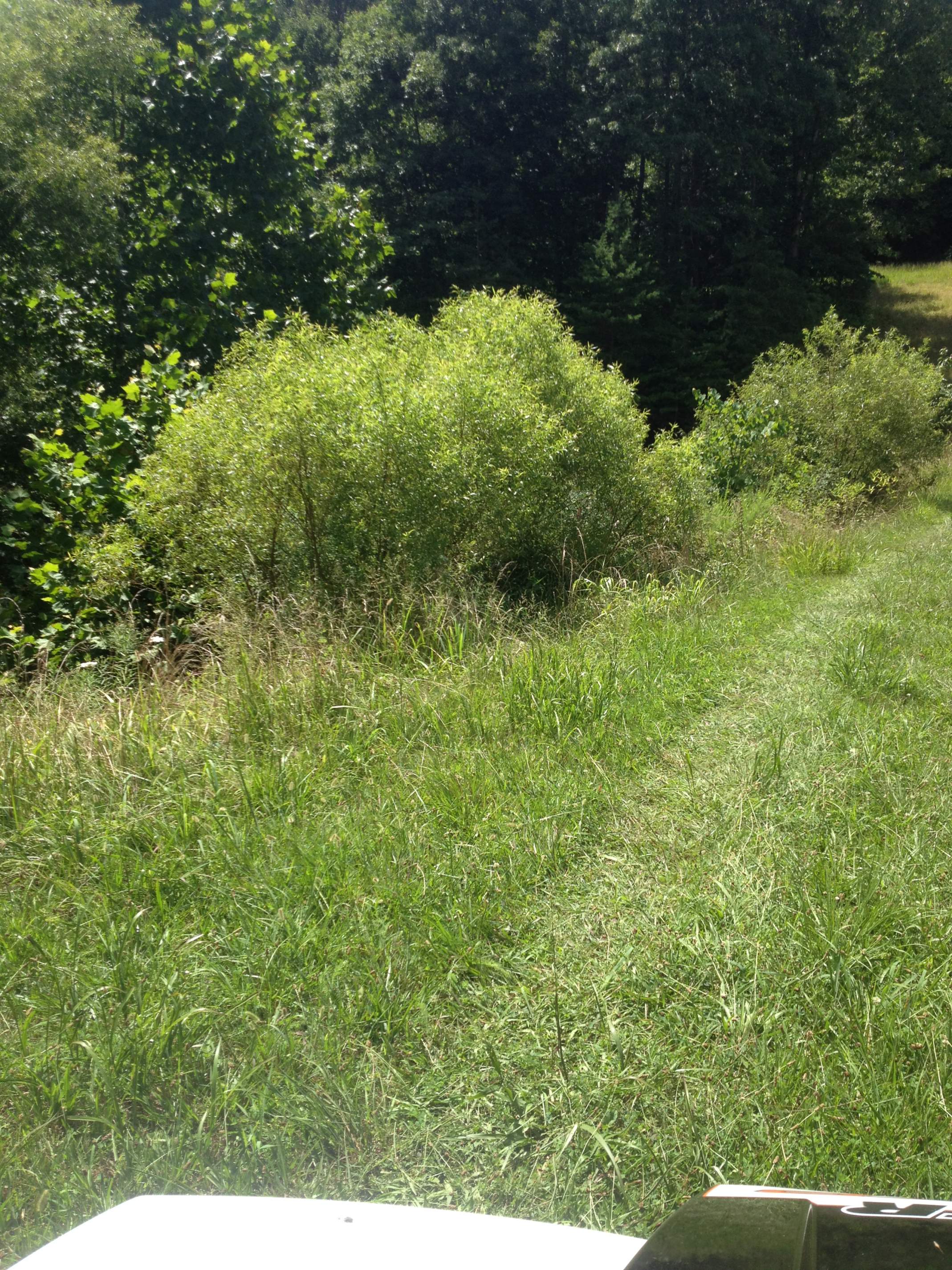

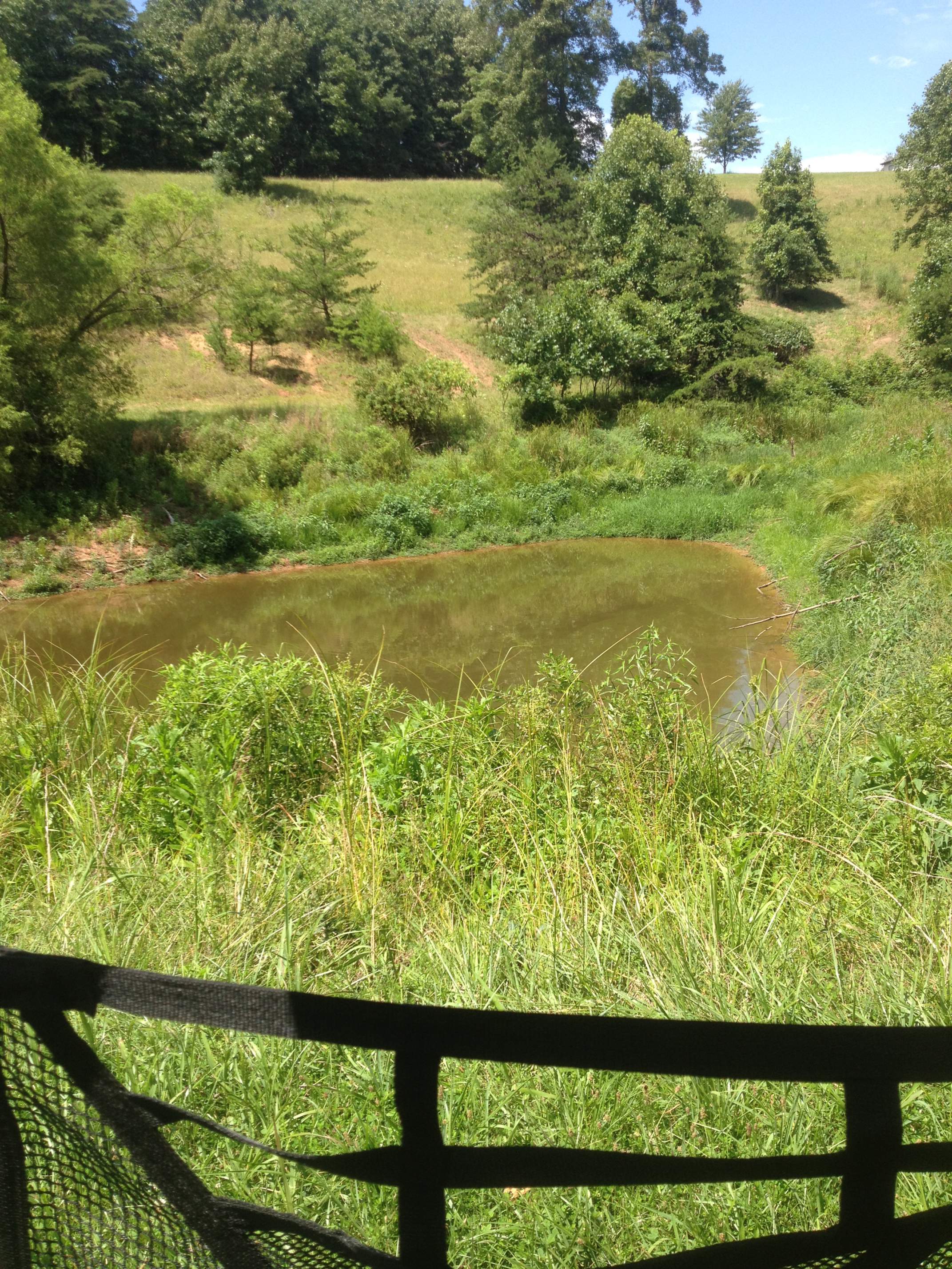

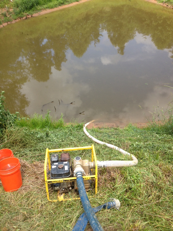

I like your siphon idea! There isn't much water left now, so I think a buddy is going to bring home an electric pump from work if he can. I'll run it on my generator. If he can't get it, I may try the siphon setup. The reason I didn't get it all pumped out with the 3" pump was because the longest intake hose I could get was 20'. That just won't reach the bottom from solid ground. I had planned on using waders and getting down in the pond to bet the fish. Well one step told me that wasn't going to work. I like to never got out! New plan is to borrow a jon boat. I'll push it out across the muck and net the fish, hopefully this will work. I can also float the pump out into the water with the boat. Once all the water is out, I can pull the boat out with my Ranger or tractor. Problem is, they are calling for rain this weekend, so I'm not sure I'll be able to work o it. Here are pictures of pumping the water out. The water is much lower now, but I keep forgetting to take my phone down with me.

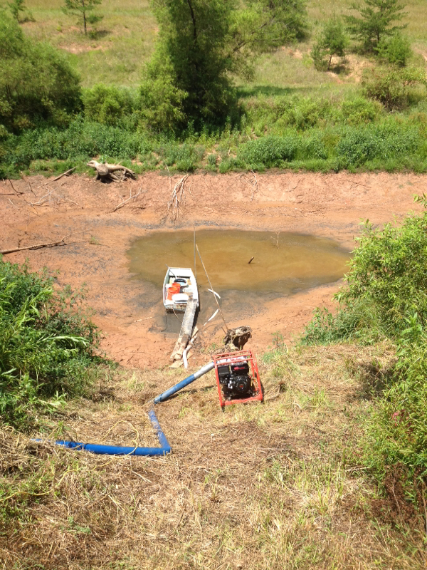

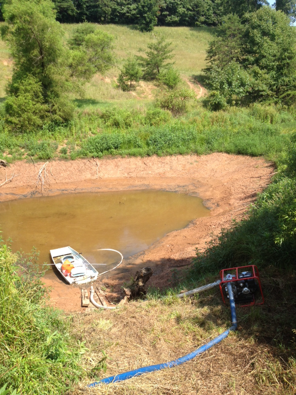

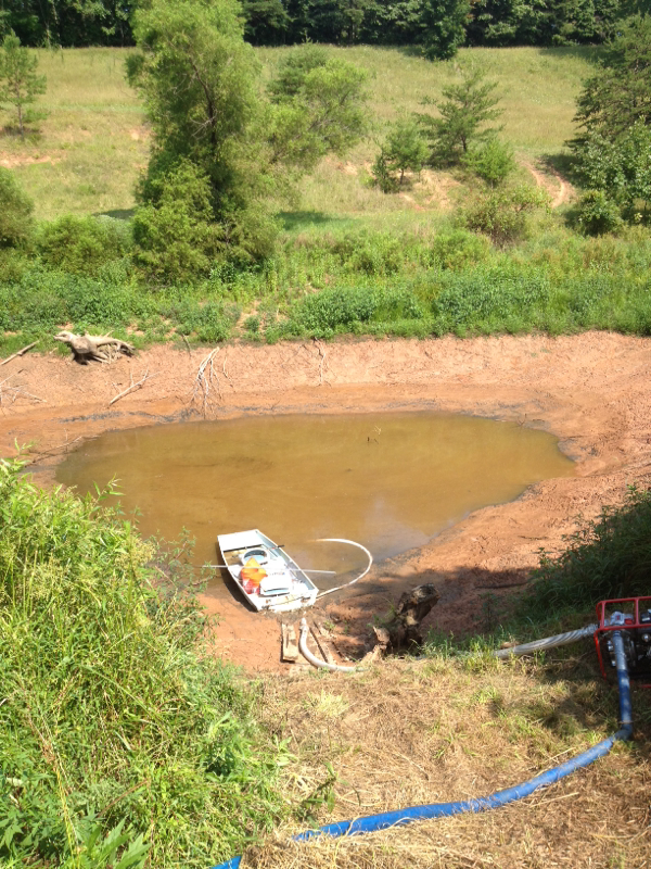

Haven't made a lot of progress to date, but did rent a pump again this weekend and got all the water out that could be pumped. Once I gat down to the last little bit, the water became very thick and the pump just wouldn't pump any more. The pump they gave me this time was a brand new honda pump, never even started before. The last one was a whacker. The honda had nothing on the whacker. That whacker pushed the water out with much more force, and undoubtedly would have pumped the thick stuff out.
Good thing is, we managed to net out around 80 or so fish and successfully move them to a neighbors pond. Mostly bluegill but a few smaller bass as well. Not sure where the bigger bass we have been catching went, but suspect a turtle or crane must have pick them off as the water got low. Didn't find any turtles when getting the fish, but did see one a couple evenings ago feasting on a couple of fish that were missed. I'll carry a rifle with me from now in and take care of him if he shows his face again.
Of course, it has rained on and off all day yesterday and a chance of rain is now in the forecast everyday this week and weekend.
The contractor that I plan to use came out Saturday once the pond was empty, and looked it over. He said it was much deeper than he would have expected and is now worried that he will not be able to pull the muck out from the top with the excavator. Of course this is concerning because, having to move it twice will be very costly and completely blow my budget, and his original quote, for this project. If it can dry out enough, we can still complete within budget, since dry dirt us easier to move than mud.
Plan now is to wait out the rain and hope we get enough dry weather to get this done this year. If we get a clear forecast, I'm sure I'll be pumping a few feet of water out again.
Pictures of progress below. Of course I forgot to get a picture of it after finishing.
