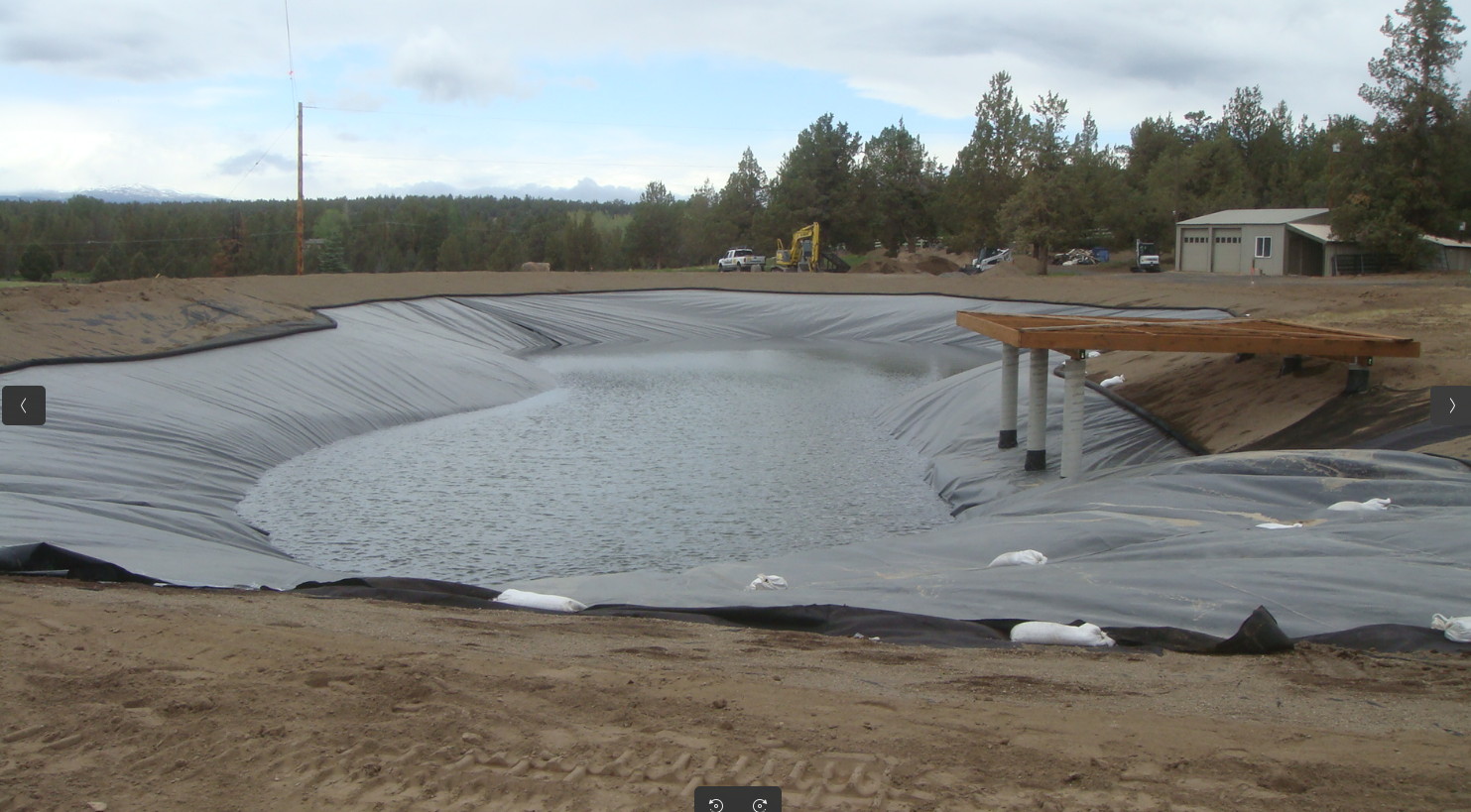

The liner for my 1 acre pond cost like $20K in 2014. Wouldn't want to re-do the project this day and age...
