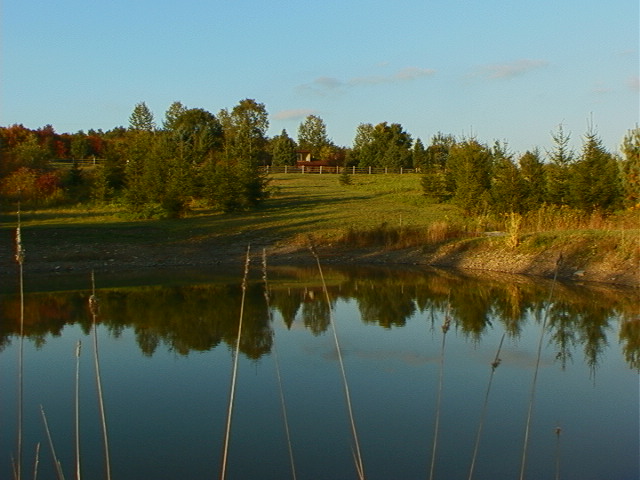

Just remembered I took some photos the other day. Fortunately (or unfortunately!?) no scum is visable in this shot. Our house is kinda visable in the background.

That sure is a pretty place you have there!
Yes, if you can keep the geese away, you should be in good shape.
